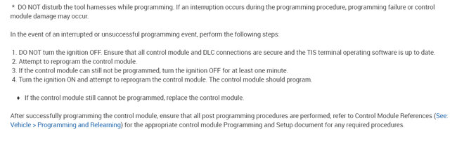

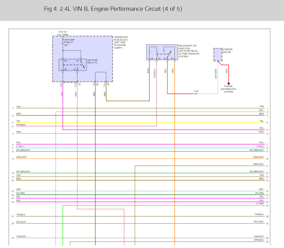

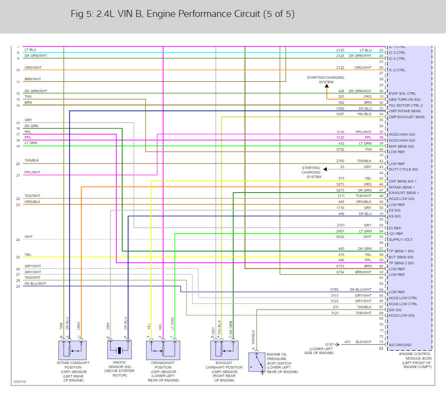

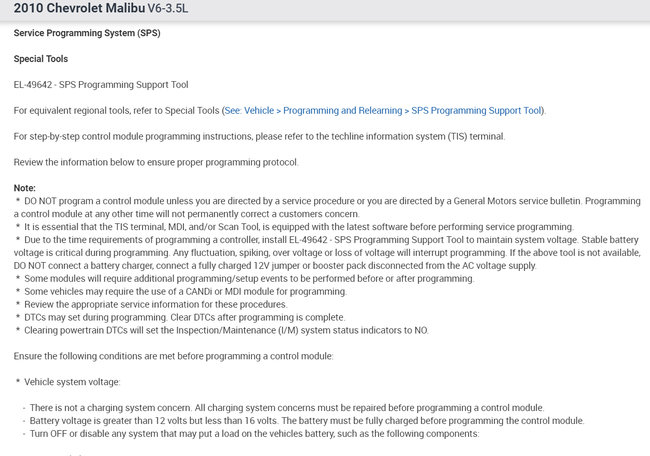

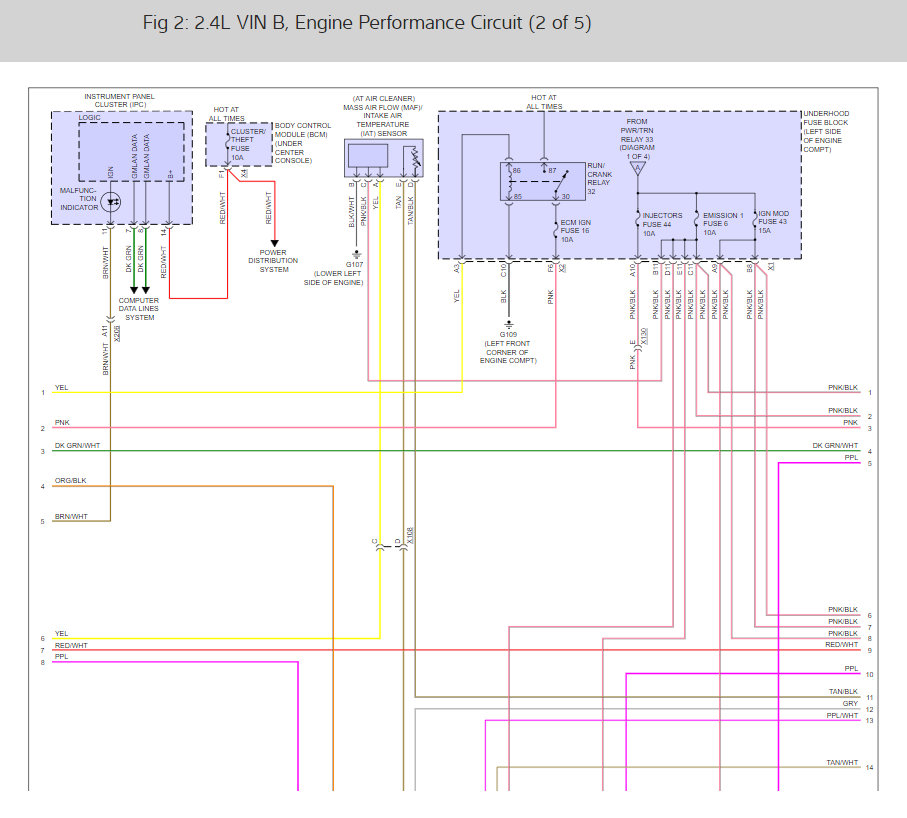

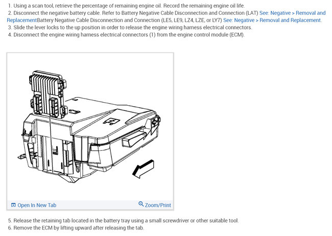

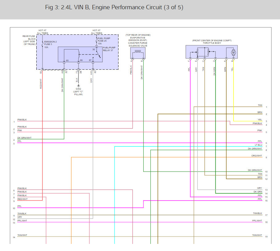

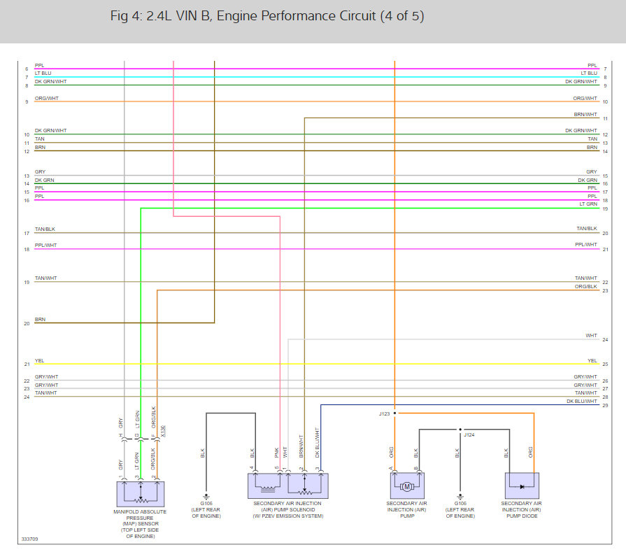

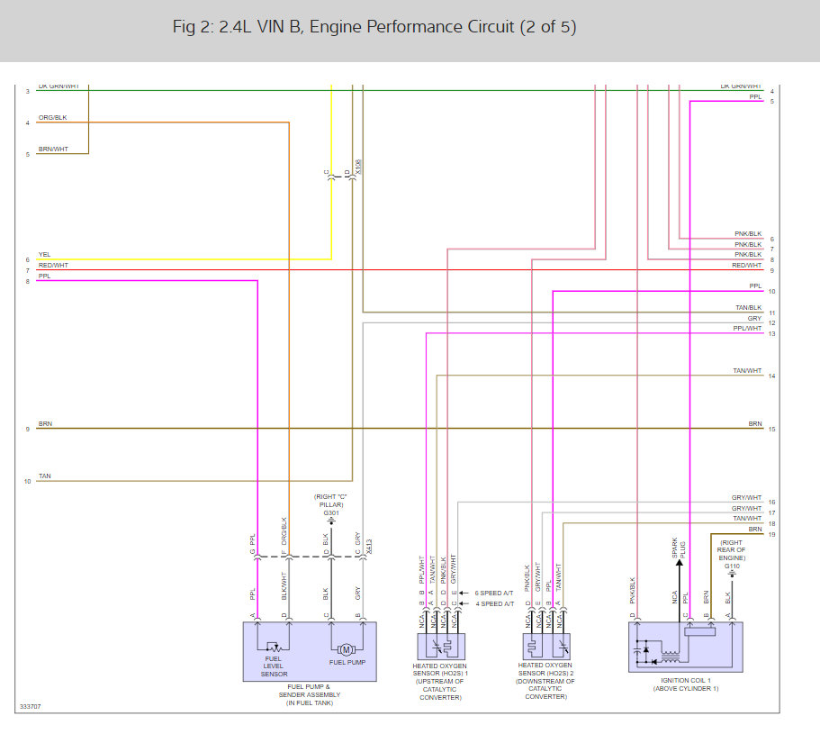

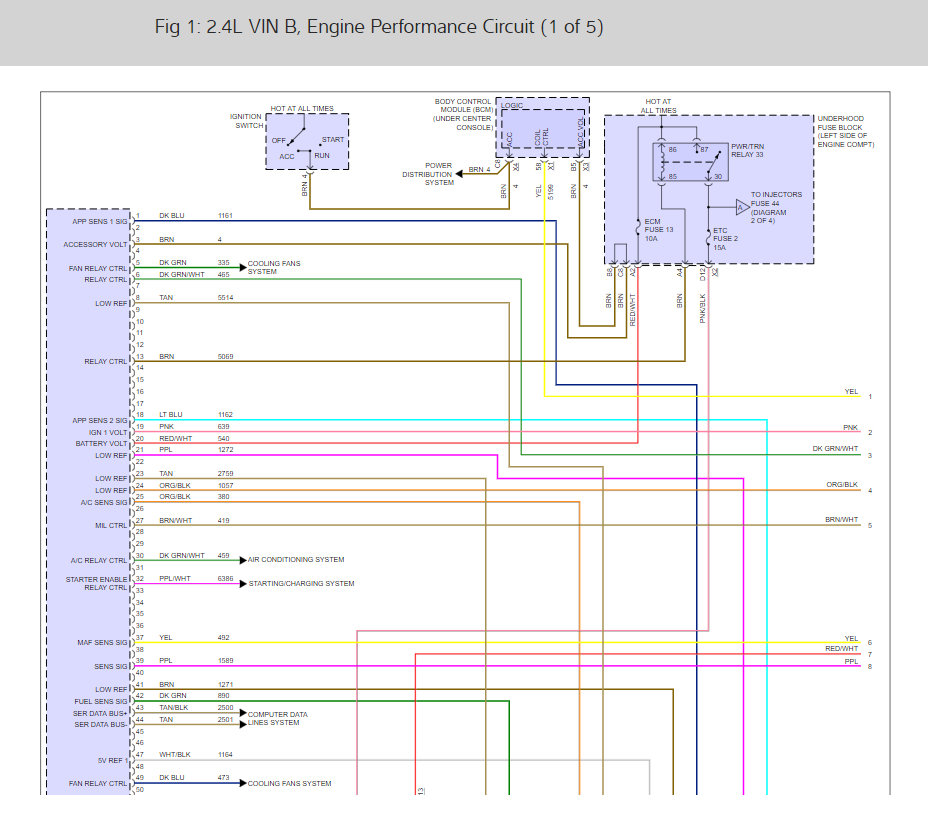

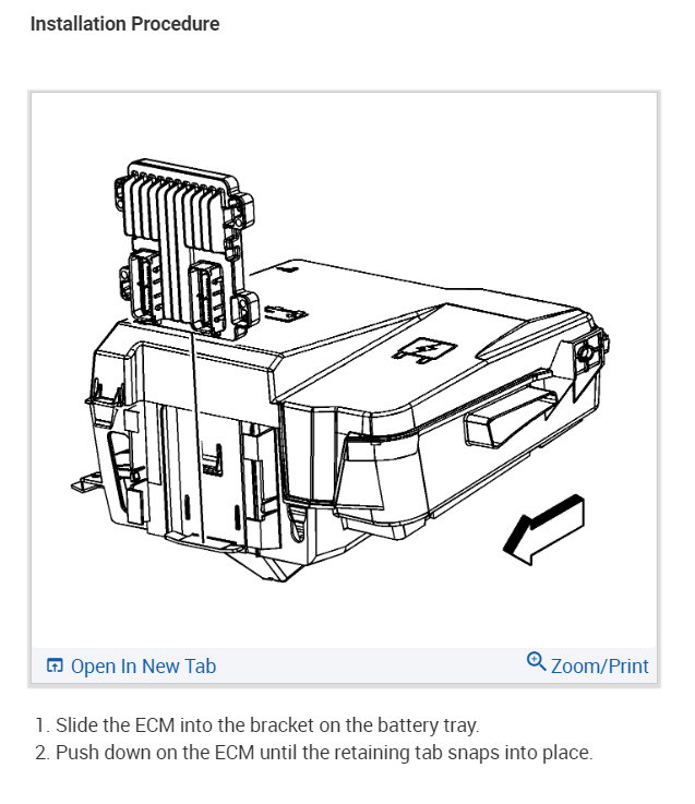

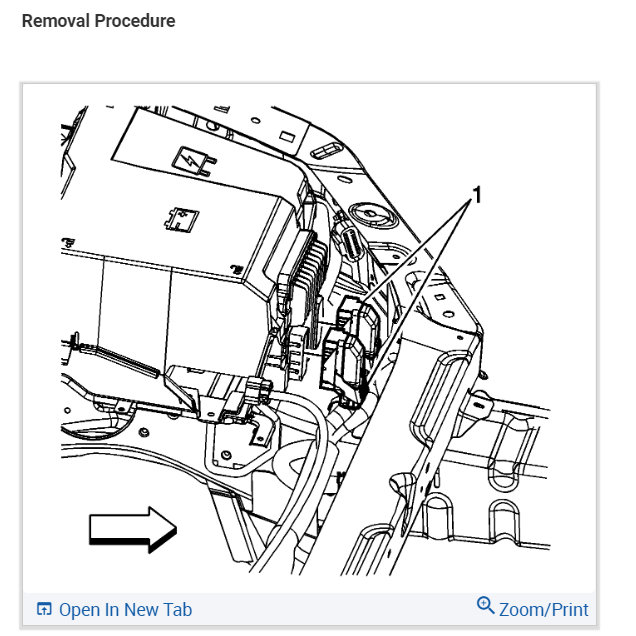

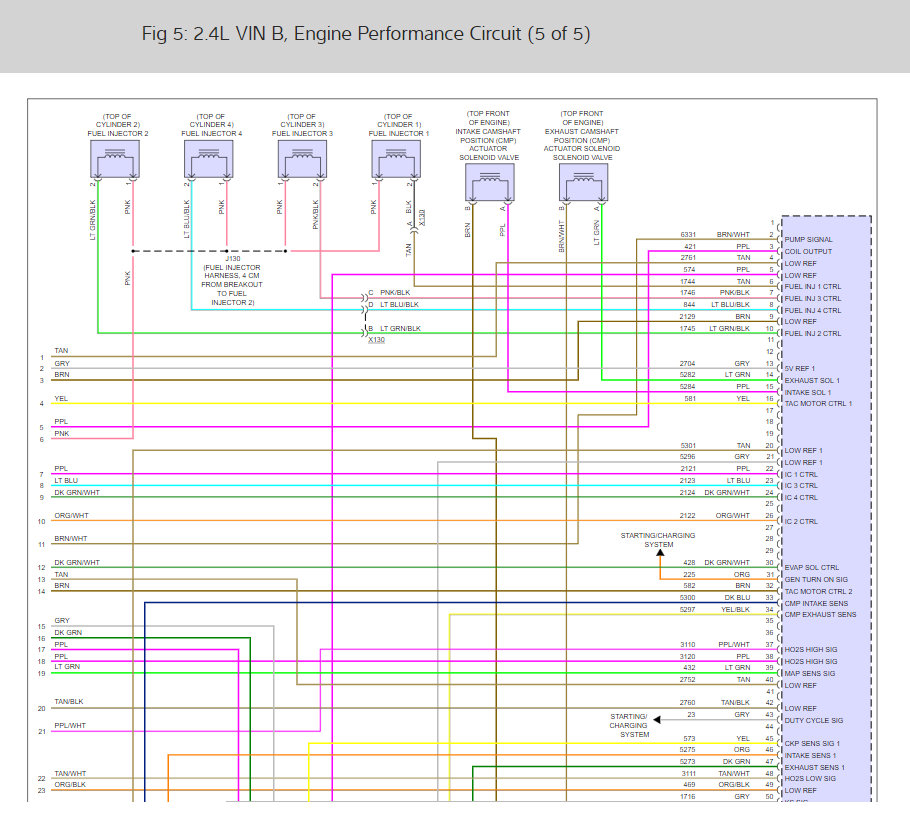

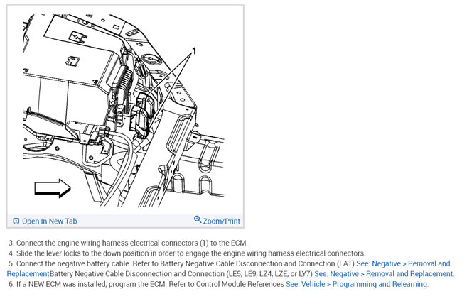

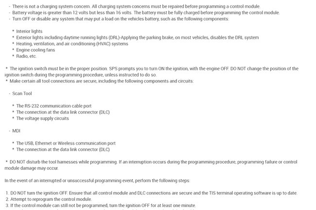

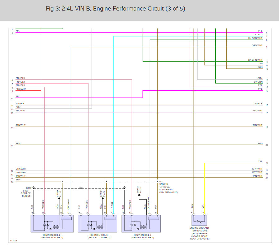

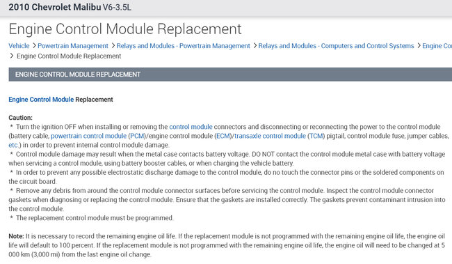

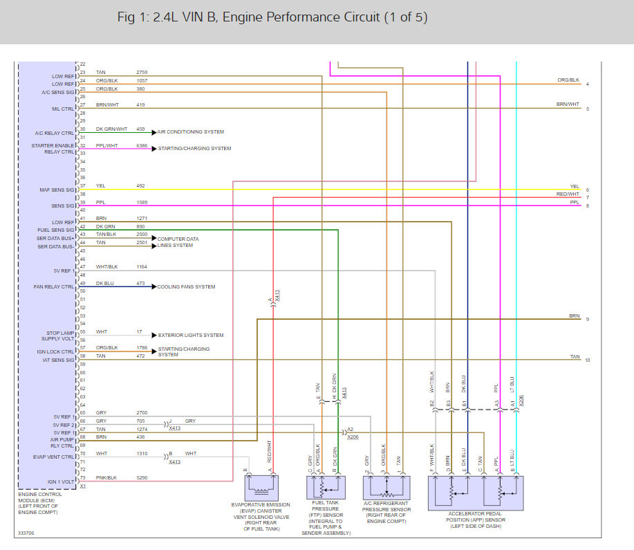

Yep, as soon as you mention that you replaced the throttle pedal position sensor and the throttle body the only thing left is a bad connection or the PCM. so we can go over the wiring by using this guide and the engine wiring diagrams below. If it checks out lets replace the PCM directions are below as well.
I would check the resistance to ground as well. Check out the diagrams (below). Please let us know what you find. We are interested to see what it is.
