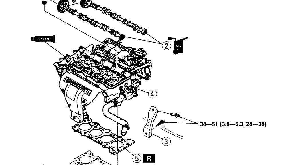

Good morning,
When you go to a parts store, tell them you need a complete gasket kit for your engine.
You will need the new head bolts as well.

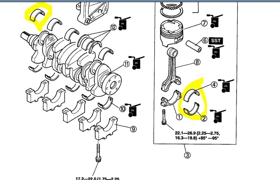

As far as additional work, have him check the main and rod bearings for damage from the coolant in the oil. Coolant will destroy the babbit in the bearings. That will make your car keep running for years.
