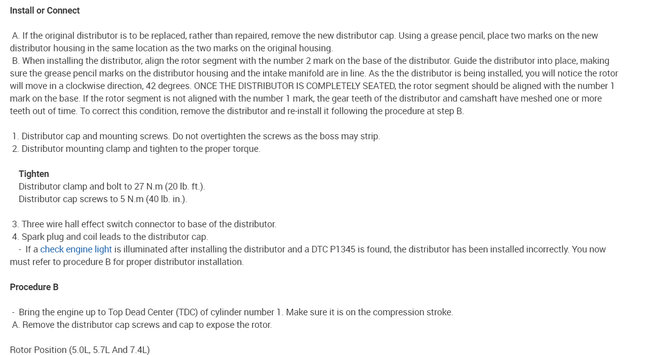

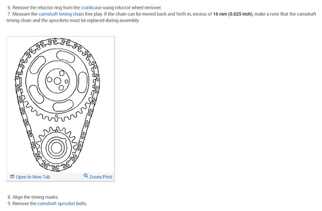

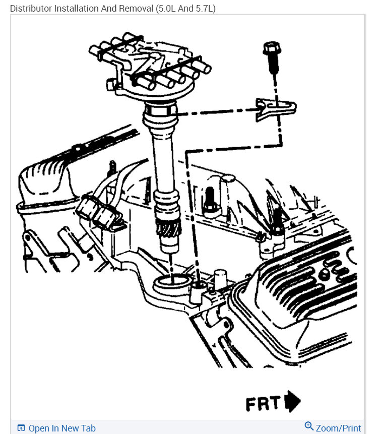

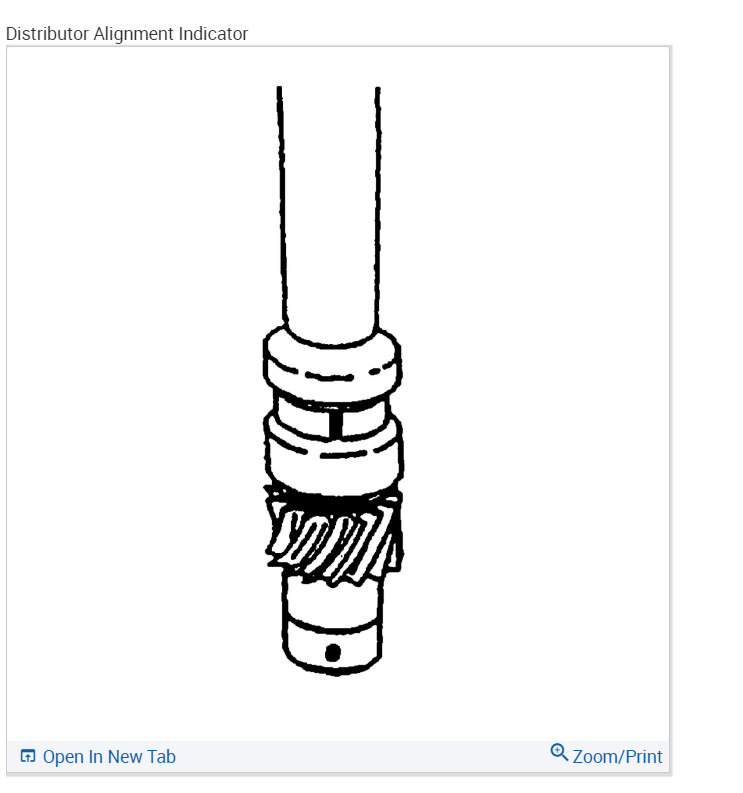

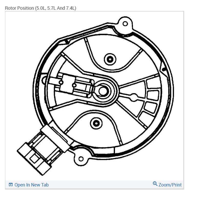

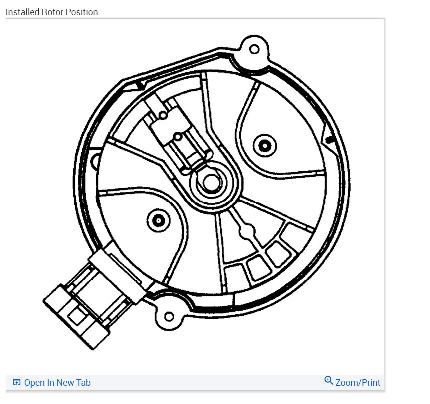

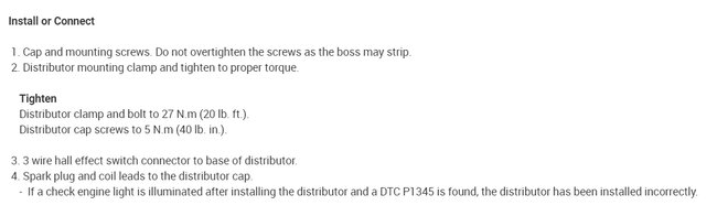

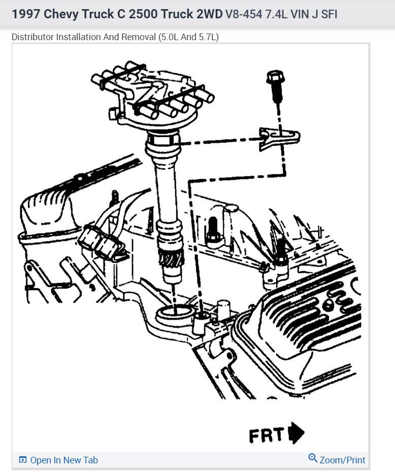

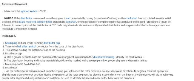

First here are the timing marks for the camshaft to make sure you have the engine in time. Also here is how the distributor needs to be installed and I have included a guide that may help as well.
https://www.2carpros.com/articles/car-not-running-advanced
Check out the images (below). Let us know what happens and please upload pictures or videos of the problem so we can see what's going on.
