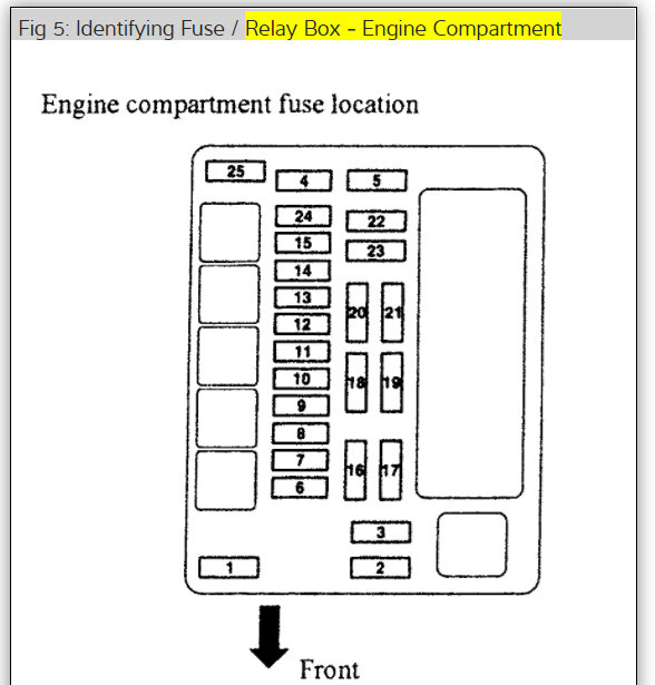

What is the location of the fuse for 12V power outlet in the center console-mail? What is it labelled as?
Oct 23, 2019 at 6:09 AM

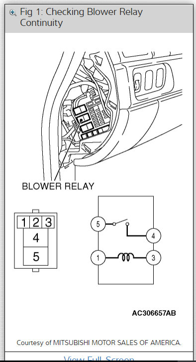

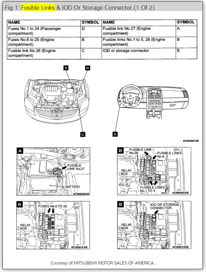

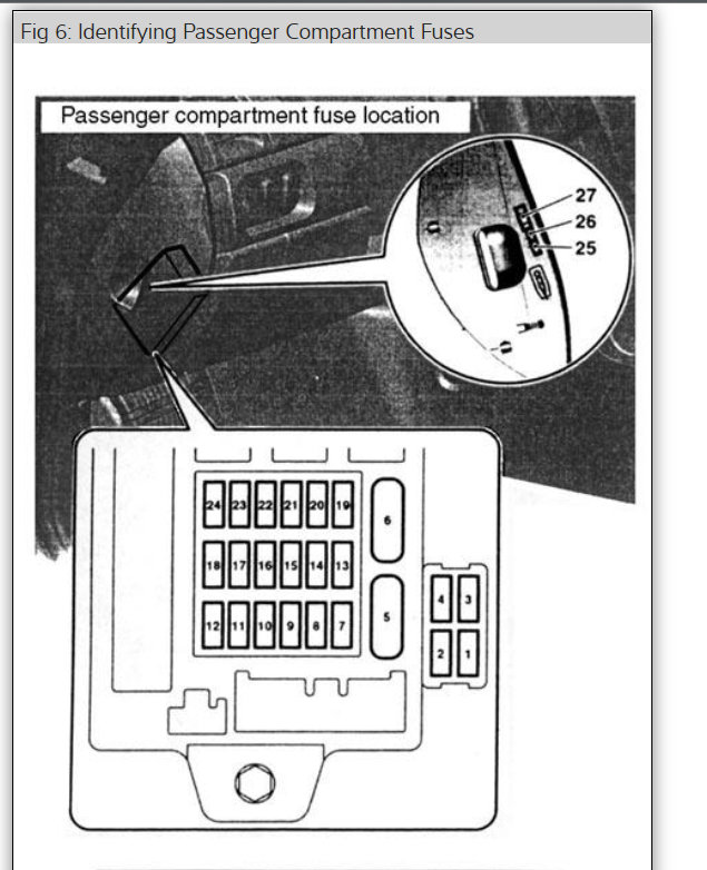

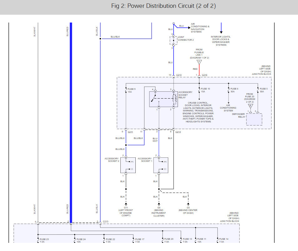

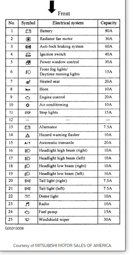

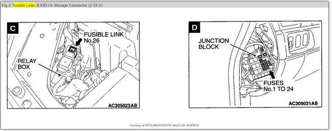

There is a fuse #9 that needs to be checked. but there is also an accessory relay that needs to be checked as well. here is the wiring diagrams so you can see how it works with two guides to help you with the testing:
and
Check out the diagrams (below). Please let us know what you find.
