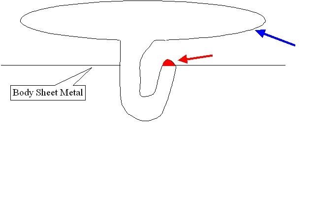

I manufactured a sad drawing to show how to remove these hooks. To get them out of the metal body panel, use the seal to pull it out very gently, then you will see the end of the hook peeking out of the hole. That is the tip shown in red. Use a small flat-blade screwdriver to push that hook in the direction of the red arrow. There is usually some ridges on that part too, so you may have to push and release it a few times. The blue arrow is pointing to the head that sits inside the seal.

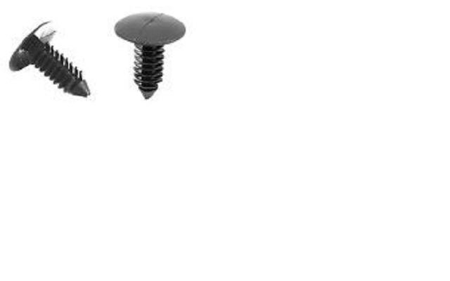

A different version of this clip uses "feather fasteners", meaning a group of flexible wings that allow the clip to be pushed in easily, but it will not want to come out. There is a forked tool for prying those out. You can also get them out by cutting them with a side cutters, or you can use the side cutter or a needle nose pliers to grab them, then pry them out. If you use a needle nose pliers, it is easy to scratch the paint, so use that as a last resort.

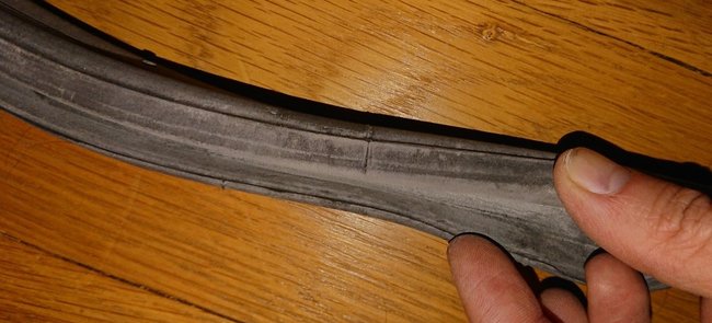

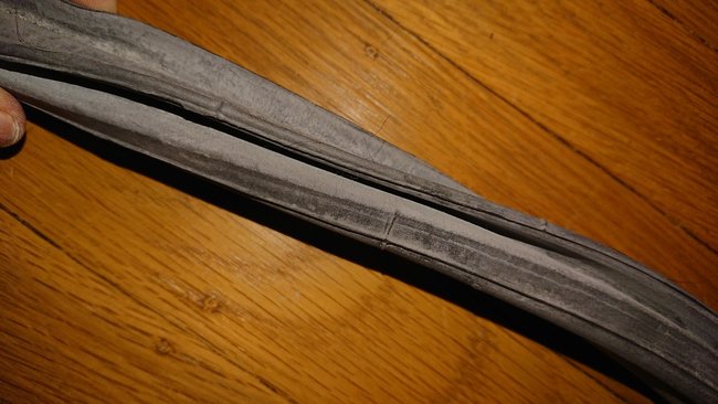

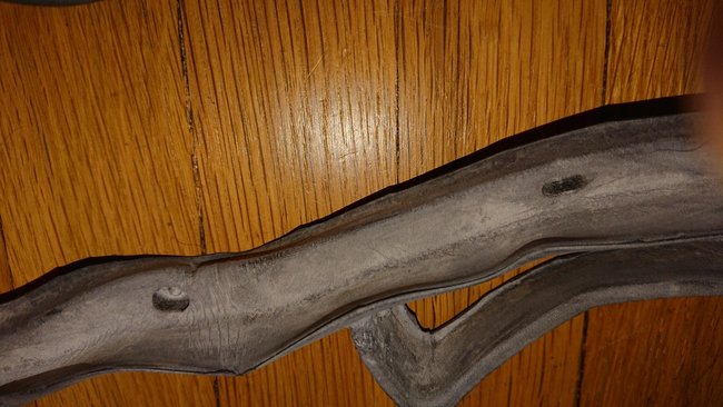

Hello Caradiodoc,
Thank you for your very fast and thorough answer, and pardon my delayed response.
Here are some photos of what I consider to be the "back side" of the seal - I am not confident that the photos are helpful, I wasn't sure how best to present it. However, it seems that there are ridges on this seal, that will I imagine I will be stuffing into a channel. I've also included a photo of the portion that (I believe) will go on the "inside" (hinged part) of the door. You can see there are a few holes there - are those for clips?

Looks like you will have a channel to push the rubber into. You will need to work it in a small section at a time. Holding it against the channel, then pulling on the weatherstrip to stretch it will help it slide into place. Spraying some Silicone Spray Lube will help it go into the channel. That goes on like water and makes rubber parts slide over metal parts real easily, then the liquid evaporates and leaves a film of "slippery" behind.
The holes in the third photo are for air to blow in while the vehicle is in motion. That fills the hollow seal and makes it balloon up to form a tighter seal.

Hello again Caradiodoc,

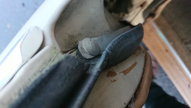

I was getting ready to swap the door seals, when I noticed this metal strip over the seal near the front of the door up by the window. The strip has 6 or so pins or plugs in it (you can see one in this crummy photo) , which correspond with the little divets in the new seal (see the third photo in my previous photo set).
What should I be doing with those? Will I be able to pull them easily and replace them?
Thanks again for any help!

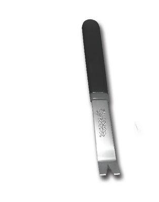

I call these "feather fasteners", but I think the proper name is "fender plug". They have wings that hold them in place. There's a number of tools for prying these out. The tool in the second photo is from Matco Tools. You can use a simple needle nose pliers too, but the tip can scratch the paint. If you use a pliers, use it to squeeze the plug, then pry it out. If you don't squeeze it, the head of the plug might just fold upward, and it won't pull out.
If the wings aren't damaged, it is customary to reuse these plugs.
