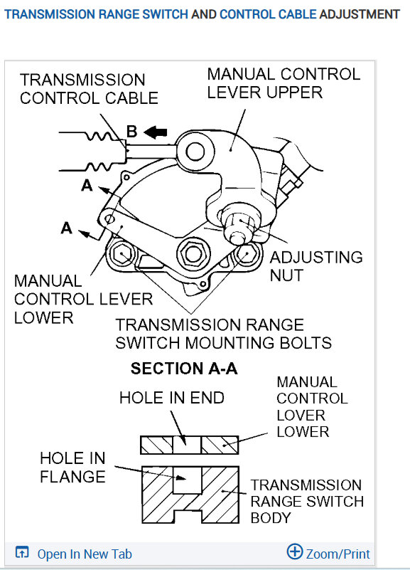

The first thing I would do is check the bulbs and then the fuse #8 in the fuse panel at the lower left hand side of the dash. The reverse light switch in integrated into the neutral safety switch, (transmission range switch). which is where the cable attaches to the transmission. Check out the images (below). Let us know if you need anything else.
