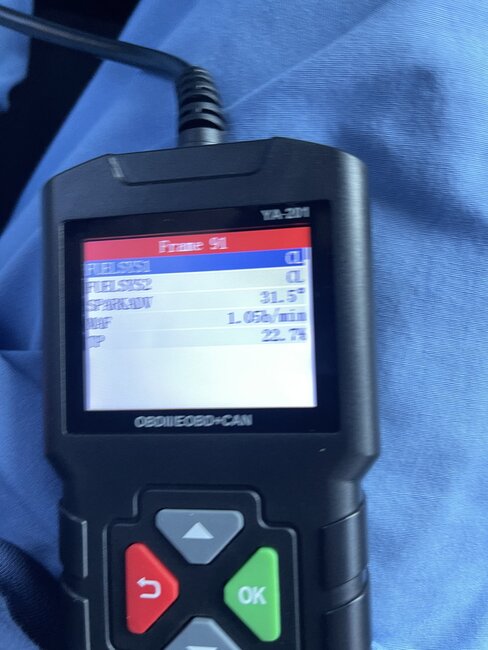

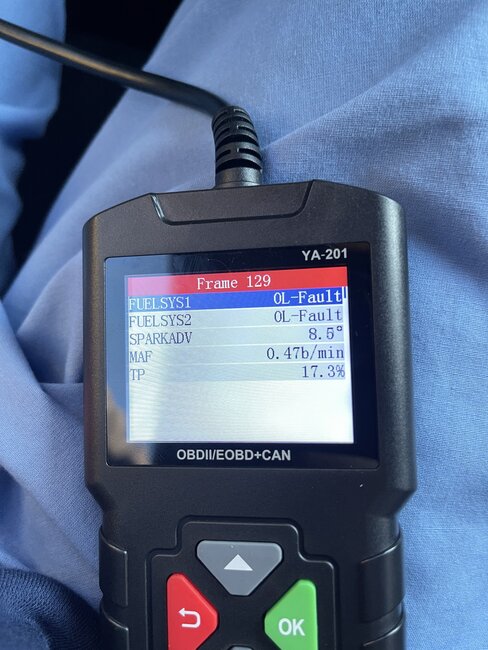

I have a cheap code reader, I’ve seen where i have an open loop fault when its doing it. Then i accelerate and it goes to closed loop and runs normal.
I'll upload some pics of the code reader info that i have and ill get a video of the noise ASAP.

Sounds good, does it give the option to scan the Stabil Trak? I want to see if the system has a code or if it is related to the engine problem, I has a thought it might be.
Feb 2, 2023 at 1:40 PM
JAYLON11
  • 4 POSTS
No, I don’t think it has that capability. I will get you that video as soon as I can. Sorry for the delay in that.

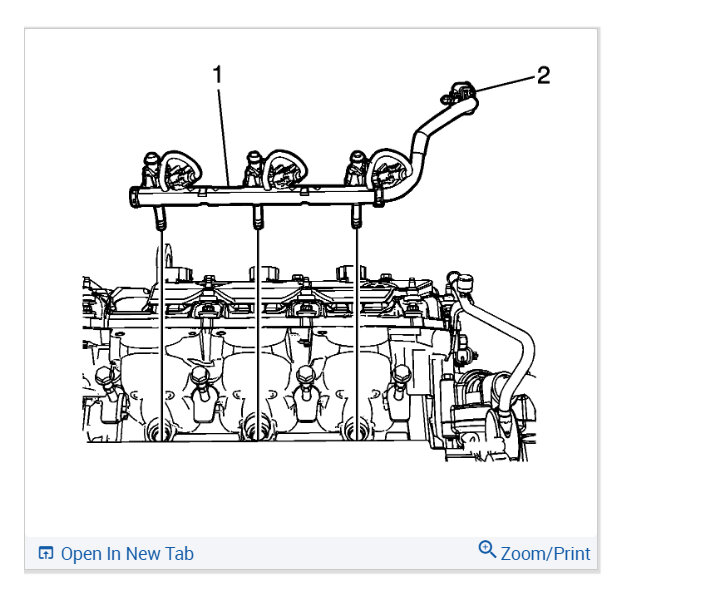

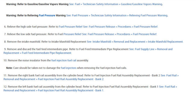

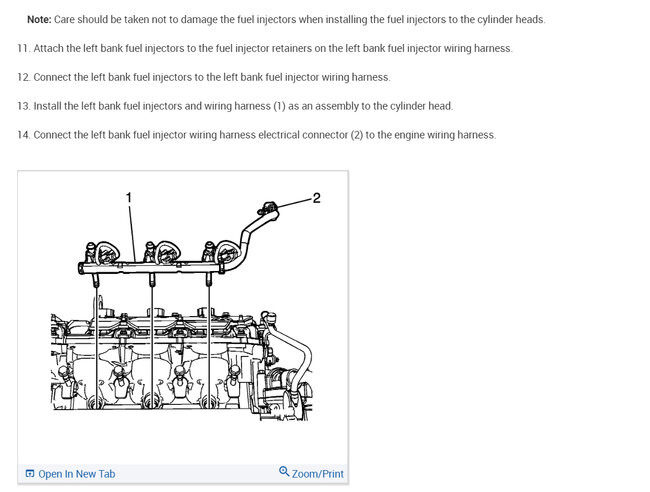

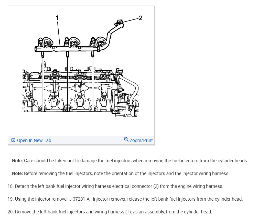

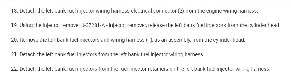

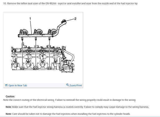

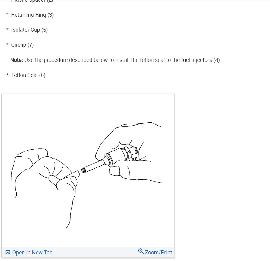

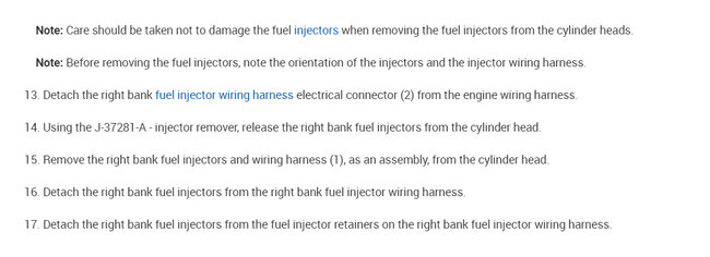

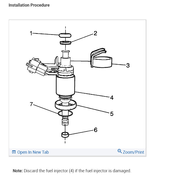

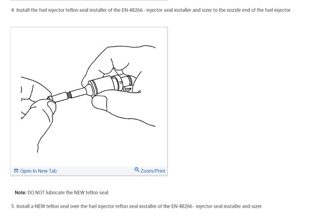

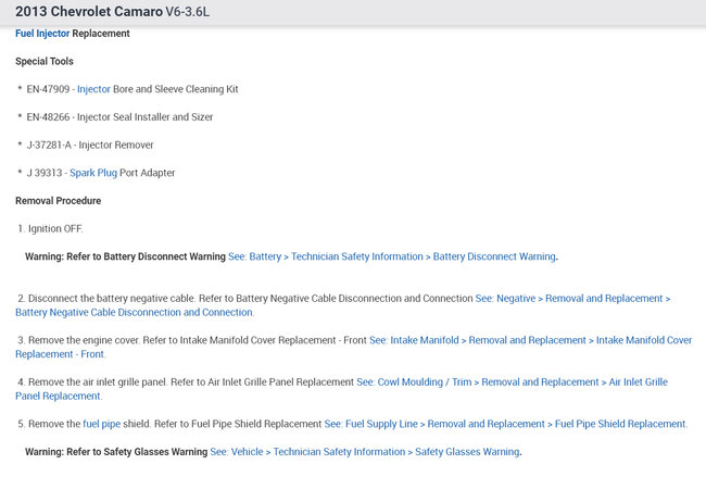

Np, I have seen the fuel injector go out for that cylinder and cause the misfire issue FYI. Here is a guide to help check it and instructions on how to remove the fuel injector for testing:
https://www.2carpros.com/articles/how-to-test-a-fuel-injector
Feb 3, 2023 at 1:38 PM

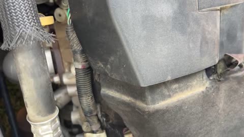

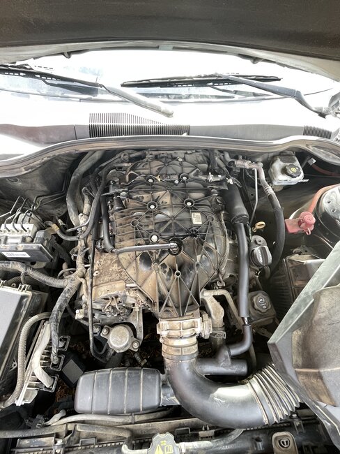

Just to preface, I bought this car used about 3 months ago. Upon closer inspection, it appears to have not been kept up well. There are several spots that look as tho they should have some bolt attached, but none… silver tape around some of the electrical connections and so forth. I’ll add some pics and video. To clarify, cylinder 6 is on the driver's side closest to firewall. I ask because the ticking seems to be coming from drivers' side closest to firewall… hopefully you can tell from video.
Feb 4, 2023 at 11:43 AM

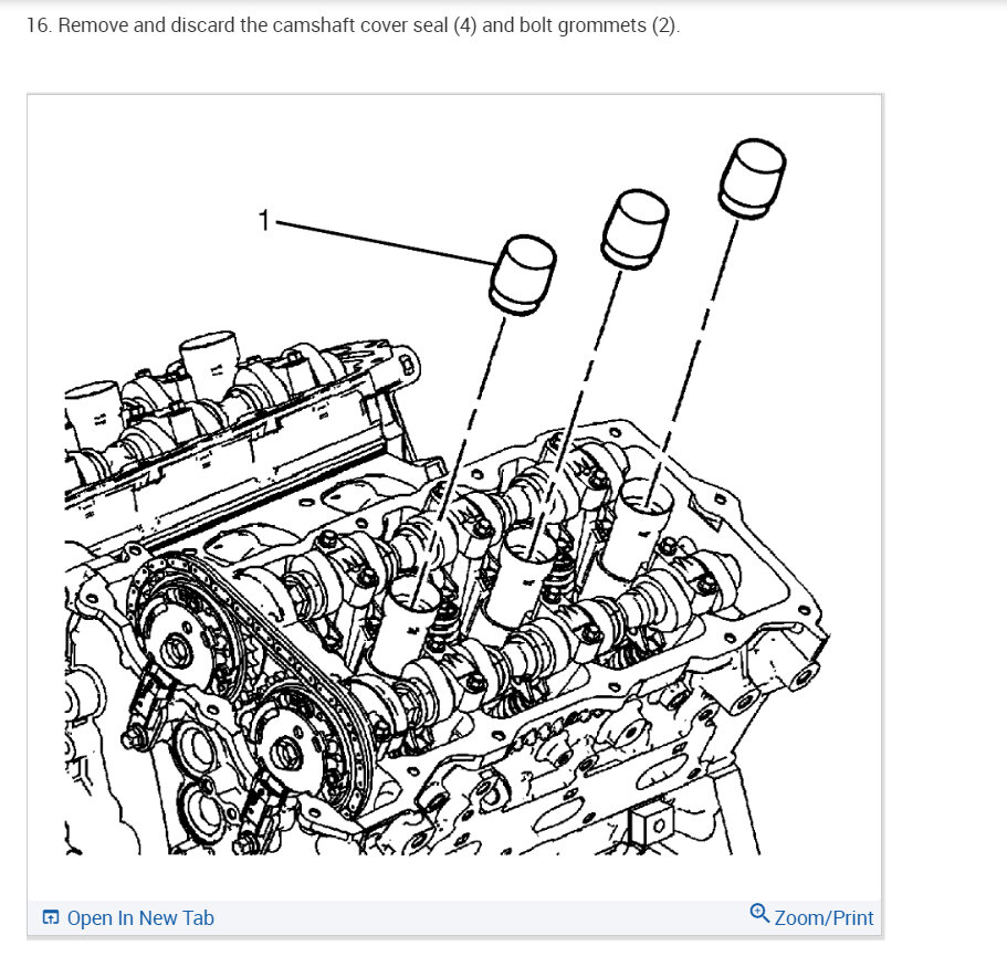

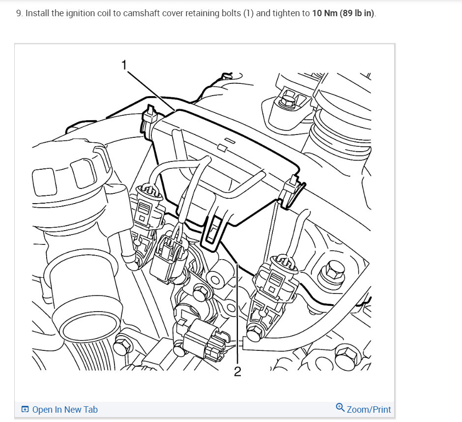

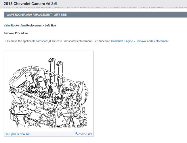

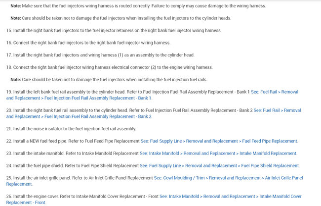

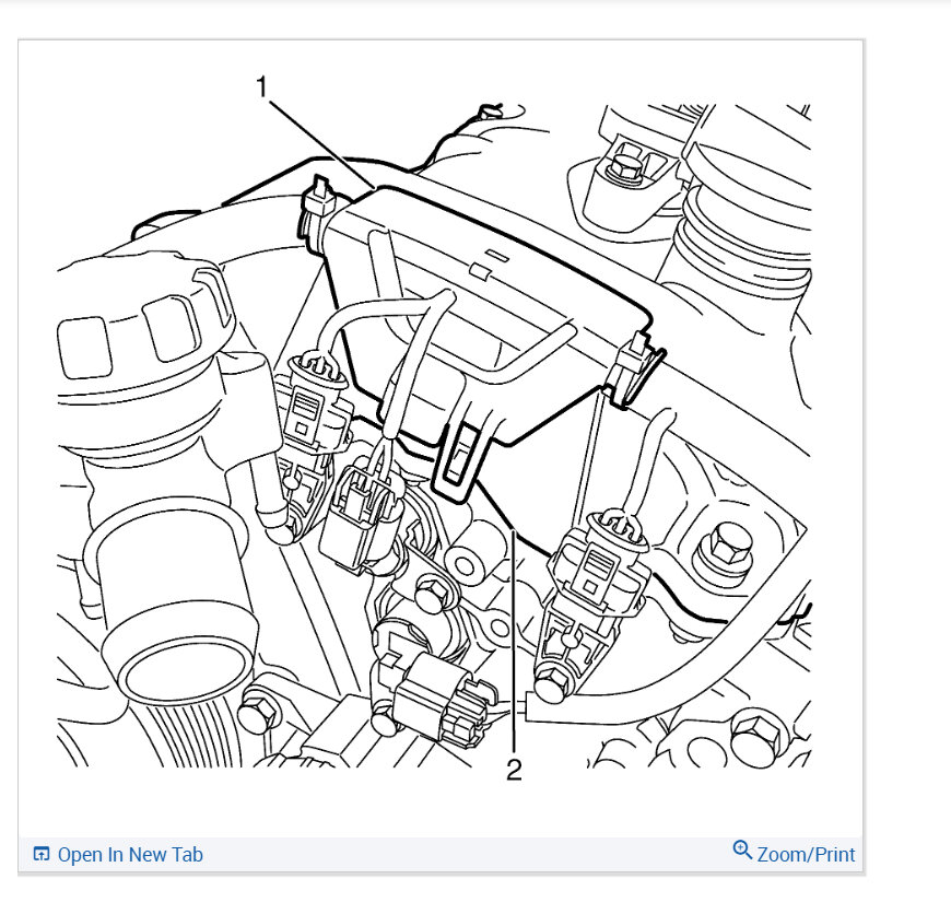

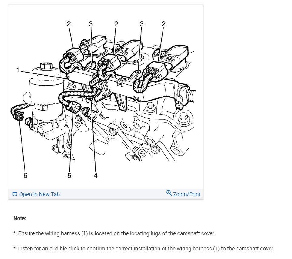

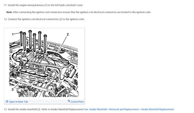

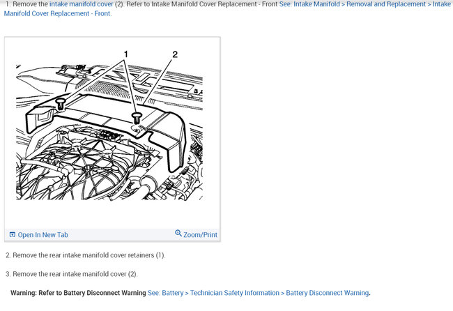

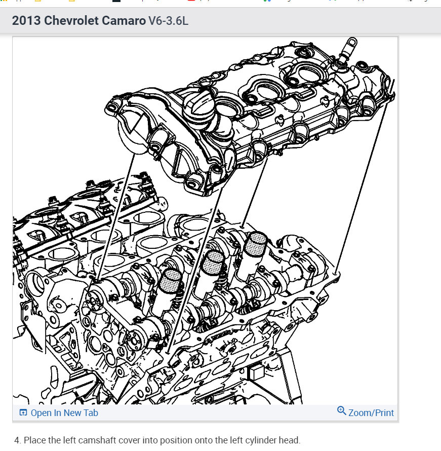

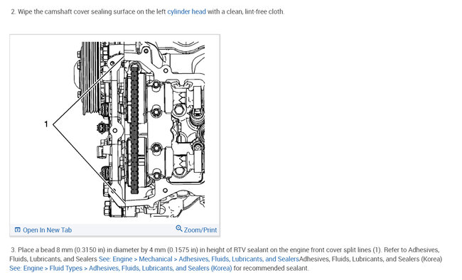

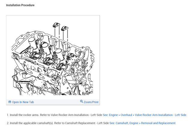

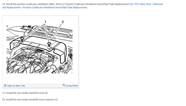

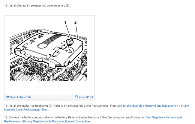

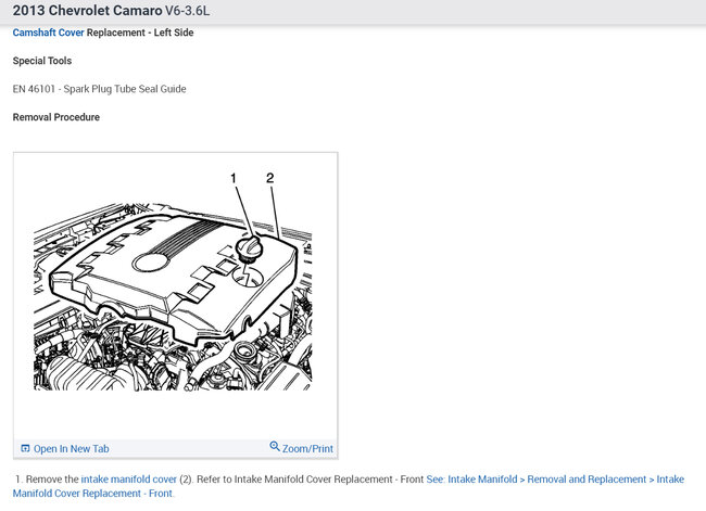

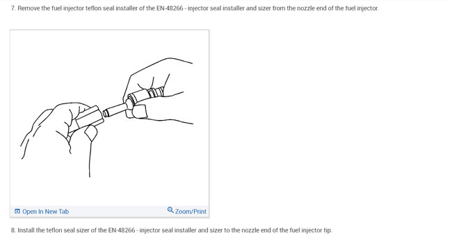

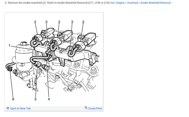

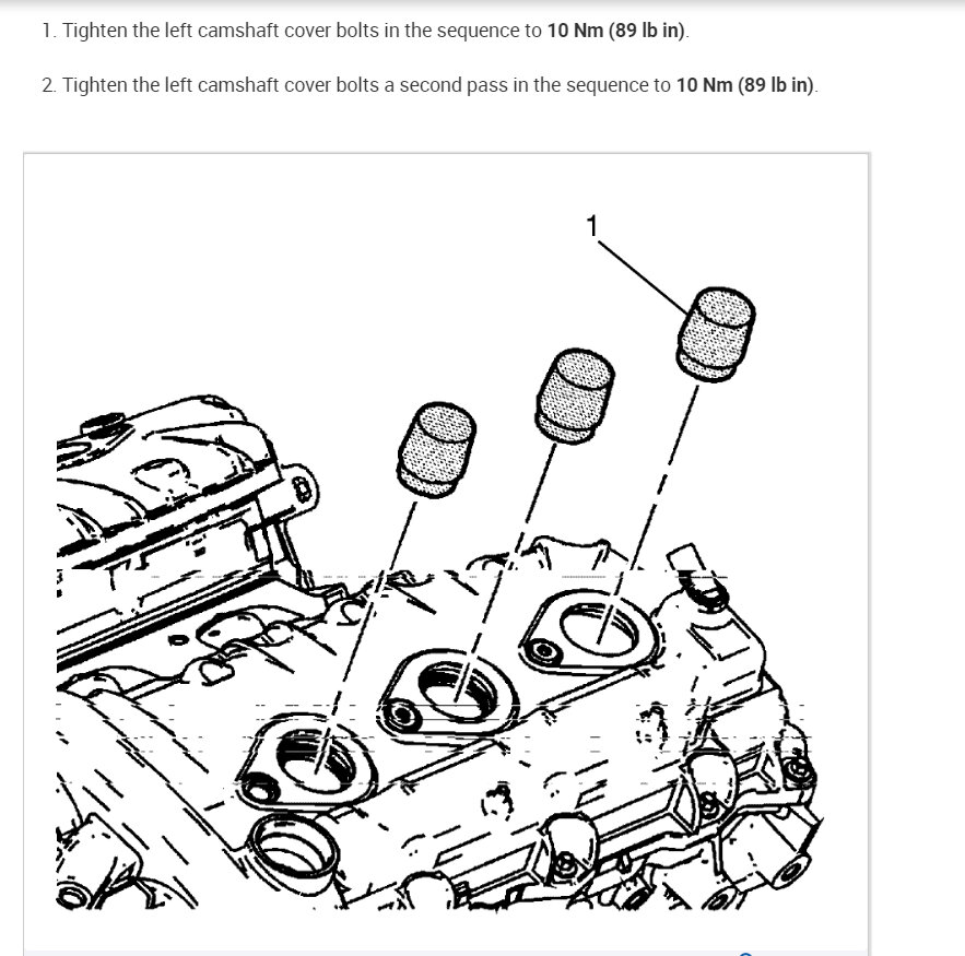

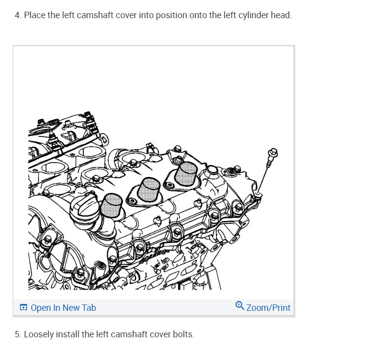

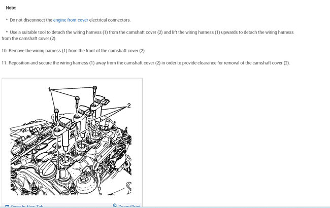

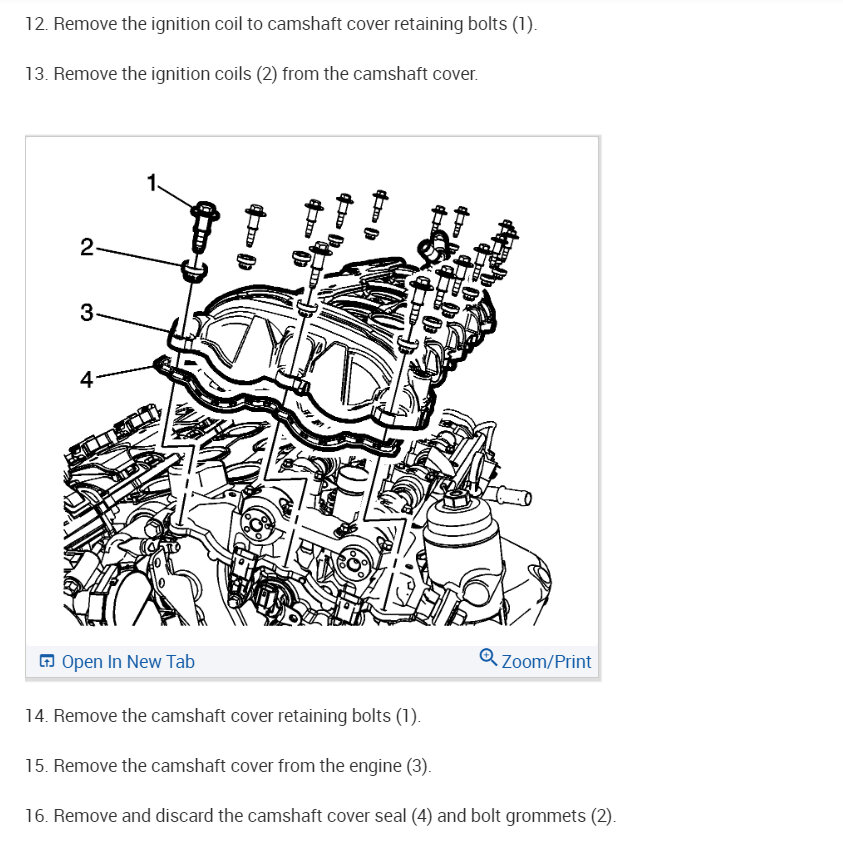

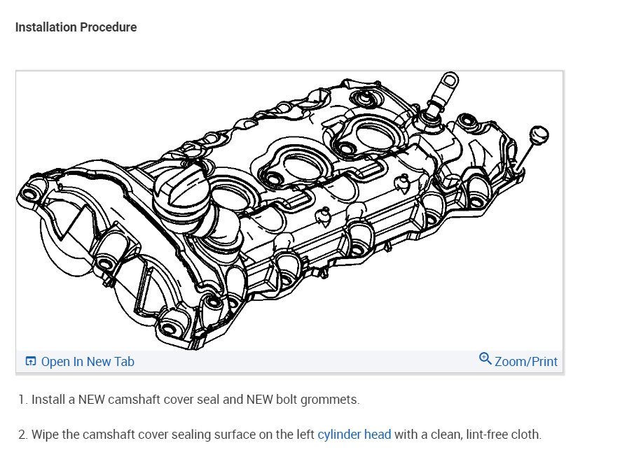

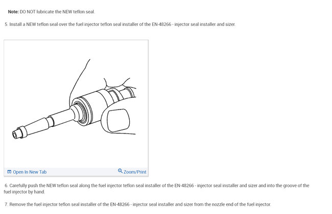

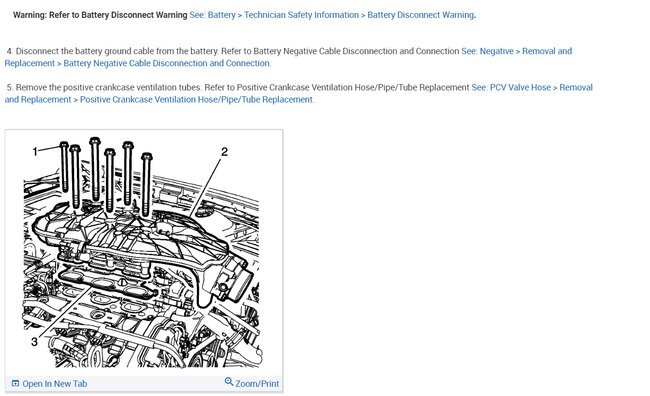

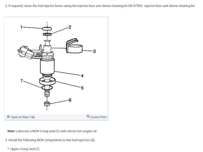

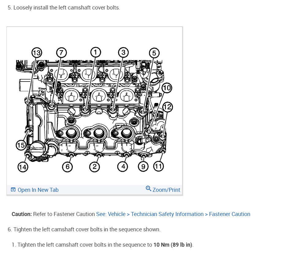

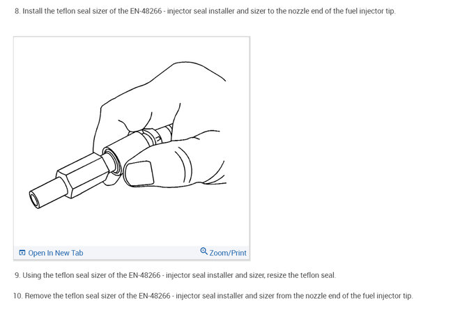

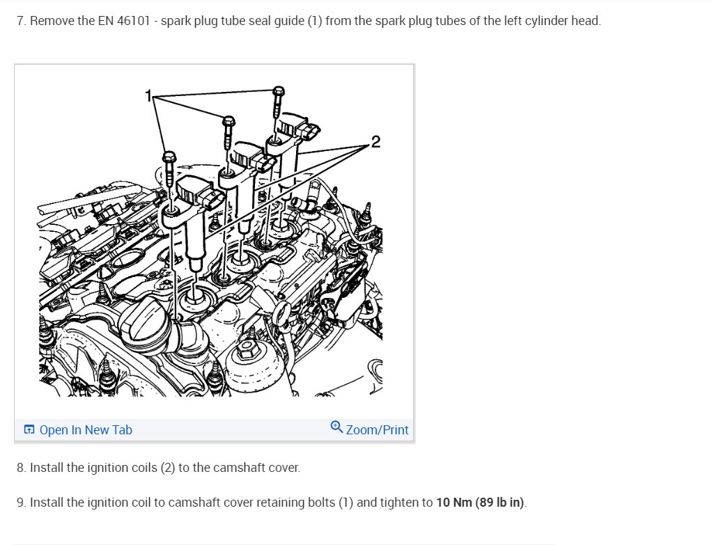

Thanks for the video. Yep, then engine valve trains should like a lifter has collapsed or rocker has come part (roller bearings fell out) which will cause the misfire issue, the engine looks like it is running smoothly though so that a good sign. I would remove the valve cover to see how the rocker arms are. If they are okay the camshaft will need to be removed and the lifter replaced. Here is how to remove the valve cover for inspection. Check out the images (Below). Let us know what happens and please upload pictures or videos of the problem so I can help walk you through the repair.
Feb 5, 2023 at 1:13 PM
