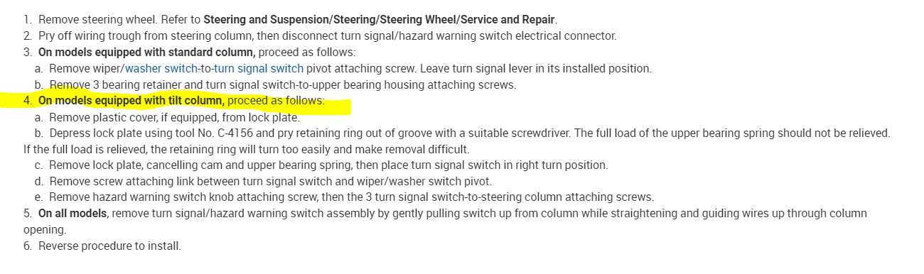

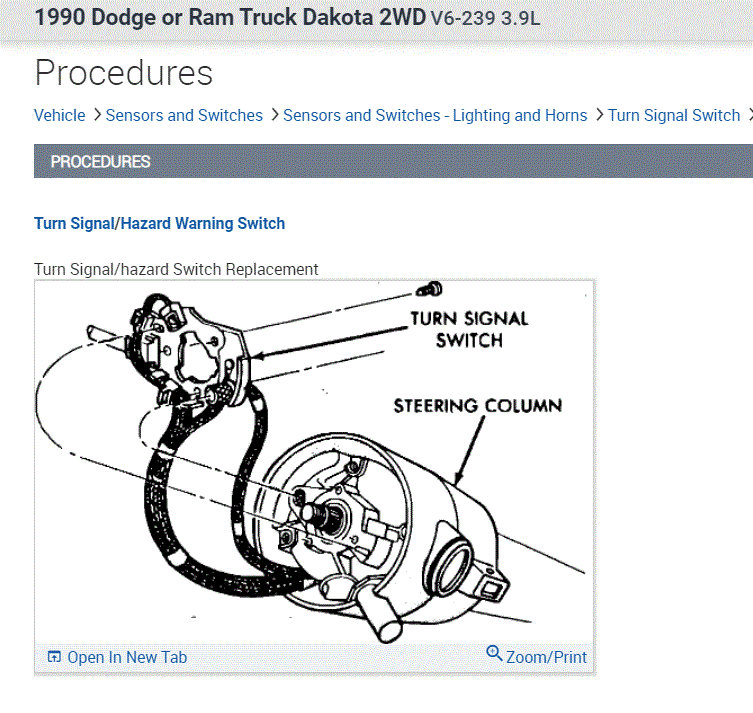

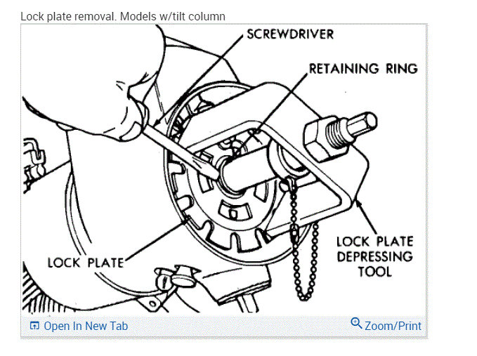

If you look below, I provided the directions for replacing the switch. In the last pic are the primary directions. I highlighted where specifics related to a tilt wheel begin.
See pics below.
