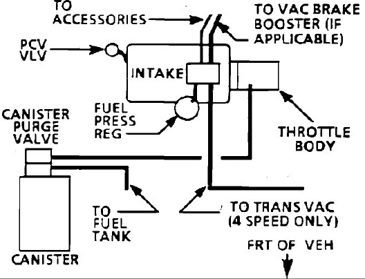

If you changed all those parts and it ran good at first it should not be firing order related, that would have shown up instantly. Oil should not have caused this either. Your description sounds like a vacuum leak. Possibly a hose was loosened and fell off on the drive. I would check the vacuum lines first, loose, off, cracked lines would all be suspect on an elderly engine.
