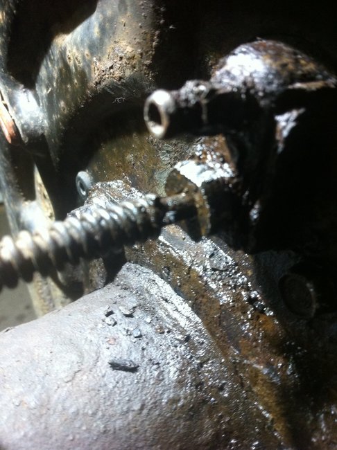

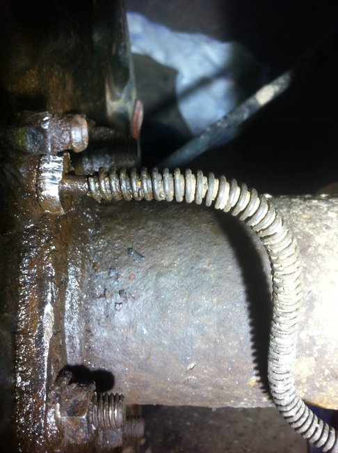

Thank you for including the photos. I overlooked them the first time. You can see the line right next to the nut is badly rusted and is going to break. There is absolutely no way the nut will ever spin on that line again without leaking. The only thing you could hope to do is get the nut loose, then rotate the wheel cylinder to unscrew it from the nut. Most of the time you have to twist the cylinder as you rotate it, and that too will crack the rusty line. Just throw on the new line and wheel cylinder, then buzz off into the sunset.

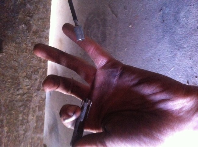

I got the brake line issue fixed now I am on the parking brake issue.So I ran the cable but on the drivers side were they connect the cable is a little short but the auto store says it's the right one.not sure how it could be.Unless I am doing something wrong?here is a pic.I tried pulling it an it goes no further.

CARADIODOC
  • 34,307 POSTS
What solved the leaking line?
I believe the connector is on the cable that goes to the front main cable. Sometimes there's a hook hanging from the frame or cross member to hold the cable, and there are multiple holes in the frame. Check if there is a different hole that hook can be moved to.
If you replaced the rear cable(s), be sure the casings are snapped into their fully-seated positions.
The most common thing I run into when the cable is too short is the parking brake pedal dropped down and is in the partially-applied position. Have a helper pull the release handle, then tug on the cable. I bet that will get you the few extra inches you need.
