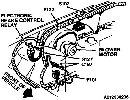

Is there any information out there about where the electronic brake control relay is located? For whatever the reason I am finding it very difficult to find information on this car.

Extreme cold = ABS issue = Sounds like a bad wheel speed sensor. I would take it to a shop that can scan it and give you the ABS codes. Then you gave a starting point to determine a repair.
The relay is on the firewall behind the strut tower.

That makes perfect sense. I will take it down tomorrow and get it scanned. Thank you for that picture too. I have not been able to find that anywhere.
