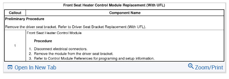

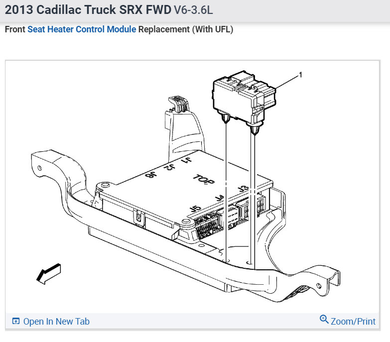

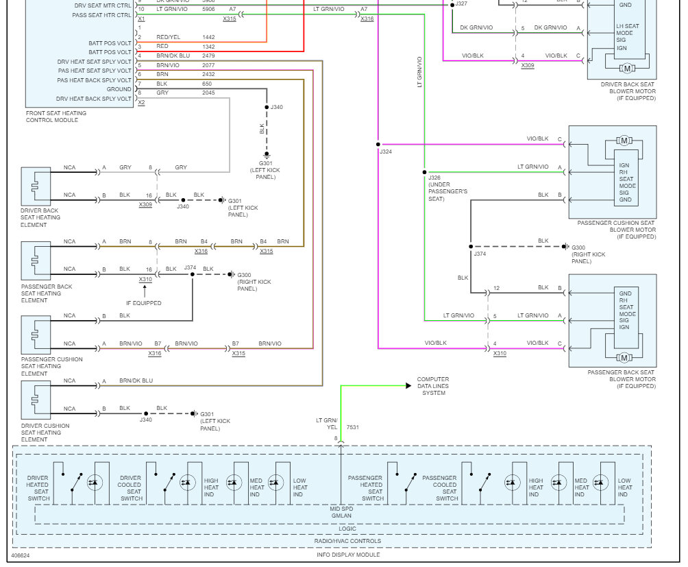

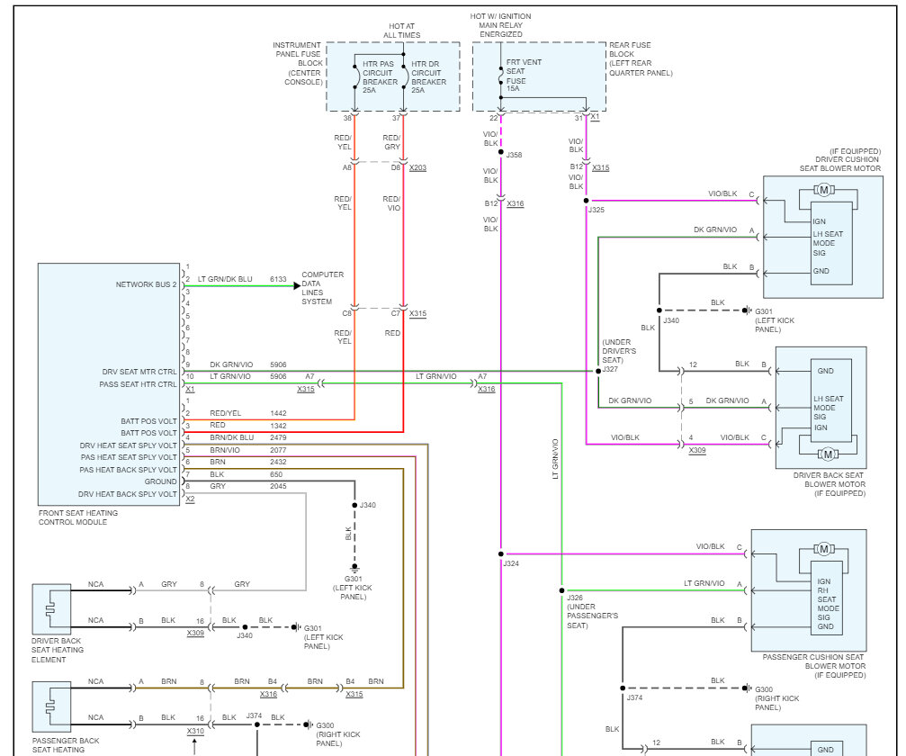

Here are the climate control seat wiring diagrams so you can see which fuses to check and how the system works, and I have included how to change the module out as well.
