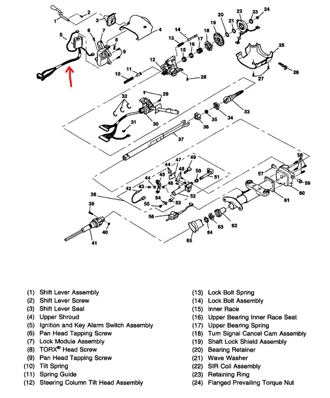

Hmm, the truck does have the Pass-Key system so I am not sure why it would start without programming, the BCM handles the security system operation so it might have been a BCM code to help us see what's going on, here is how to get the codes which will will need.
https://www.2carpros.com/articles/how-to-gather-airbag-safety-system-codes
I can tell you I have seen the pass lock sensor which is part of the ignition switch go out which is the ring at the ignition switch, but that should show up in the scan, here is the part I am talking about. Check out the images (below). Please let us know what happens.

Yep, the first code can be the the pass lock sensor failure, I would replace it to see if that fixes the problem.
Code B1054 - Loss of Keep Alive Memory (KAM)
Code B1026 - HVAC Mode Door Actuator Circuit Range/Performance
Let us know how it goes.
