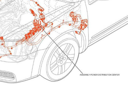

Here is the TIPM location in case you need to replace it. Check out the images (below). Please upload an image or a short video in your response, so I can see what's going on.
