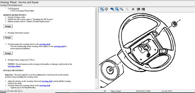

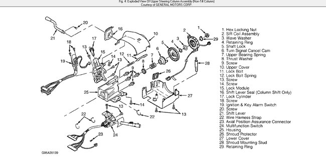

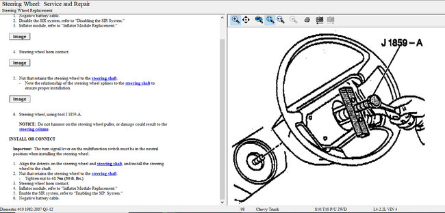

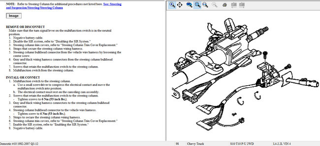

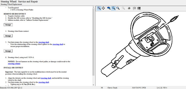

Check the steps below how to replace turn signal switch. first disconnect battery cable. disable air bag system. remove steering wheel. remove knee bolster if necessary. remove bolts and screws and the lower and upper column cover. remove lock cylinder, if necessary, remove wiring harness strap.disconnect steering column electrical connector. disconnect turn signal and multifunction switch gray and black connector. remove turn signal and multifunction switch from the vehicle. check the diagrams below how to remove and reinstall turn signal switch. Check out the diagrams (below). Please let us know if you need anything else to get the problem fixed. thank you.

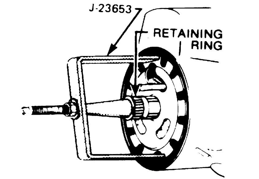

Good evening,
I attached the procedure below for you with a picture for you to view.
1. Disconnect battery ground cable.
2. Remove steering wheel.
WARNING: Refer to Air Bags and Seat Belts/ Air Bags (Supplemental Restraint Systems)/ Service and Repair/ Air Bag System Disarming & Arming.
3. Using a screwdriver, pry cover from lock plate.
4. Using lock plate compressing tool No. J-23653, or equivalent, remove lock plate as follows:
a. Compress lock plate and pry retaining ring from groove on shaft, Fig. 5.
b. Slowly release lock plate compressing tool, then remove tool and lock plate from shaft end.
5. Slide canceling cam and upper bearing preload spring from end of shaft.
6. Remove turn signal (multi-function) lever.
7. Remove hazard warning knob retaining screw, button, spring and knob.
8. Remove pivot arm.
9. Remove switch retaining screws and pull switch up from column, guiding wire harness through column.
10. Reverse procedure to install.
