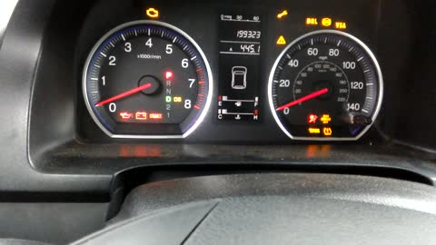

This issue started on this vehicle after roadside electricia did wrong connection on the A/C line and it started that when you turn ignition on, the PGM-FI Relay, ECTS, PGM-FI SUB-Relay, Fuel Pump Relay will be making clicking sound and oil warning lamp and key light blinking together with the relays clicking sound. I put old ECM, battery, oil and key light did not come on. I got another ECM, and it was doing the same. What could be the cause of this? I attached the video below.

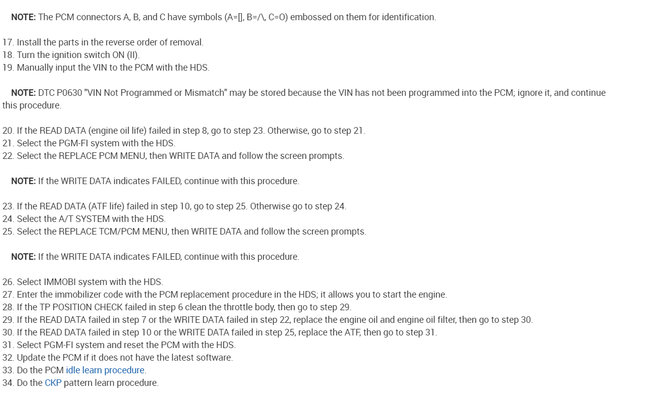

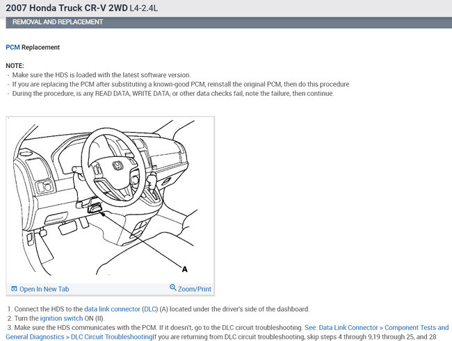

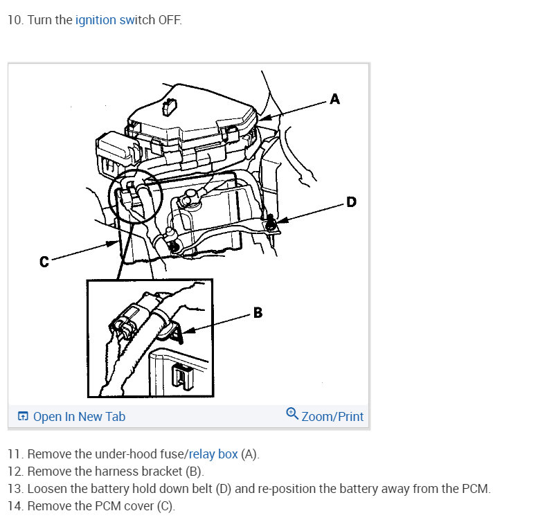

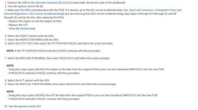

It looks like the security light is flashing. So, did you get the new ECM programmed to the car? If not, this is your problem. Here are the instructions on how to replace the ECM correctly in the diagrams below. Also, we should make sure the battery is in good shape. This guide can help:

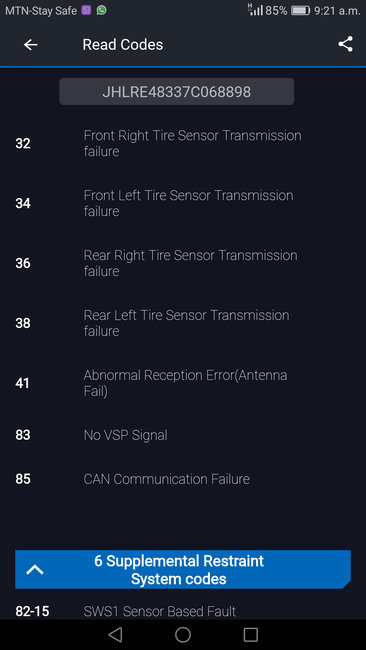

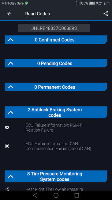

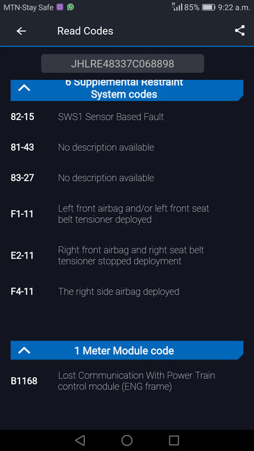

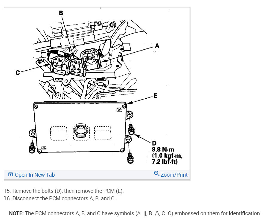

The new ECM, I didn't use again because, when I plugged it in and turn ignition on, the same issue continues. I removed it and put another one and turned the ignition on, it continues, and I put the third one and it continued. Then I concluded that this is not ECM issue, because there's never a way three different ECM will be doing the same thing with ECM installed on the vehicle. Supposing I put ECM and that thing stopped, I will know it's from ECM and I will get one and program it to the vehicle. If you start the vehicle, it will start and after like 2 minutes it will be off. If you connect scanner, it will communicate but will not display code on ECM but display on other modules. I want to change the under-dash fuse box to see if it is from there. I attached the picture of the diagnosis below.
