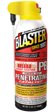

What kind of penetrating fluid is best and how long to soak?
Jul 22, 2024 at 1:25 PM
There are many good ones. At the shop, I use PB Blaster. Spray it the night before doing the work and allow it to soak overnight. That should be more than enough time.
On the other hand, try to see if one comes out with ease before doing anything. You may be surprised. They may come right out for you.
Let me know how things work out for you.
See pic below.
