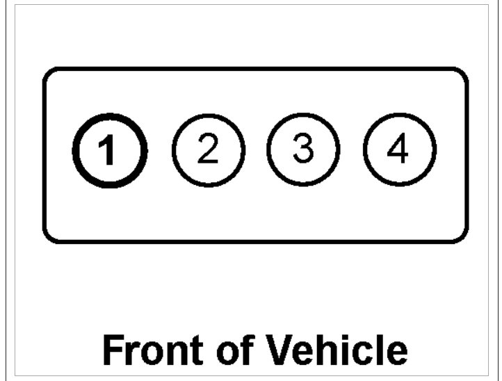

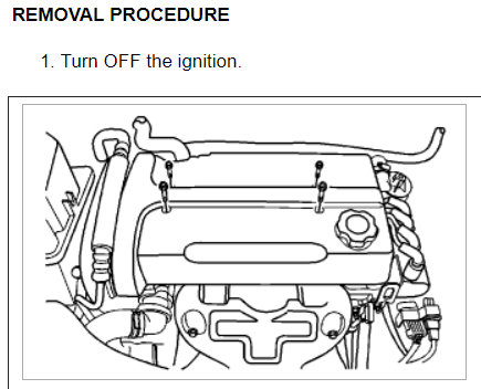

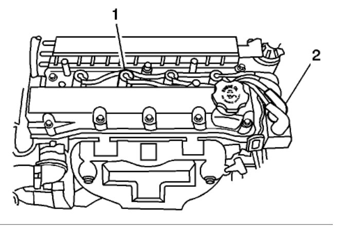

Spark plug wires were removed and not sure of firing order they go.

Here is the firing order:
Firing order 1-3-4-2.
Check out the diagrams (below).
