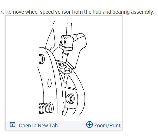

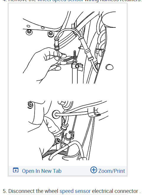

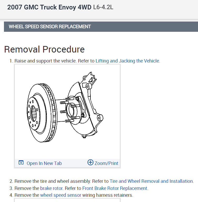

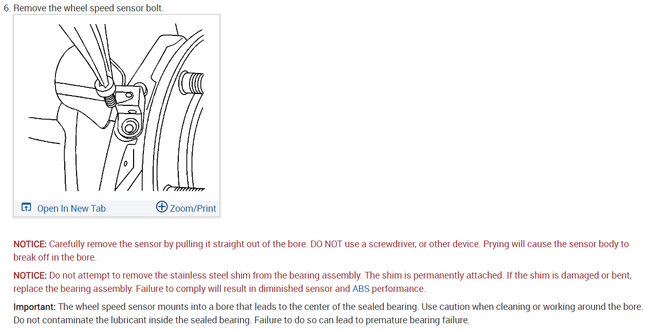

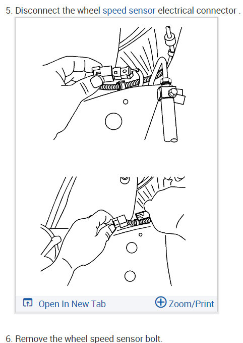

It not too bad, you will need to raise the car up and jack stands (front) and remove the front wheels, these guides can help and I have included how to change the wheel speed sensor out in the images below.
and
