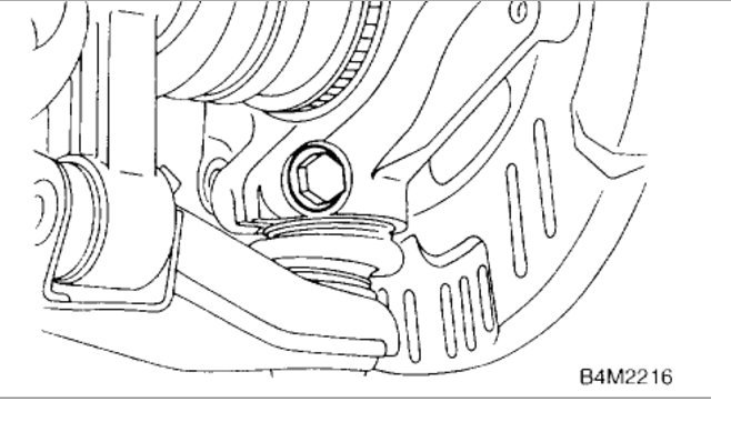

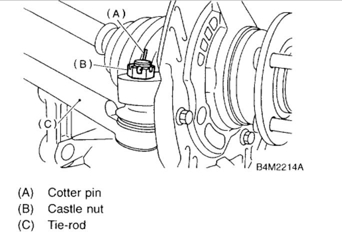

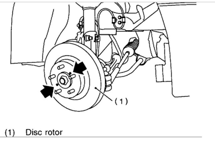

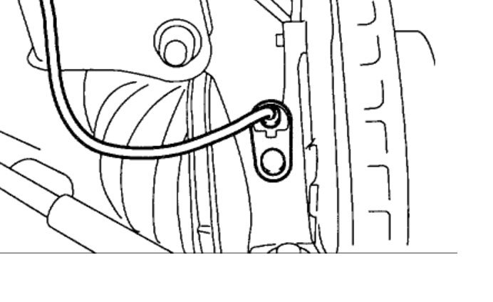

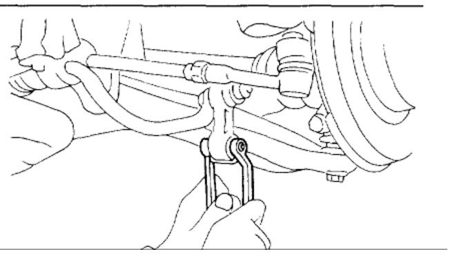

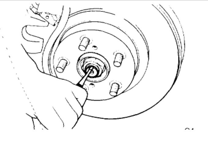

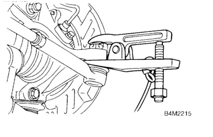

It sounds like you have a drive axle on the passenger's side that needs to be replaced. Here is a guide to show you what you are in for when doing the job:
https://www.2carpros.com/articles/replace-cv-axle
Here are some diagrams (below) of how the job is done on your car.
Jul 20, 2017 at 10:41 AM
