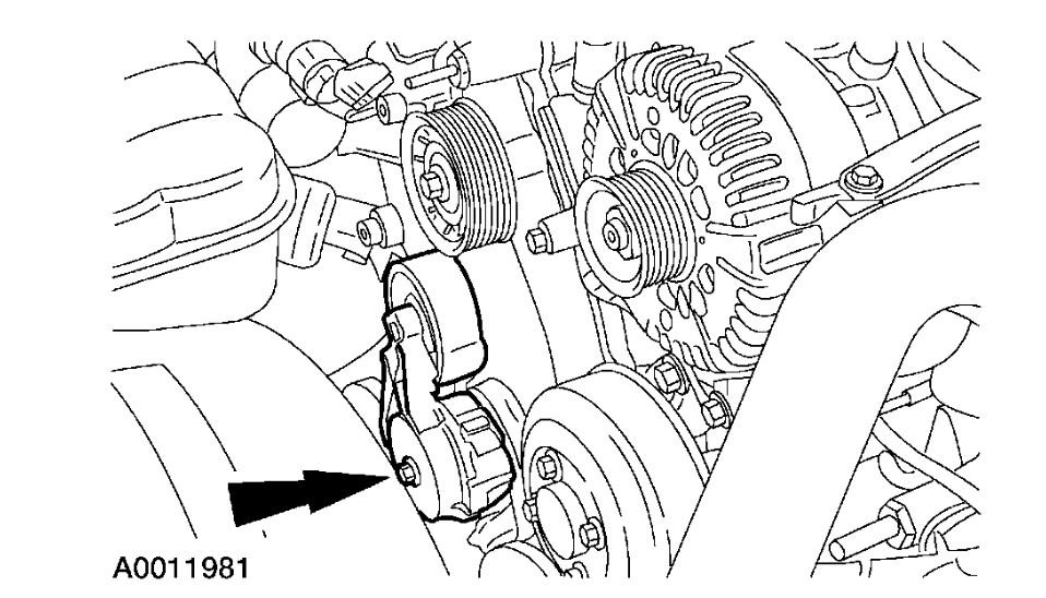

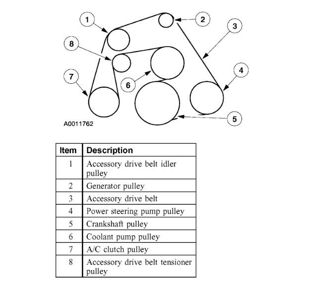

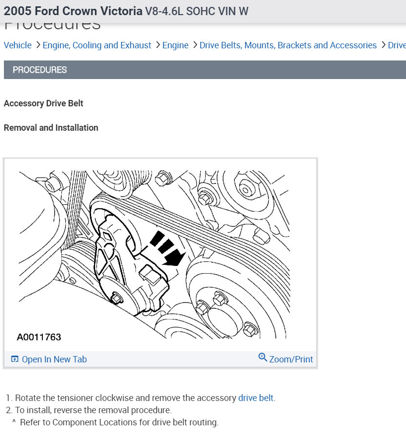

9 times out of 10 it will be the serpentine belt which should cost about $25.00 here is a guide to help walk you through and instructions in the diagrams below for your car:

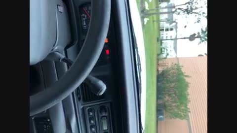

This is the start up, it’s not the brakes, only when I hit the pedal.
Video (Click to enlarge)

This could be the drive belt. There is a tensioner that keeps the belt tight. It is common for wearing out and the belt tension is not correct allowing this type of noise.
