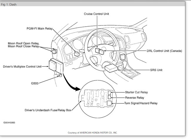

Possible diagnosis is the BCM. If it is the BCM, where is it located on this vehicle?
Jul 31, 2018 at 2:19 PM
Good afternoon.
No, it is not.
The SRS is the seat belt restraints. There is a fault code stored in the system. I need that code to help you narrow the area of failure.

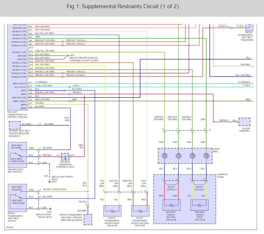

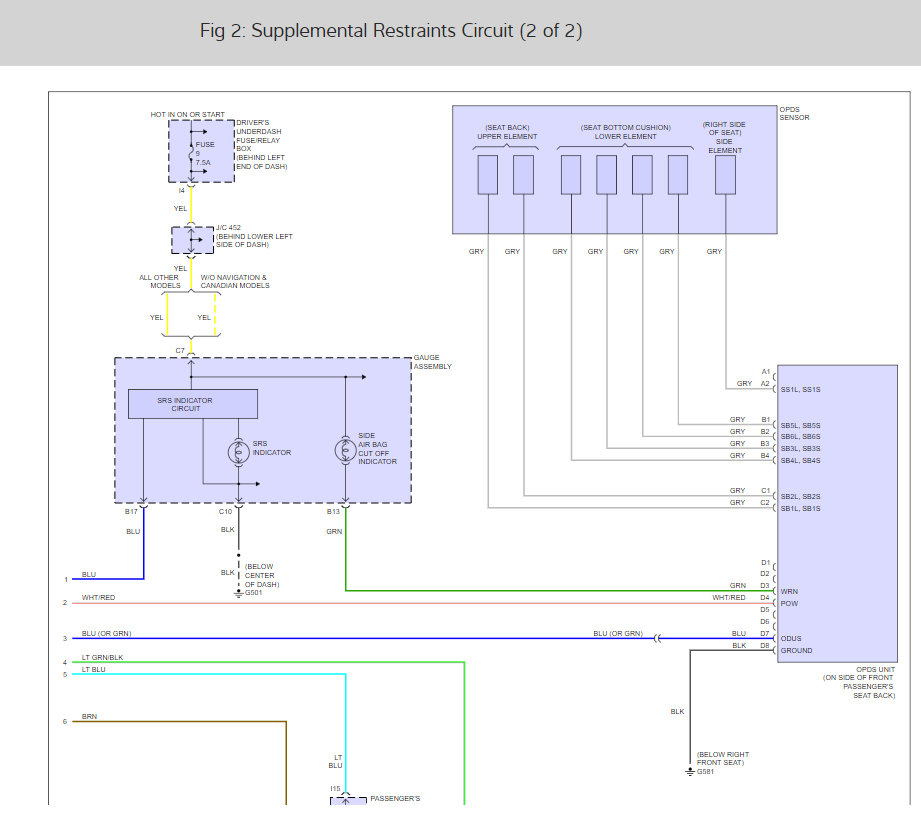

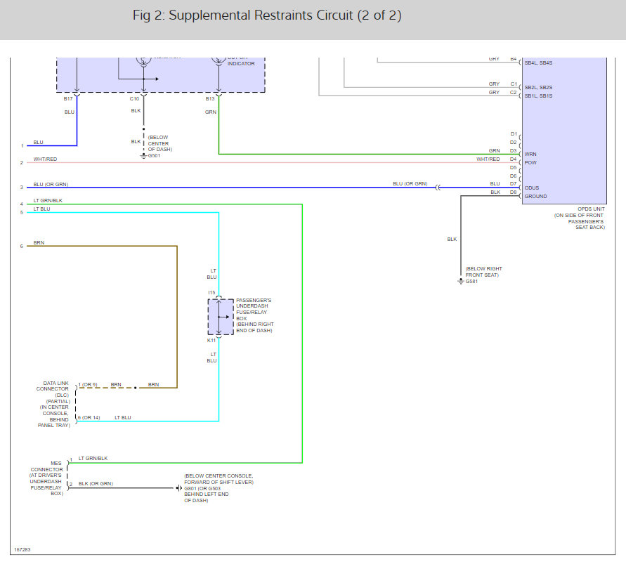

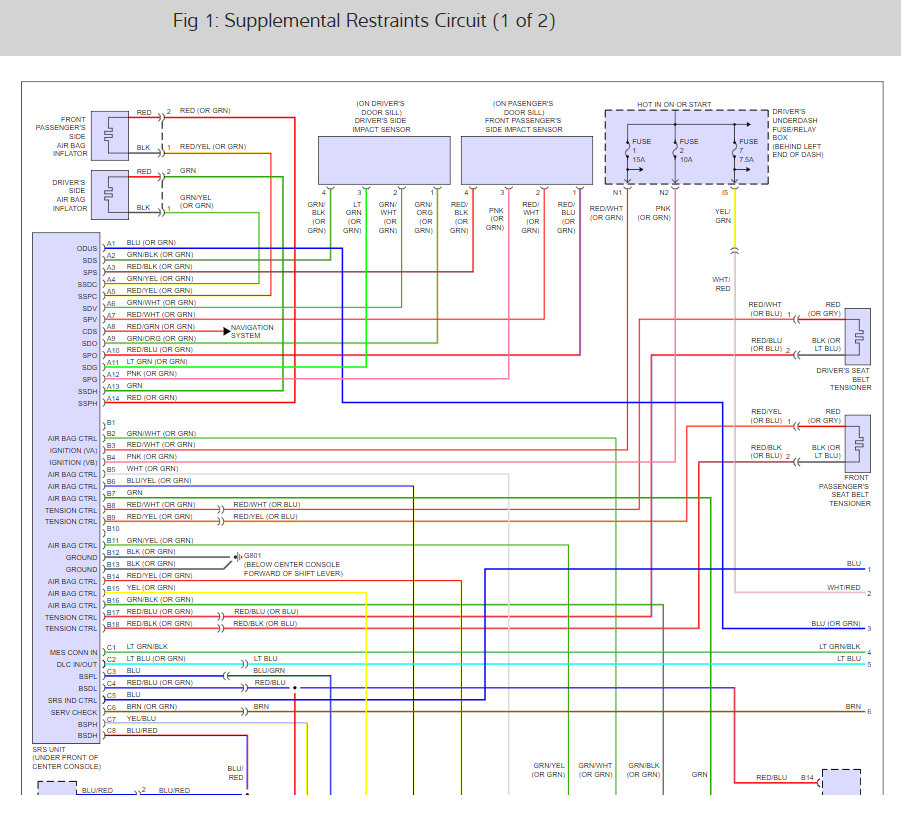

Here is a video showing how to pull the SRS codes. There is not BCM on this car just the SRS control module to run the airbag system.
https://youtu.be/gnSGfEqrf_w
Nine times out of ten it is the clock spring in the steering wheel. Here is a guide to help test it and the airbag wiring diagrams to show you how the system works:
Check out the diagrams (below). Please let us know what you find.
