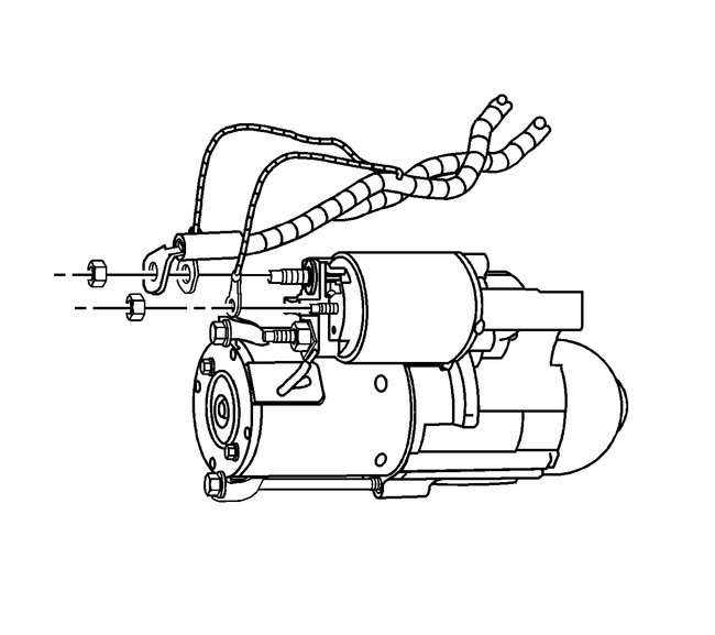

pic 1
3. Remove the starter motor solenoid positive terminal nut and electrical wires.
4. Remove the starter motor solenoid S terminal nut and electrical wire.

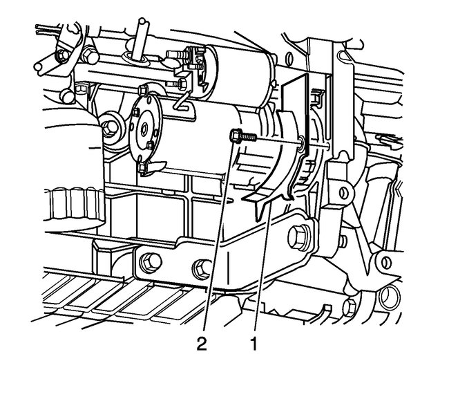

pic 2
5. Remove the torque converter cover bolt (2).
6. Remove the torque converter cover (1).

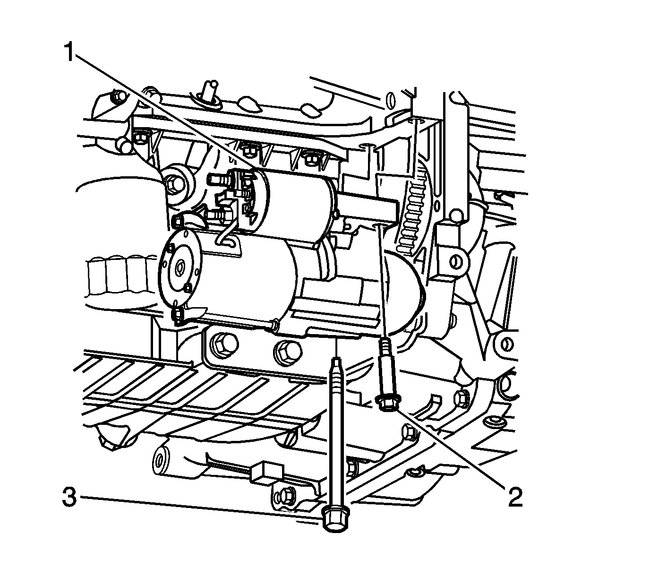

pic 3
7. Remove the starter motor bolts (2, 3).
8. Remove the starter motor (1).

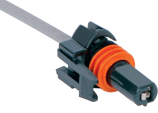

If it's what I remember they used two different connections for the solenoid control wire, one is the original style that used two studs and nuts as shown in service info but they also have a newer design with a single plug in connection like in the image below. If you get the replacement that uses the stud and nut in place of the single pin you need to cut off the plug and replace it with a crimped on ring terminal to use that starter design. Both types are out in parts stores.
This is the process if you use a cheaper connector. Personally it is not the method or connector style I would use on a starter connector that is exposed to the elements.

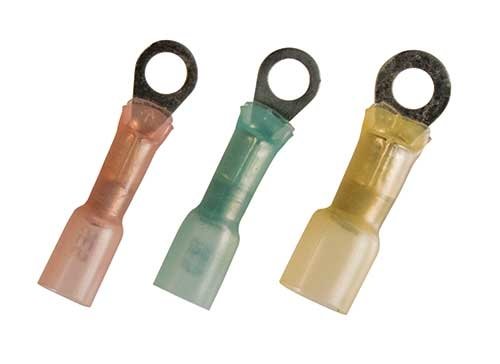

You can also buy ring terminals that have a heat shrink sleeve with sealer in them, but those can be difficult to crimp if you don't have the correct tool and if you damage the heat shrink while crimping you end up cutting it off and doing it again.
