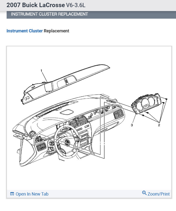

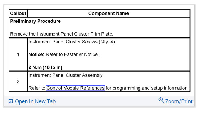

This is common when the instrument cluster goes out and needs to be replaced. Here is a video of the job being done on a similar car with diagrams below to show you how on our car:
https://youtu.be/_HEC44xENxw
You will need to record the mileage and VIN so the re-builder can program the new cluster. Check out the diagrams (below). Please let us know what happens.
