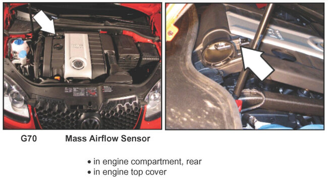

It sounds like the MAF sensor is not working correctly. If it does not see air flow it will shut the fuel pump down. We should run the codes to see if any are stored, this guide can help:
You might want to try to just unplug the sensor to see if anything changes, here is the location. When it stalls, we need to know if the problem is fuel or the ignition system, also is the security light flashing? Please go over this video as well:
