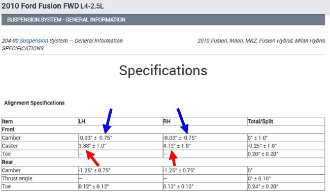

"Camber" is the inward, (negative), or outward, (positive), tilt of the wheel, as viewed from in front or in back of the vehicle. For reference. a wheel standing perfectly straight up and down is 0.00 degrees. If you could imagine a wheel tipped out so far on top that it is laying flat on the ground, that would be 90.00 degrees. Most cars call for up to 0.75 degrees, which is getting pretty high, but it is needed to achieve best tire wear and it places the vehicle's weight right over the wheel bearing to lower stress on those parts. (The Escorts were built with just under 2 1/2 degrees camber which was easily noticeable when following them down the road. It also caused the outer edges of the tread to wear out very quickly.
The first image below shows the alignment specs for your model. Front camber is shown as -0.03 degrees, which, for all practical purposes, is perfectly straight up and down. That value is very respectable, but it's the tolerance of 0.75 degrees that is a heart breaker, (blue arrows).
First let me explain more about camber. Back in the days of old heavy rear-wheel-drive cars, a common specification for camber was 0.50 degrees. On top of that, we either made the left wheel 1/4 degree higher or the right wheel 1/4 degree lower, to offset "road crown". That is the slant of the road surface so water runs off. Without that extra 1/4 degree difference, the car would drift to the right on almost all roads and highways. If we leave camber perfectly equal on both sides, the same road crown offset can be achieved by increasing "caster" on the right wheel by 1/2 degree, or by lowering it 1/2 degree on the left wheel.
A pair of tires wants to pull in the direction of the one with the higher camber value. OR;
A pair of tires wants to pull in the direction of the one with the lower caster value.
To say that another way, camber has twice the effect on pulling as does caster. Now I have to add an important comment. With front-wheel-drive cars and minivans, a difference in caster, even a big one, has no effect on pulling. In all the classes I've attended or taught, no one has ever been able to explain why, but it's only true on those models. That means a pull has to be corrected by adjusting camber on one or both front wheels.

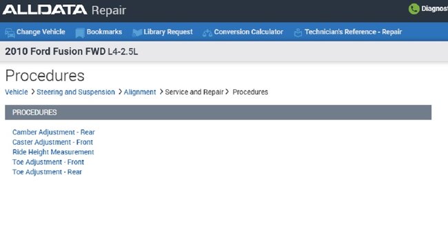

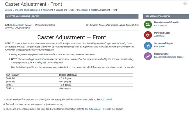

The second image shows the available adjustment instructions for your model, and front camber is not listed. That is a major shortcoming that Ford is very well known for. Their answer, if camber needs to be corrected, is to replace bent parts. I won't share what my friend at the local Ford dealership does to correct pulls, but it does keep his customers satisfied, for now, until other parts wear out prematurely. (One trick is to let some air out of one tire).
I apologize if some of this sounds technical, but my reason for describing these things has to do with the rest of the specifications. Remember, we always want camber to be slightly higher on the driver's side. Besides the exact spec., they allow a tolerance of 0.75 degrees either way, (blue arrows), on each front wheel. That means camber on the left wheel could be -0.50 degrees and still be in specs. If all an inexperienced alignment mechanic knew to look at was the color of that reading on the computer screen, it would be in green, meaning it's okay. That tire now wants to pull to the right by quite a bit. Likewise, the right wheel could be set to positive 0.50 degrees and be in specs, and in green. It will also cause a hard pull to the right. This is a case of there's a total difference of 1.00 degree pull to the right and all the numbers on the screen are green. We can never go just by the color of the numbers. We have to understand what each tire will want to do, but we have to look at both of them together.
A Ford instructor explained this in more detail, and it can apply to other manufacturers. They know a tolerance of 0.75 degrees is too much, but they're relying on our experience to know that and to not take advantage of it. We still want to get those adjustments as close as possible to perfect. The reason for publishing those very high tolerance values is as long as a car's numbers fall within that range, they will not pay the dealer to perform an alignment under warranty. That means it's up to the car owner to figure out the solution and to pay for it after the car is out of warranty. That's an extremely common trick GM likes to pull.
Related to this, every alignment computer has a button to "reduce tolerances" that we can use. That doesn't change any important numbers. All it does it force us to get an adjustment closer to perfect before it turns green. Even that can still leave us with a pull if we don't understand what those numbers are telling us.
That brings me back to the adjustments. I don't have an explanation as to why they don't provide a camber adjustment, but you will also run into that on many import models. The third image shows how they want us to correct a pull. That is to replace one or both upper control arms with ones that are offset a little to increase caster pull against the pull. Remember, caster on most vehicles doesn't cause a pull, and on those models where it does, caster only has half the effect on a pull as does camber. If both arms are replaced, we can gain or lose 0.80 degrees of caster pull which equates to a change of 0.40 degrees of camber pull. While that can be significant, what if it isn't enough?
The next problem is the mechanic has to perform the alignment, determine the need for one or both replacement control arms, order them, have you come back a second time to have those parts installed, then align the car a second time. It's even likely the dealer won't have those parts in stock. Ford is also famous for not having replacement parts available for vehicles over three years old. If you go to an auto parts store, how do you know if you're getting an aftermarket part that is like the original or it has that offset built in? This is usually a one-time modification, usually done under warranty, and even then the parts usually have to be special-ordered. In other words, after this many years, there may be no way to correct camber.

For my final comment of value, I mentioned that caster can also be used to offset road crown. If you look at the red arrows in the first image, you'll see they're specifying slightly higher caster on the right front wheel. For anyone who does get a printout or is able to see the computer screen, these four values for camber and caster will never ever be exactly as shown on this list. When we do have adjustments available, it is a very tedious process to nudge one close to where we want it, then it becomes even more tiring to tweak all four so as a group, they will give good tire wear with no pull. One car will end up with a little more camber on one wheel and a little more caster to offset it. Besides being within the tolerance range, we take what we get when those four numbers say the car will go straight.
Hopefully that gives you some more ideas, but the first things are to recheck the alignment, and switch the front tires side to side. Ask if they can give you a printout of the alignment too. I can interpret the numbers for you. Let me know how this turns out, then we'll figure out if we need to look further.
