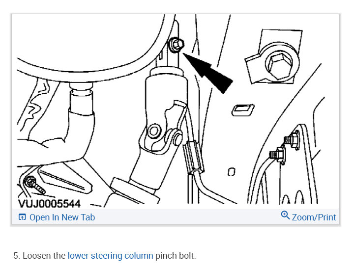

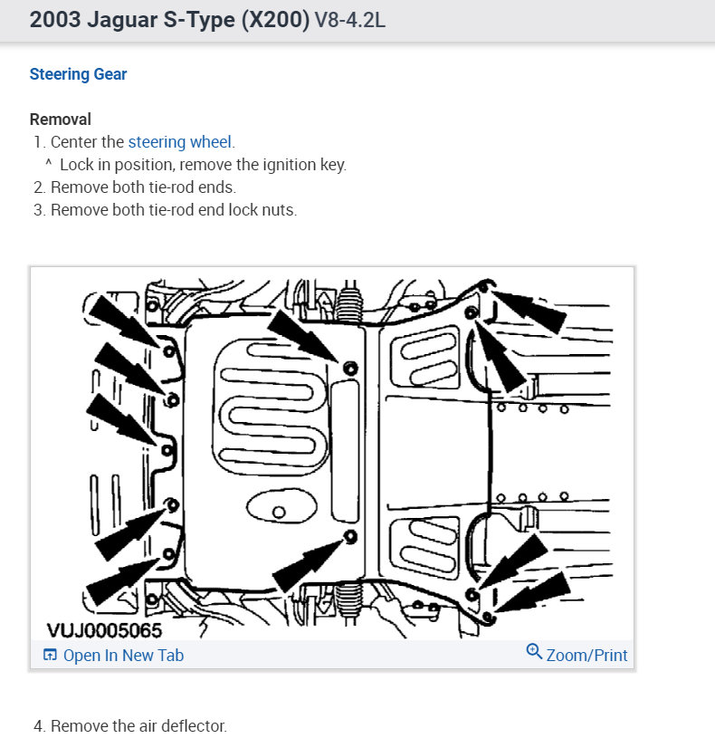

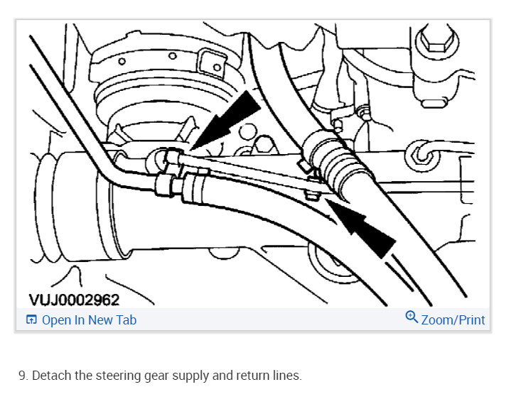

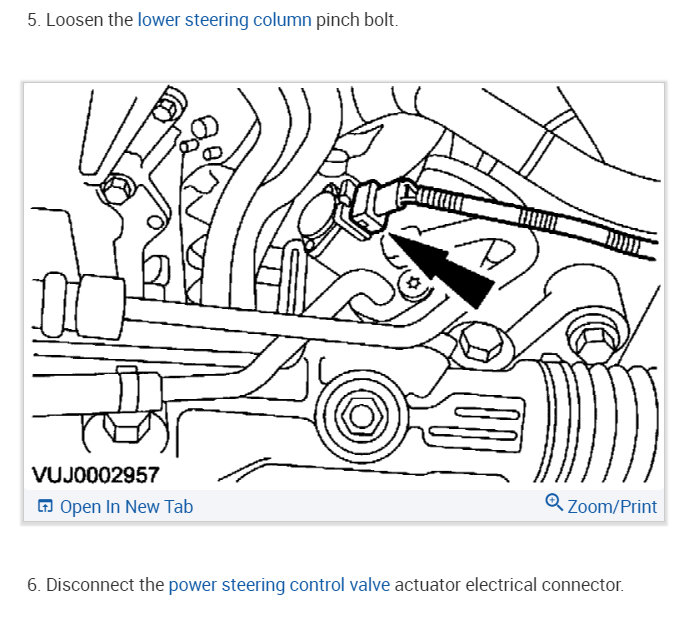

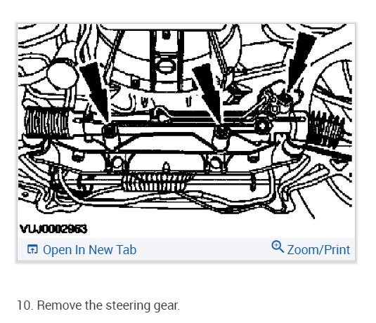

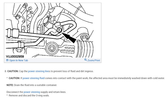

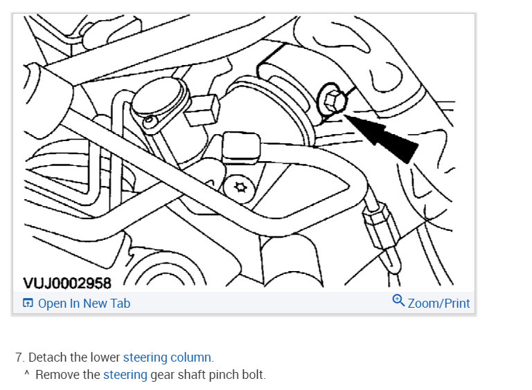

If I can jump in here. If the rack is bad it will need to be replaced. here are the diagrams and instructions to do so below. If it is a hose issue here is a video that will help you step by step to change it out. It is on a different car but the process is the same.
https://youtu.be/BGBUv5r9fk0
Mar 13, 2019 at 4:42 PM
