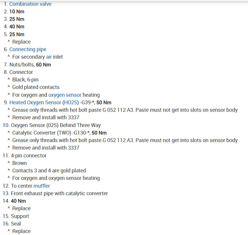

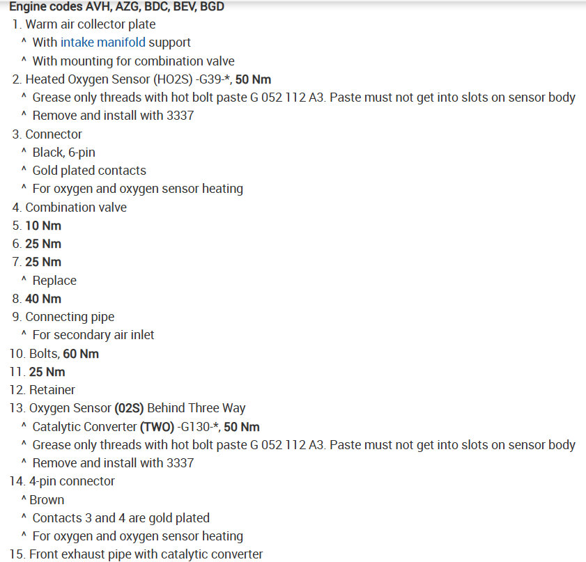

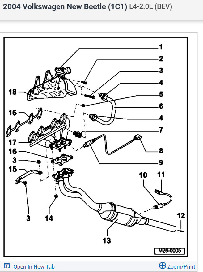

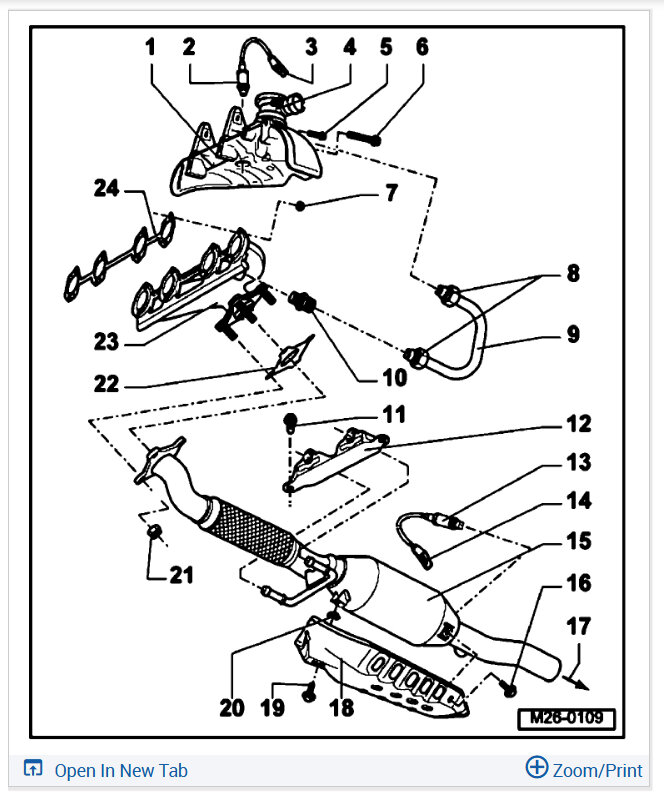

This video can help:
https://www.youtube.com/watch?v=1Hh12_mWw8k
Check out the images (below). Please upload pictures or videos in your response of any problems so we can see what to help you with.
