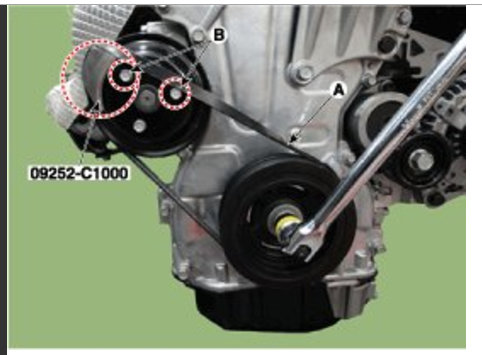

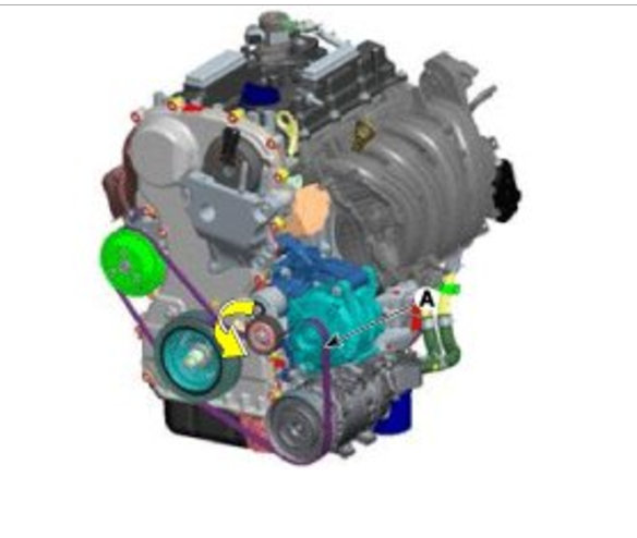

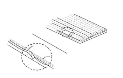

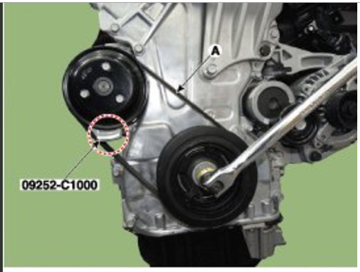

It sounds like you have a serpentine belt that needs to be replaced because it has started to glaze over. Here is a guide and a diagram to help you fix the car:
This will give you an idea on what you are in for when doing the job.
https://www.2carpros.com/articles/replace-serpentine-belt
Please let us know what happens so it will help others.
