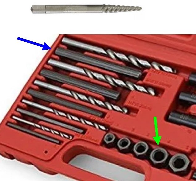

If I had one break, what I would do first is heat the remaining threaded part up with a hot air gun, then use a broken bolt extractor to grab the piece and try to turn it. There's at least three different types of bolt extractors. The most common style might get the job done, but it is going to expand the part more as it is screwed in further. That's the style shown in the top of the photo. The type I prefer is shown in the lower part of the photo. The blue arrow is pointing to one size in the set. It's a straight metal stick with grooves cut into it. You tap the right one in and it cuts matching grooves. This will go into plastic very easily, but if the plastic is that brittle that it broke, this tool might just cause it to crumble even more.
Once the shaft is tapped in, you use one of the collars, (light green arrow), to turn it with a wrench or socket. This set can be harder to find. If you have to resort to this drastic measure, start by looking for the set at an auto parts store that rents or borrows tools. In my city they make you buy the tool, then you get a full refund when you take it back. If you choose to keep a tool, you still take it back, then they give you or order you a brand new one.
