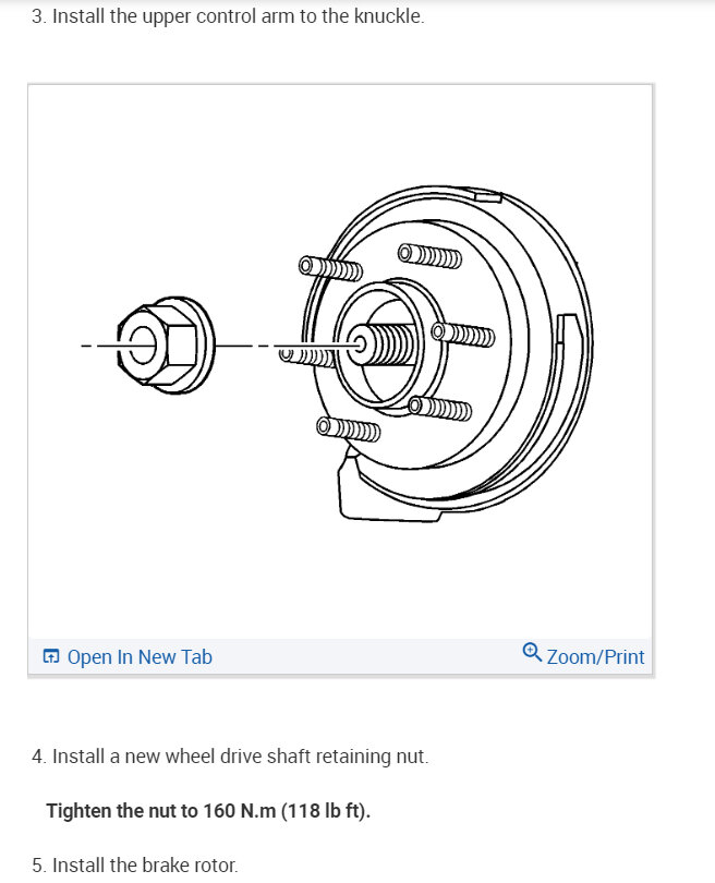

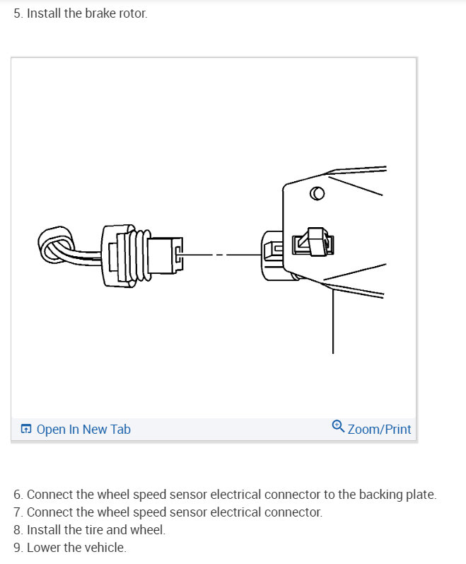

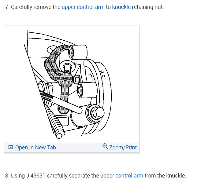

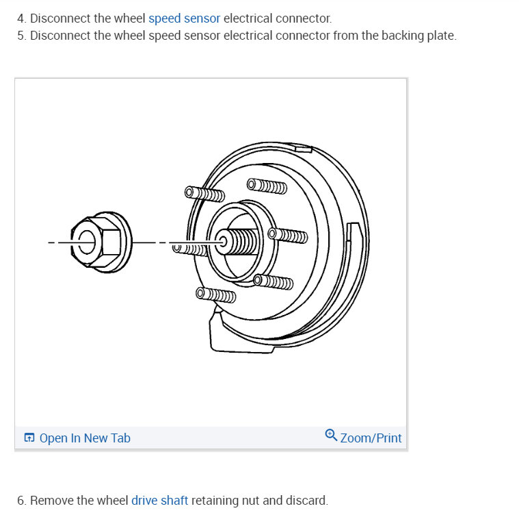

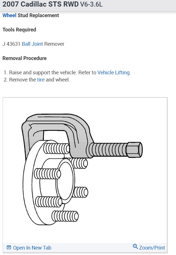

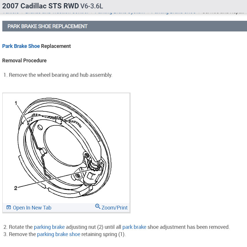

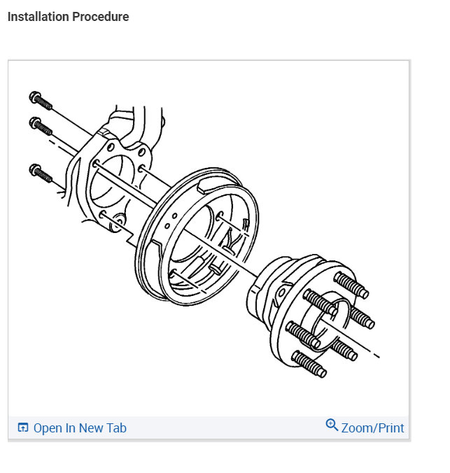

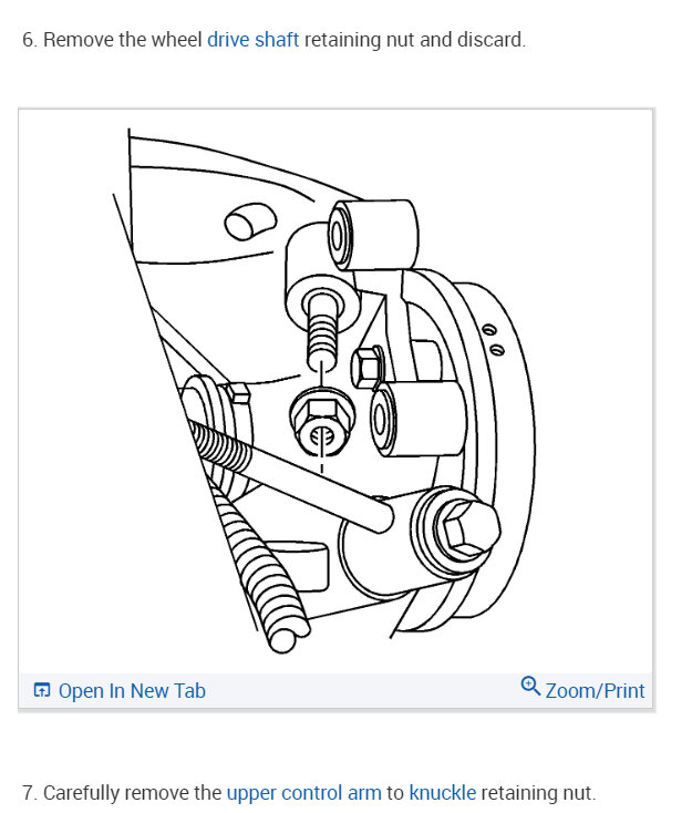

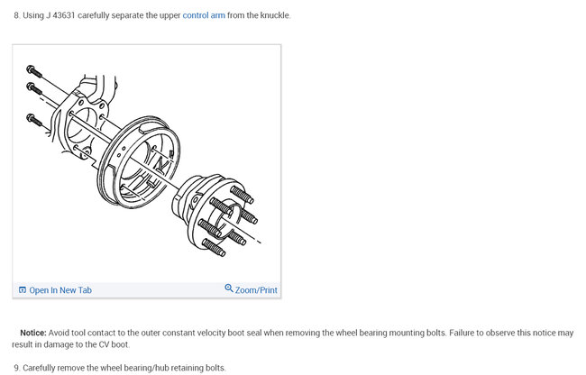

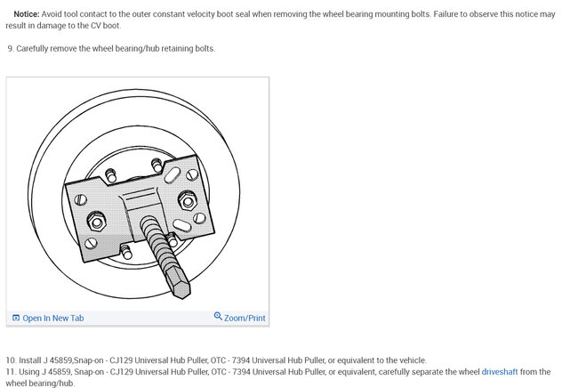

Most of the time a wheel stud is the same to replace on all cars, this video will help show you how and I have included instructions for your car in the images below.
https://youtu.be/LSZ8P0wrQX8?si=lN-QHmy29r41R6ms

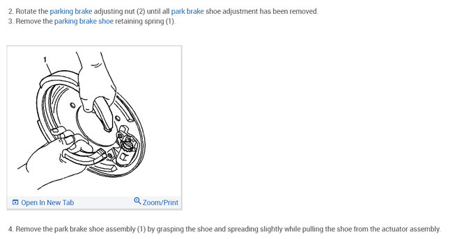

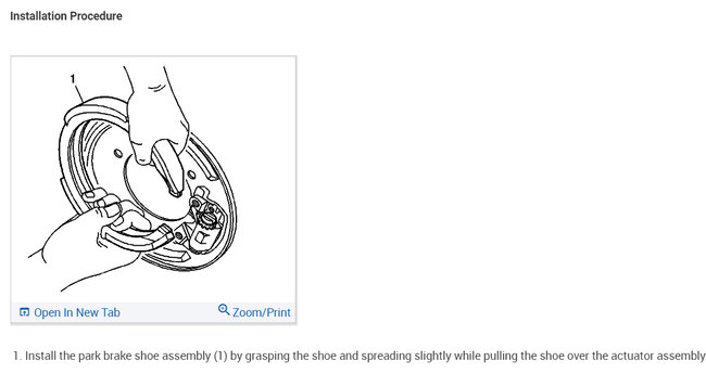

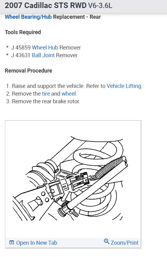

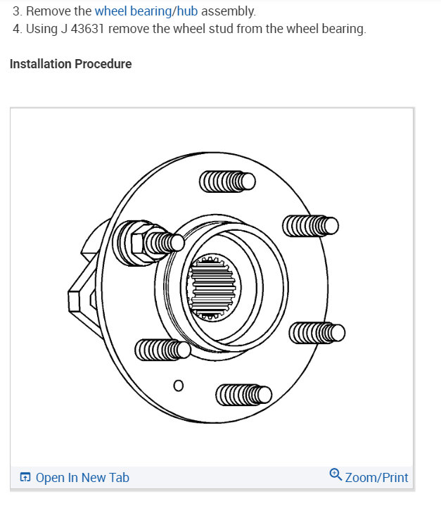

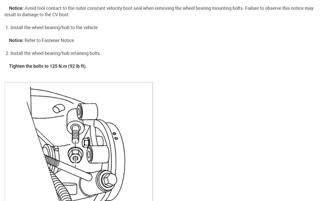

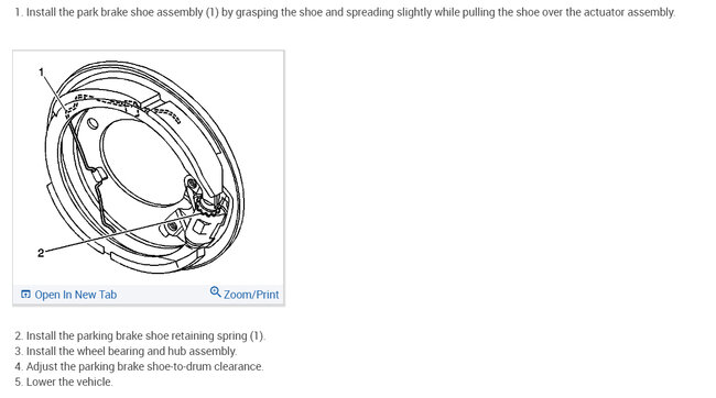

It looks like you may not be able to replace the stud on the car and will need to remove the wheel bearing hub. Here are the instructions for doing that as well. You may be able to remove the ebrake show to gain access to the stud. Check out the images (below). Let us know what happens and please upload pictures or videos of the problem so we can see what's going on.
