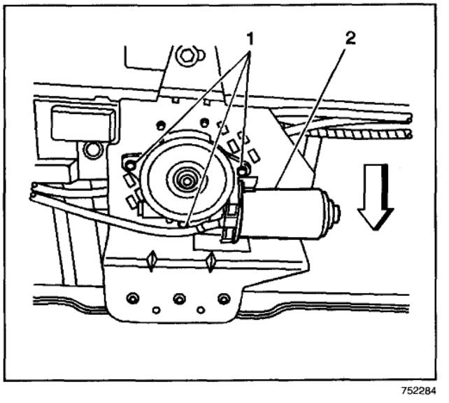

my sunroof is stuck in the upper position.
Jul 6, 2017 at 3:31 PM
It sounds like the motor lost power is has gone out. Here is a guide to help you see if the motor has power and a diagram (below) to show you where the motor is, also check the fuses.
and
Please run this test and get back to us we are interested to see what it is.
Jul 9, 2017 at 12:21 PM
BIGGS
  • 16 POSTS
thanks for your help, the motor is working so i removed the glass and the tabs were out of the track due to them being broken i managed to lower the lift arms by disconnecting them from the framing replaced the glass in its downward position now it is loose so now it leaks looks like i need to get the new kit to fix it right, but at least its down for now and didnt need to remove the headliner.
