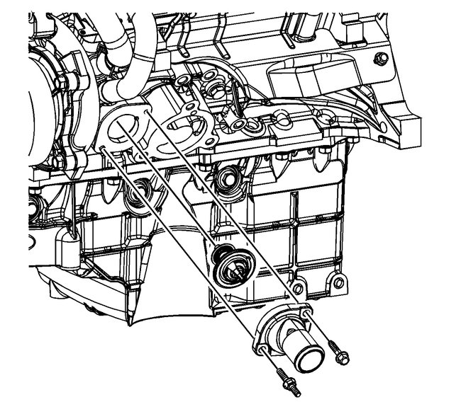

Here are the directions for replacing the thermostat. The attached pics correlate with the directions.
2009 Pontiac G6 V6-3.5L
Removal and Replacement
Vehicle Engine, Cooling and Exhaust Cooling System Thermostat Service and Repair Removal and Replacement
REMOVAL AND REPLACEMENT
Engine Coolant Thermostat Replacement (LZ4/LZ9) (3.5L, 3.9L)
Removal Procedure
pic 1
1. Drain the cooling system. Refer to Cooling System Draining and Filling (LY7, LZE, LZ4, LZ9) (See: Cooling System > Removal and Replacement)Cooling System Draining and Filling (GE 47716 Fill) (See: Cooling System > Removal and Replacement)Cooling System Draining and Filling (LE5 Static Fill) (See: Cooling System > Removal and Replacement).
2. Remove the air cleaner outlet duct. Refer to Air Cleaner Outlet Duct Replacement (See: Air Cleaner Fresh Air Duct/Hose > Removal and Replacement > Air Cleaner Outlet Duct Replacement).
3. Reposition the radiator outlet hose clamp at the thermostat housing.
4. Remove the radiator outlet hose from the thermostat housing.
pic 2
5. Remove the thermostat housing bolt/stud.
6. Remove the thermostat housing and gasket.
7. Remove the thermostat.
8. Clean the gasket surfaces.
Installation Procedure
pic 3
1. Install a NEW thermostat.
2. Position a NEW gasket and the thermostat housing to the engine block.
Caution: Refer to Fastener Caution (See: Vehicle > Vehicle Damage Warnings > Fastener Caution).
3. Install the thermostat housing bolt/stud.
Tighten the bolt/stud to 10 Nm (89 lb in).

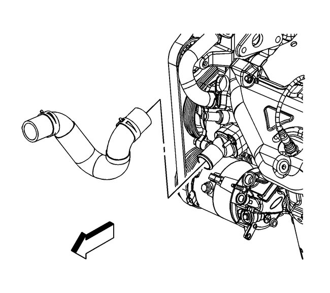

pic 4
4. Install the radiator outlet hose to the thermostat housing.
5. Position the radiator outlet hose clamp at the thermostat housing.

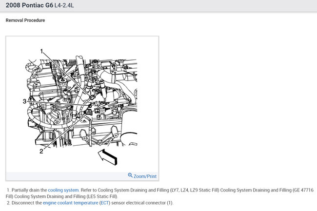

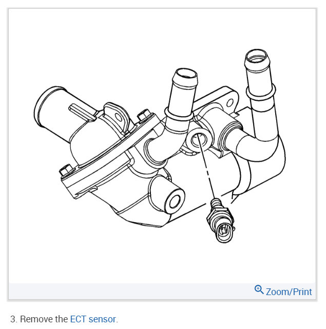

I recently had an issue where my check engine light came on and it was showing that it was the temperature sensor so I got it replaced. Everything was fine. Soon after I changed the radiator because I accidentally made a hole in it by running over something. Everything was fine again. About a week after my check engine light came on, the temperature gauge stopped working, the A/C stopped blowing cold air, and the fans started running on high. This time the code was showing that it was the thermostat not working. I got that replaced. Everything was fine. A few days later the same thing happened again. This time I just disconnected/reconnected the battery and everything started working fine. That was a few days ago and today the same thing happened again only this time the temperature gauge is at 0 even after disconnecting/reconnecting the battery and A/C is not blowing cold air. Could somebody please help me out?
Nov 12, 2020 at 10:26 AM (Merged)
It sounds like the engine coolant temperature sensor is out again causing the problems you are describing. When it was replaced did you use OEM parts? Here is a guide to show you what you are in for when doing the job and the location of the sensor for your car:
https://www.2carpros.com/articles/coolant-temperature-sensor-cts-replacement

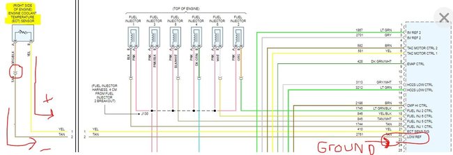

The coolant gage quit working. I have to remove the hot wire off of the battery to get the coolant temperature to keep working. After a while the coolant temperature quits working. than the cooling fans come on and never shut off at all. Do I have to replace the coolant temperature gage. Or do I have to replace coolant gage sensor to make the gage able to work again. Or could it be a problem with a model or just a dirty sensor wire connection?
RASMATAZ
  • 75,992 POSTS
Inspect and test the coolant temperature sensor.
