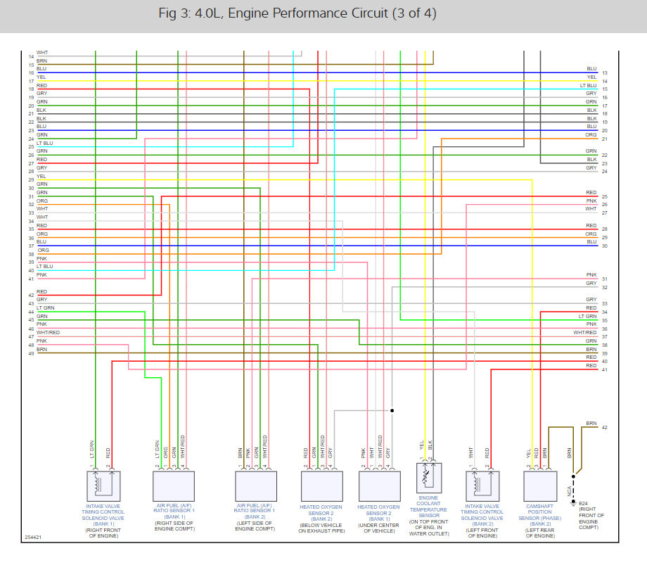

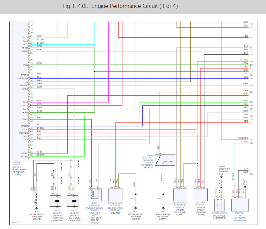

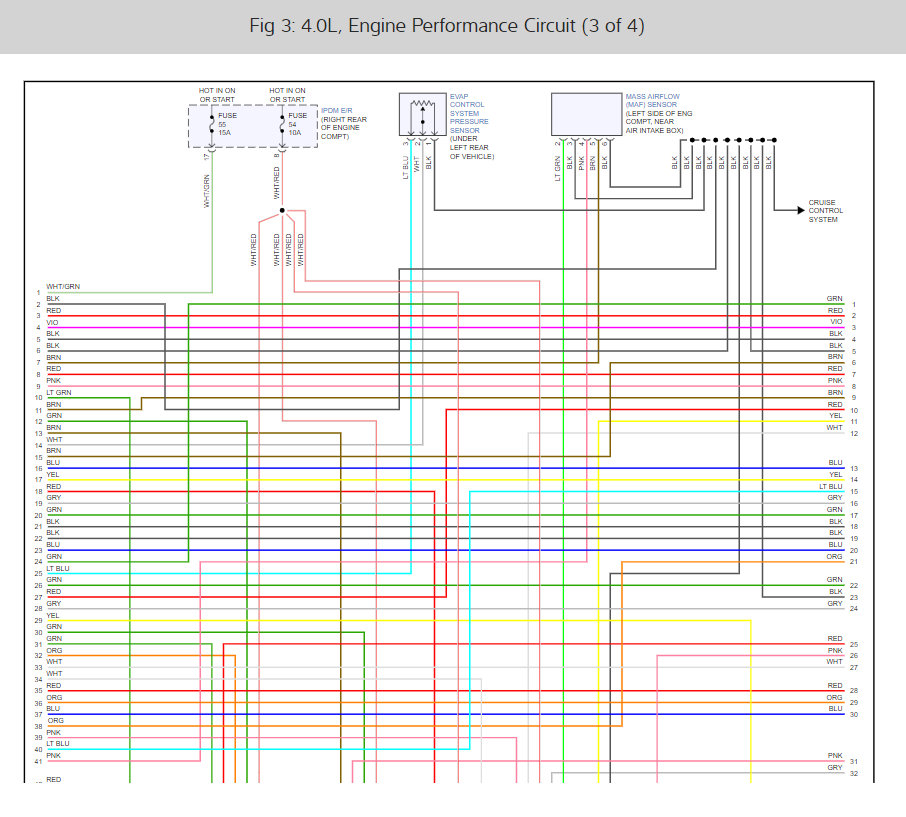

Here are the engine wiring diagrams which feature the coolant sensor wire colors and a guide to help you test the wiring once repaired:
Check out the diagrams (below). Please let us know if you need anything else to get the problem fixed.
