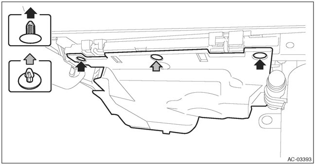

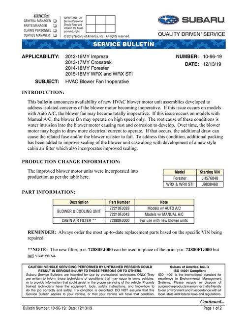

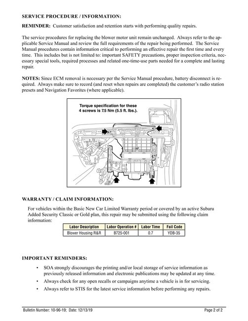

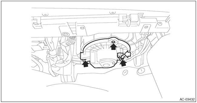

There is a service bulletin for this condition. See images below. There is water intrusion causing corrosion and making the blower motor to work harder until it burns out. There is an updated blower motor with cabin filter you need to replace. The updated parts have better insulation. Here are the instructions with images. Also the bulletin has the updated part numbers.
REMOVAL
 1. Disconnect the ground cable from battery.
 2. Release the clips, and remove the under cover assembly - passenger.
 3. Remove the blower - motor.
    1. Disconnect the connector.
    2. Remove the screws and detach the blower - motor.
INSTALLATION
Install each part in the reverse order of removal.

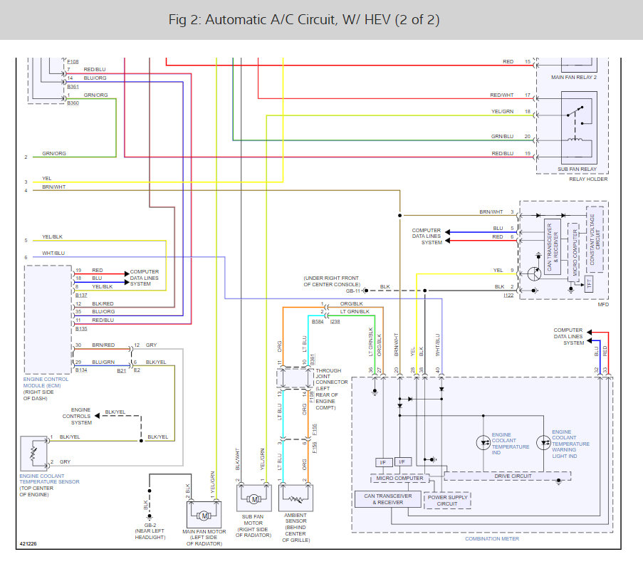

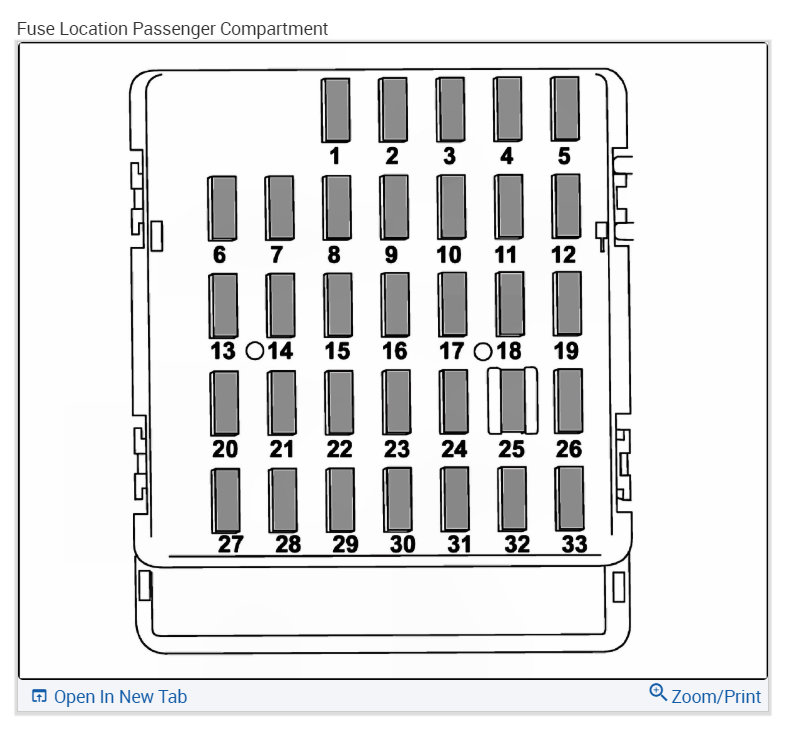

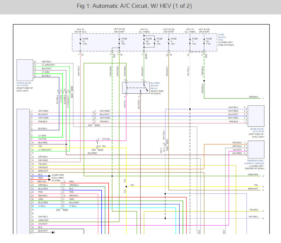

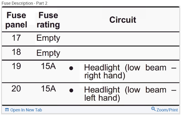

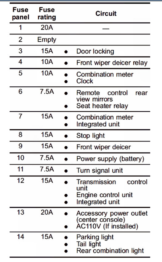

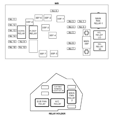

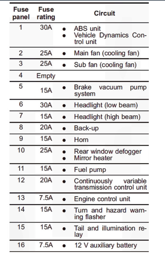

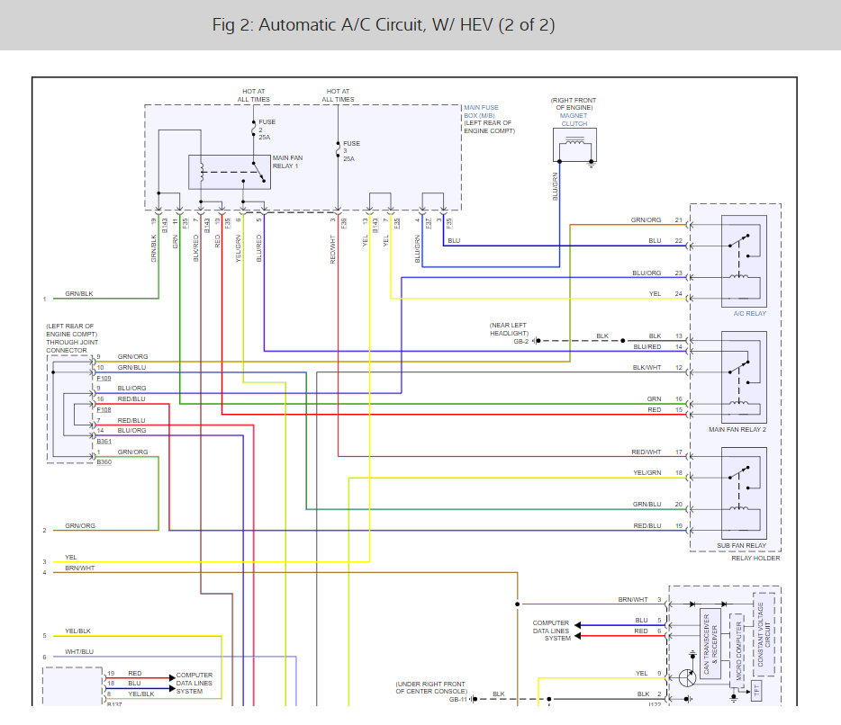

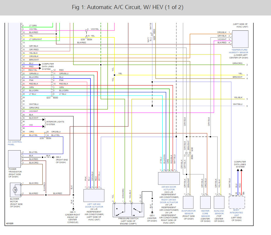

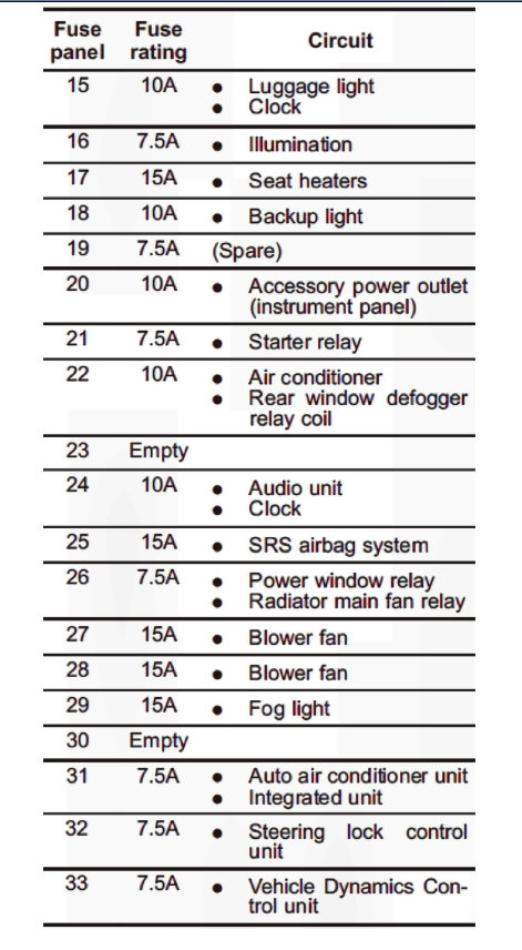

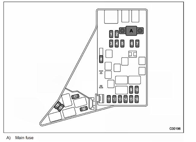

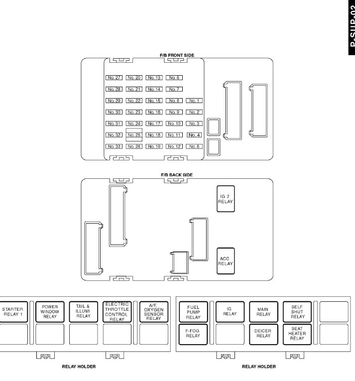

There are 7 fuses that run the system. here is a guide to help you check for power and the fuse location with the HVAC wiring diagrams so you can see how the system works with the fuses that need to be checked:
