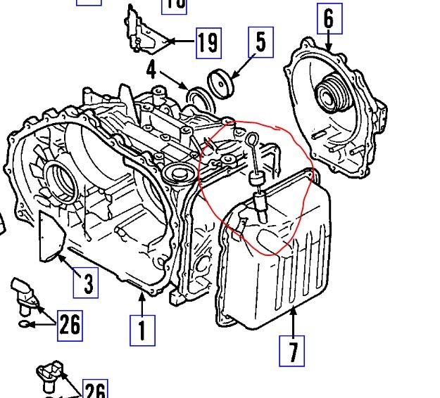

Good morning,
I attached a picture for you to view of the location.
It is right by the cover for the valve body on the side of the transmission.

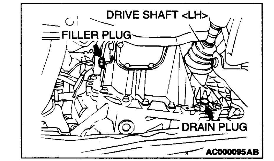

Sorry, senior moment.
I attached a picture of the drain plug and the fill plug as well for you.
Change oil
1. Remove the filler plug.
2. Remove the drain plug and drain the oil.
3. Tighten the drain plug to the specified torque.
Tightening torque: 32 ± 2 N.m (24 ± 1 ft-lb)
4. Fill with Hypoid gear oil SAE 75W-90 or 75W-85W conforming to API classification GL-4 until the level comes to the lower portion of filler plug hole.
Quantity:
[2.4L Engine> 2.2 cu.dm (2.3 quarts)
[3.0L Engine> 2.8 cu.dm (3.0 quarts)
5. Tighten the filler plug to the specified torque.
