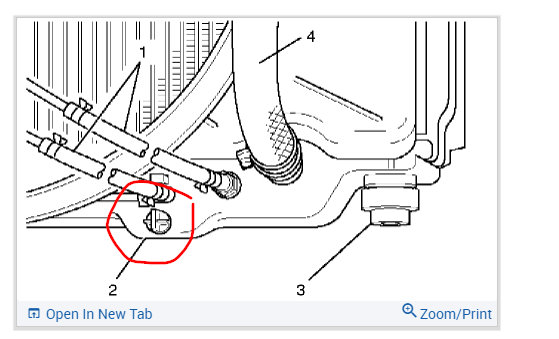

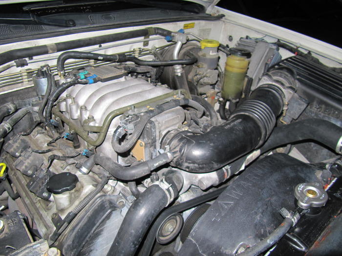

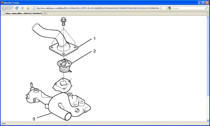

We can't find the thermostat where we can replace it.
Mar 29, 2019 at 6:39 PM
JOETECHPRO
  • 705 POSTS
Hey ILOVEYOU1962,
On this engine it looks like the thermostat is in a housing connected to the lower radiator hose.
Follow the lower radiator hose and you should see a housing as in the picture attached to this message.
Hope that helps.
Regards, Joe

There you go.
Oct 7, 2020 at 12:51 PM (Merged)

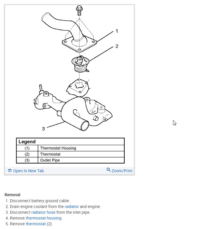

RASMATAZ
  • 75,992 POSTS
Removal
Disconnect battery ground cable.
Drain engine coolant from the radiator and engine.
Disconnect radiator hose from the inlet pipe.
Remove thermostat housing.
Remove thermostat (2).

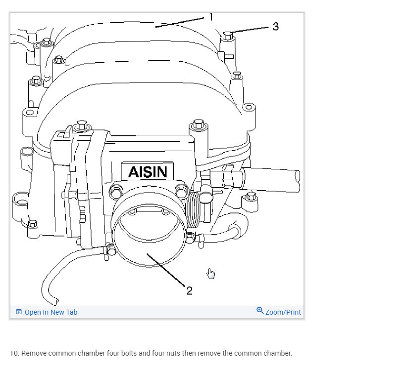

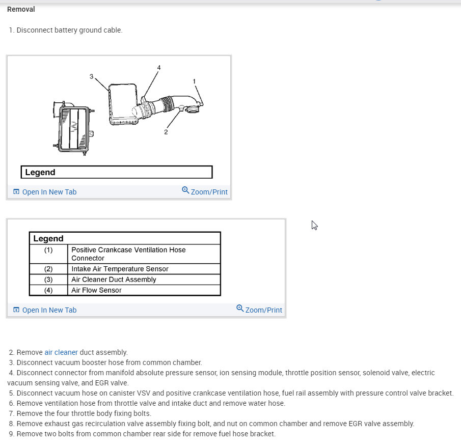

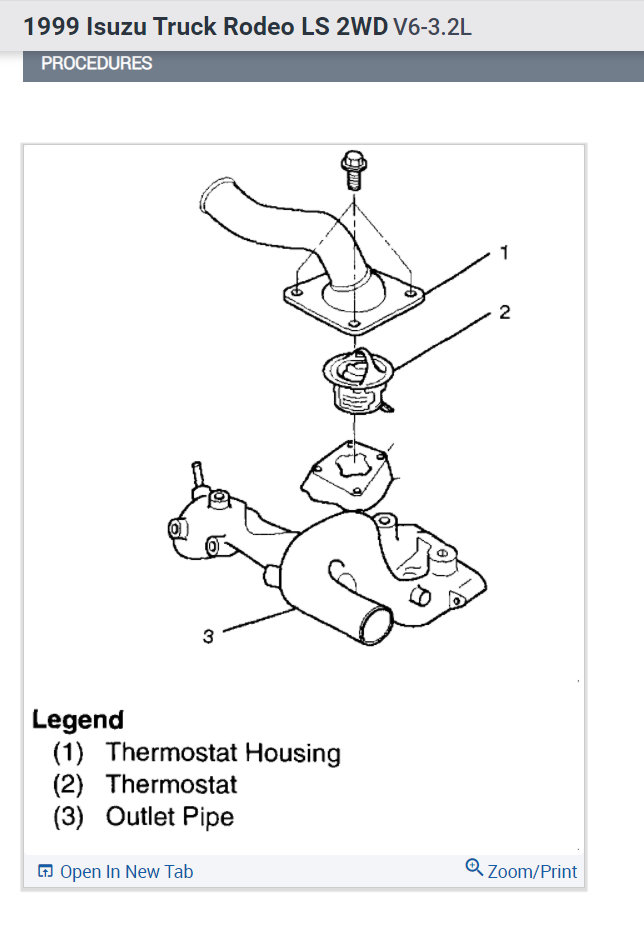

Hi Bonnie,
Here is the service procedure from the manual for your vehicle. Unfortunately, manuals of this age tend to leave out some pretty big steps because they are intended only for technicians who know the steps prior to getting to the point of remove the actual thermostat.
The steps that are missing from this procedure are that you need to remove the intake manifold. Not a simple task. Here is a video that shows briefly what it looks like to do this:
https://youtu.be/bzGyVliYlig
I would not recommend anyone perform this if you are not familiar with this engine because it is not the easiest thing to do. Please let me know if you need more information. Thanks
FYI - each attachment is labeled. The fourth one just shows where the drain plug is on the radiator.

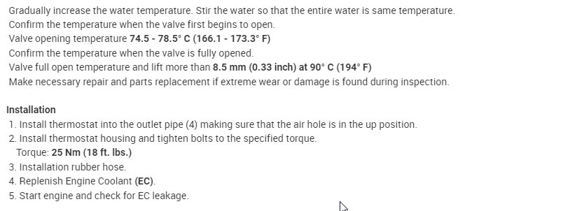

Here is a guide that will walk you through the steps
Install the thermostat into the outlet pipe (4) making sure that the air hole is in the up position. Install thermostat housing and tighten the bolts to 18 ft. lbs. (25 Nm).
Attach the radiator hose to the inlet pipe. Refill the engine with the proper type and amount of coolant. Connect the negative battery cable. Start engine and check for coolant leakage.
Cheers

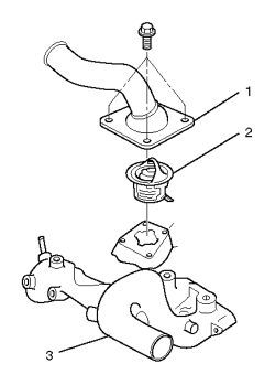

JESSICASHARP

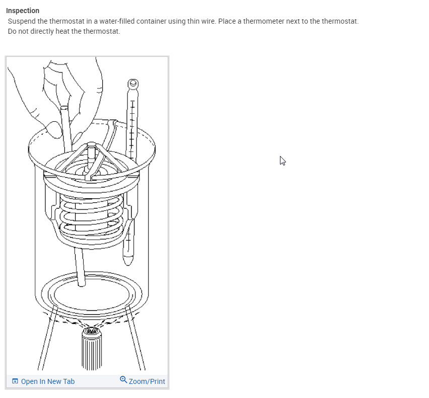

I need help in replacing the thermostat. It is in a difficult place and I just want to know the step-by-step instruction and a diagram would be very helpful too. It seems to be in the engine block and I think the top of the engine block might need to be removed to get to the thermostat.
Oct 7, 2020 at 12:52 PM (Merged)
KHLOW2008
  • 41,814 POSTS
Here is a guide to help walk you throught he steps with the instruction in the diagrams below to show you how on your car.
THERMOSTAT
Removal
Disconnect battery ground cable. Drain engine coolant from the radiator and engine. Remove throttle body. Disconnect radiator hose from the inlet pipe. Remove thermostat housing. Remove thermostat
Install thermostat into the outlet pipe making sure that the air hole is in the up position. Install thermostat housing and tighten bolts to 25 N.m (18 ft. lbs.). Installation rubber hose. Replenish engine coolant. Start engine and check for coolant leakage.
Check out the diagrams (Below). Please let us know what happens.

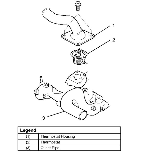

A666LEX
how do you replace the thermostat in a 1998 isuzu rodeo v 6 4 wheel drive 3.2 lit
RASMATAZ
  • 75,992 POSTS
Hey A666LEX
You should start by draining he coolant. Here is a guide to let you know what you are in for step by step and diagrams below to show you what is like on your car.
