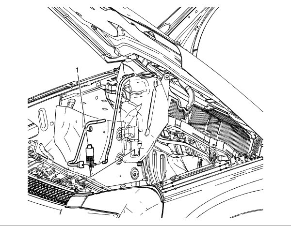

I just got done replacing the windshield washer tank and pump. I have the front spray nozzles working. But the rubber hose from the tank to the line running to the rear washer nozzle on the back hatch. The rubber hose is plug up with a screw because I cannot find the plastic tube in the engine compartment that the rubber hose is supposed to connect to. Is there anyone that can help me?

Usually a vehicle with front and rear nozzles will either have two pumps or if they use a single pump the pump will have two ports for the lines to connect onto.
The Torrent is the second style. There are two ports the rear and front lines connect right at the pump. Now if you mean you have those two connected but cannot find the hose that runs to the rear nozzles, They do not show that routing in the book because it is inside the actual wiring harness that runs through the dash and to the rear.
Look at the harness and you should find the tube.
