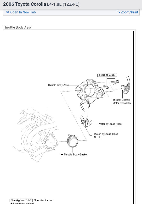

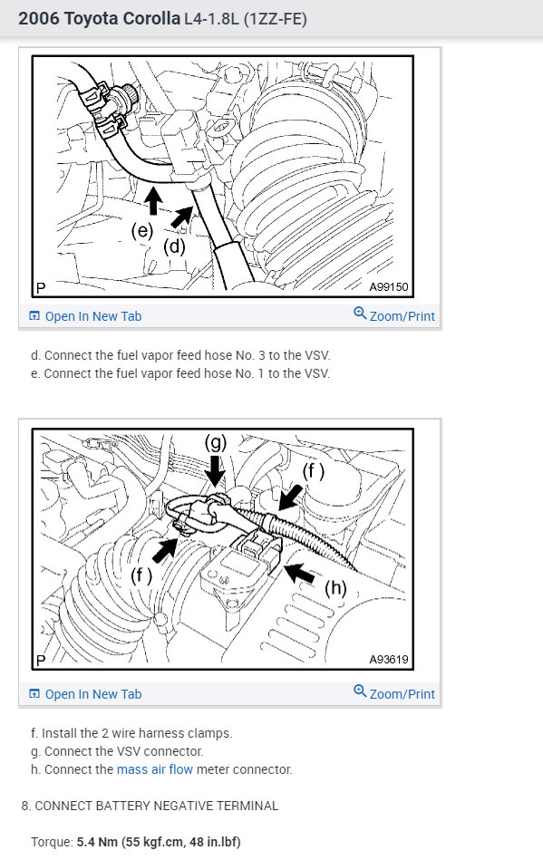

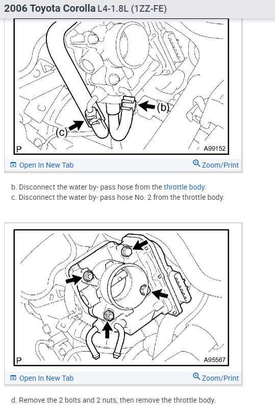

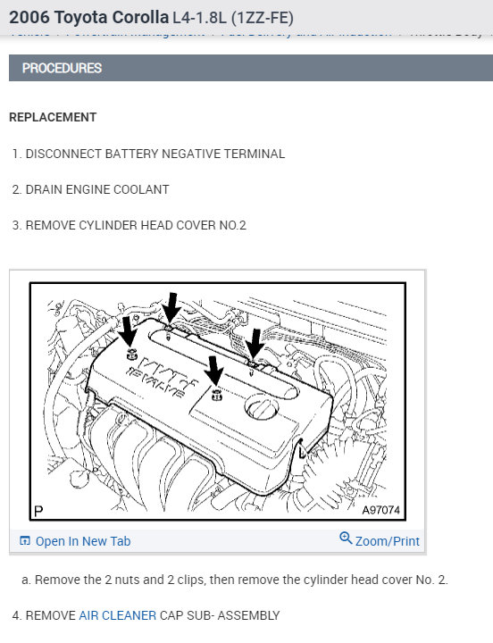

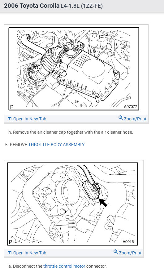

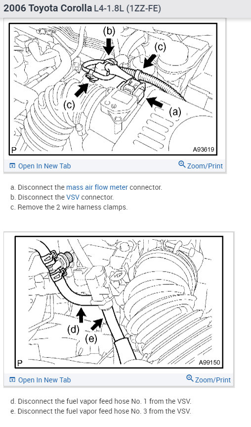

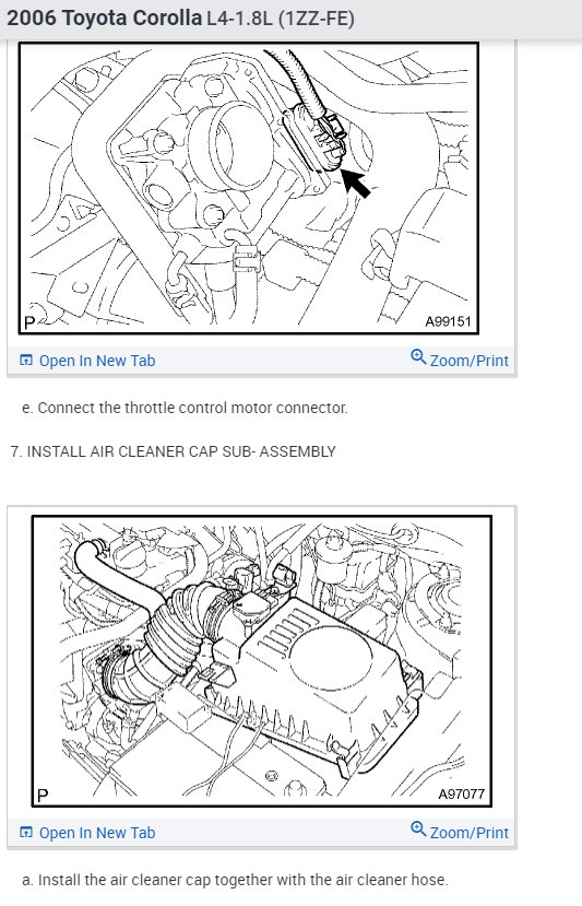

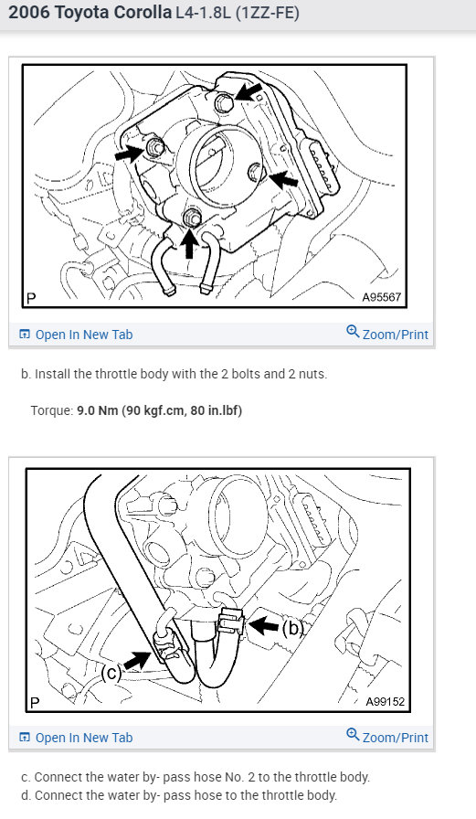

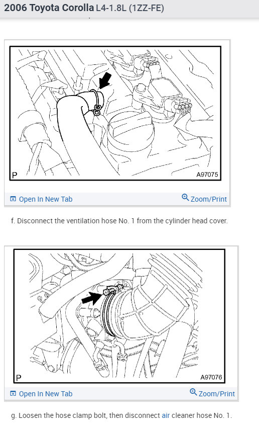

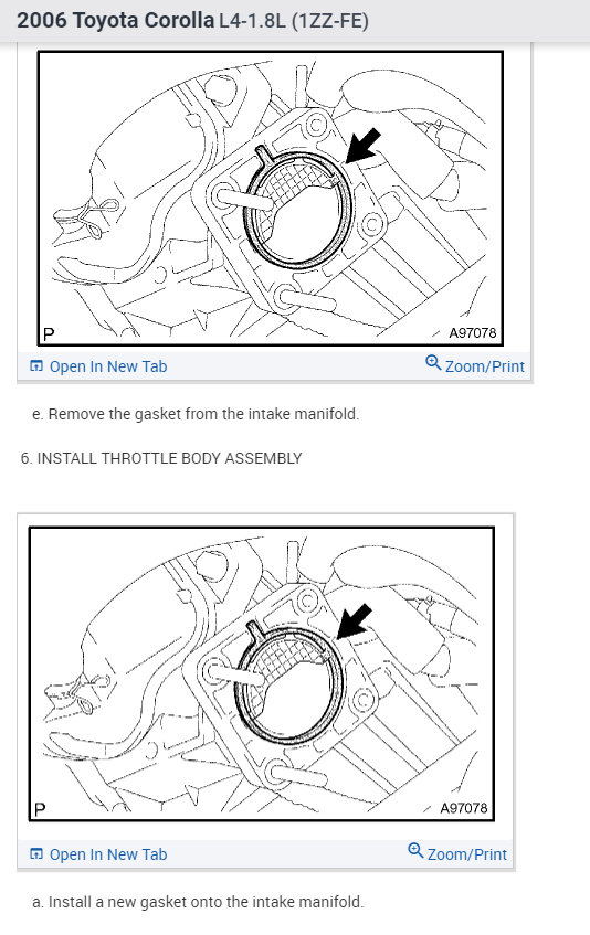

I have attached the throttle actuator removal process below for your reference.
Let me know of any questions.
Thank you.

Hello again, and thanks for the help as I'm disabled and not working with major medical issues. I need a little more info before proceeding. So, here are my questions:
1. I don't plan on taking the throttle body off. I'm going to clean it in place by removing snorkel hose out of the way.
2. Why does the battery need to be disconnected?
3. I need to make sure I don't damage the mechanism when manually opening the butterfly. When I move it all the way open will it stay there. Then after cleaning it should I put it back in the closed position before reconnecting the battery? I was told that there are gears that can get damaged if you force it open or get something out of calibration. If you open this electronic type, will you feel resistance of the gear mechanism and need to go really slow with it.

You want to disconnect the battery as if it is not disconnected it can mess with the programming of the throttle actuator.
As for the butterfly, it will spring back into the original closed position when you let go of it.
On this 2006 throttle actuator it will not damage anything when the bottlefly gets manually opened after the battery is disconnected.

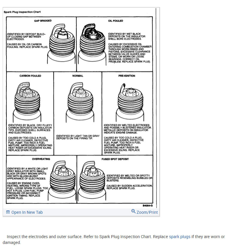

For the plugs you want to remove and inspect them. If they are in good condition, no need to change.

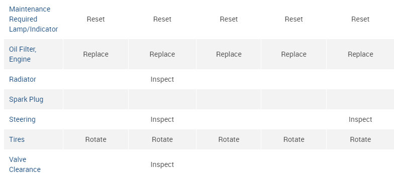

Thanks for the info but could you give me your recommended plug change mileage for the 2006 Toyota Corolla? Also, I don't think if I take them out and inspect them you could put them back in as the crush washer at the base has already been squashed.

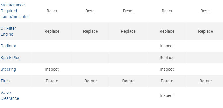

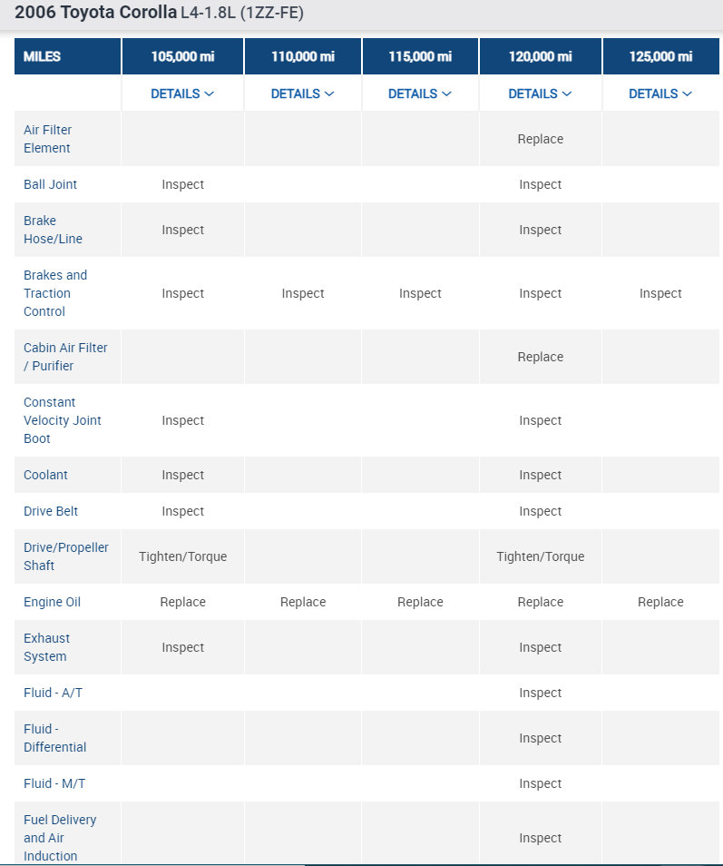

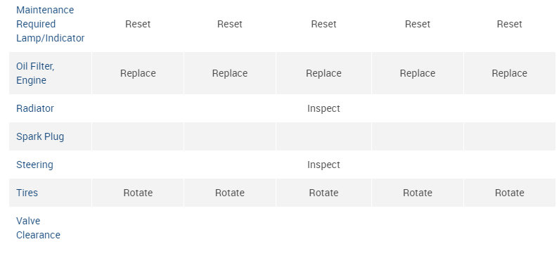

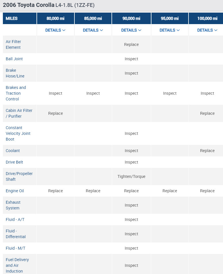

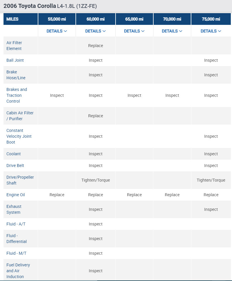

See attached for the maintenance timetable with the intervals. From 70,000 to 125,000 mileage.
Jul 15, 2022 at 10:27 AM
  • 117 POSTS
Unable to read. Was blurry.
Jul 15, 2022 at 11:43 AM
  • 117 POSTS

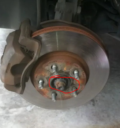

Never mind. Sorry it was my error. Could you tell me where to tighten the drive shaft bolt they are talking about? Picture please.
Jul 15, 2022 at 1:48 PM
SQM
  • 6,383 POSTS
For your vehicle it will be the axle nut that is for the CV shaft.
It should be torqued at 159 ft. lbs.
Jul 15, 2022 at 3:24 PM

Looking at the chart you sent me on 2006 Corolla spark plug change I believe it shows 120,000 miles. Is that correct? Also, I'm getting ready to clean throttle body with that cleaner. I was told just to spray a rag and wipe it but not to spray it in the opening. I remember having a 1997 Camry that gave me idle problems and there was a small slot that a Toyota guy told me needed to be sprayed. Does his 2006 also have that idle slot that needs spraying also? Thanks for the help. You guys are the best.
Jul 17, 2022 at 7:59 AM
SQM
  • 6,383 POSTS
Yes, it is 120,000 miles for the plugs.
