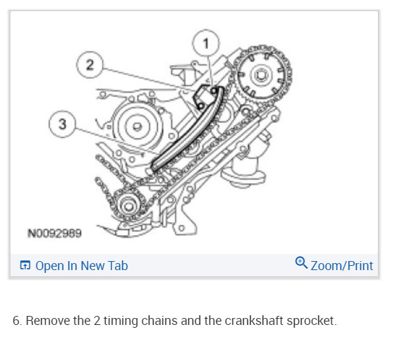

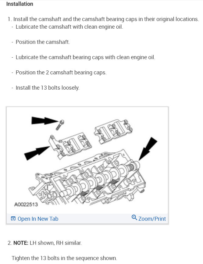

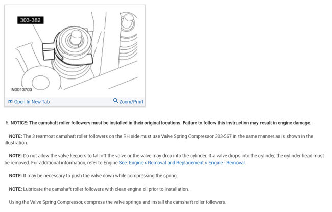

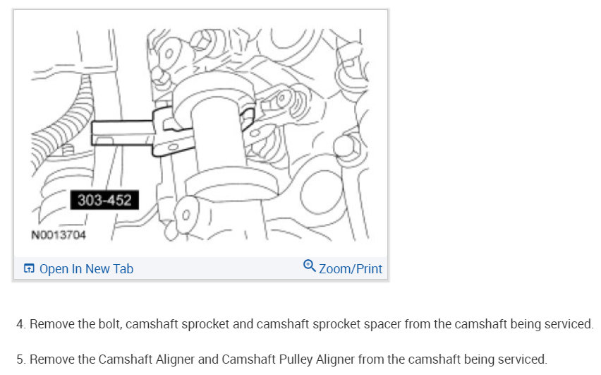

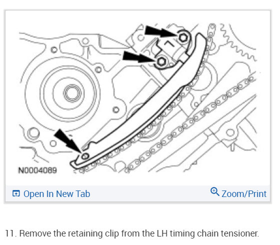

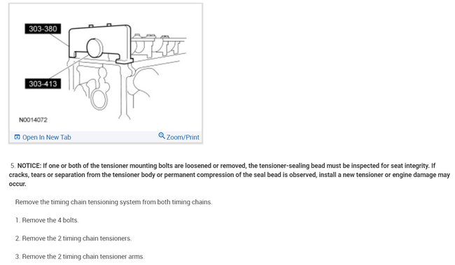

Lost my A/C on the way home from work. Popped the hood and found a big hole in my timing chain cover along with a broken belt. Don’t know what part number to replace the timing chain cover and timing chain?
Apr 24, 2019 at 5:24 PM
SCGRANTURISMO
  • 4,897 POSTS
Ouch! I have had similar things like that happen to me before. One time I got home from a friend's house, parked my Chevrolet Cobalt in the driveway, woke up the next morning and was going to run to the grocery store for some breakfast, and the vehicle would not start. Come to find out that somehow over night a timing chain tensioner had given way and when I went to start it, it jumped time. It has an interference engine it, and, to make a long story short, the junkyard gave me $100.00 for it, bent valves and all.

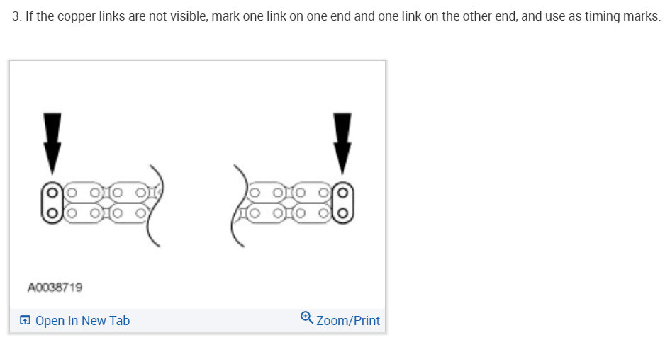

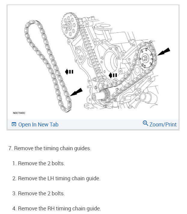

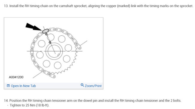

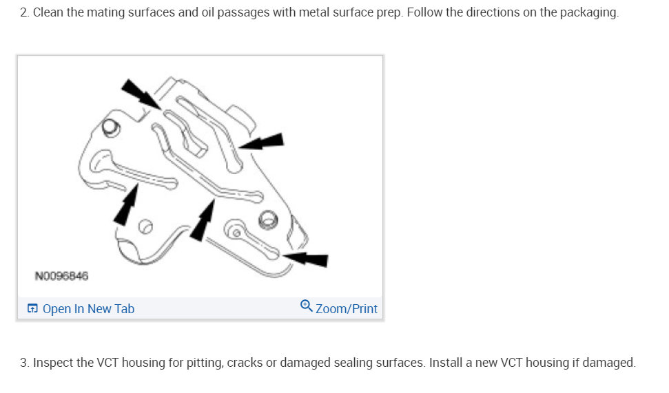

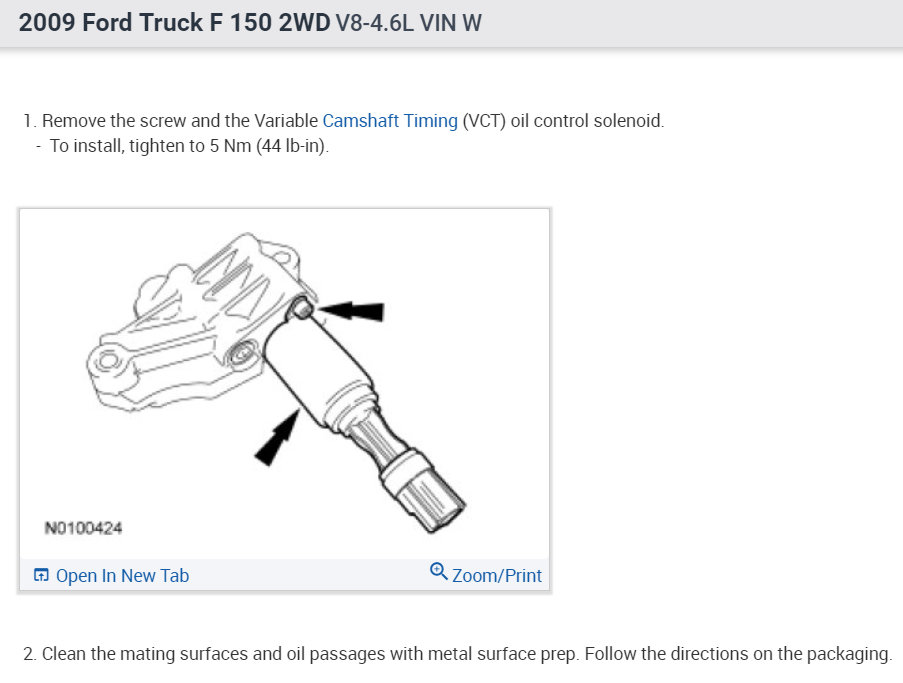

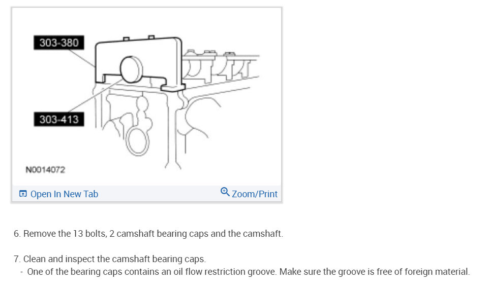

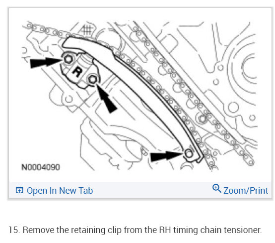

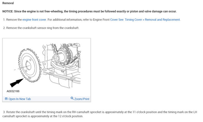

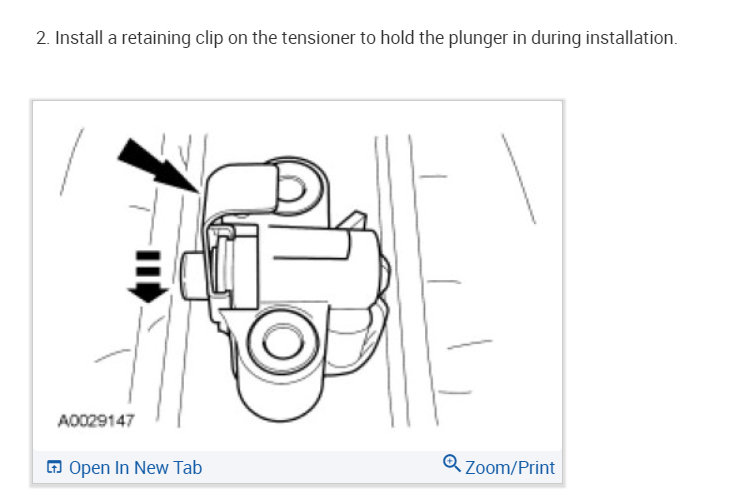

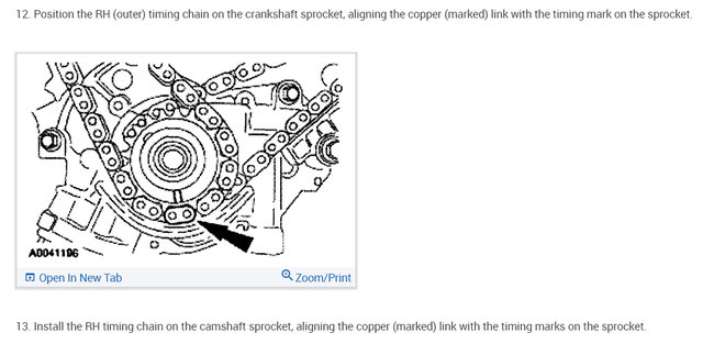

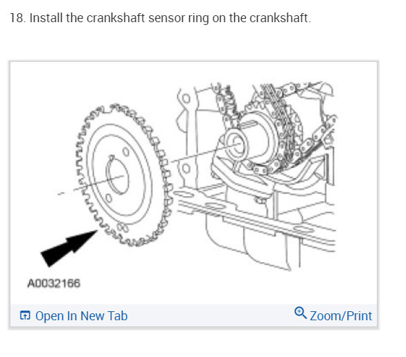

Anyways, I sympathize with you. I have included the information you requested in the diagrams down below. Please, don't hesitate if you have any other vehicle related questions. It's what we do. Check out the diagrams (Below). Please let us know if you need anything else to get the problem fixed. Thanks, Alex

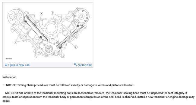

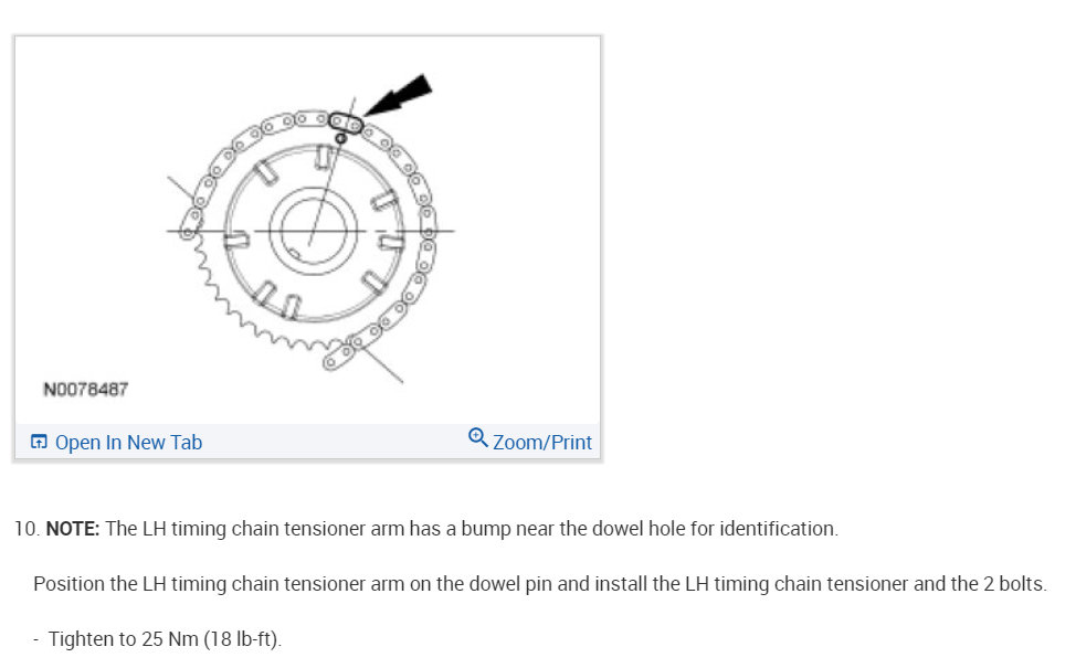

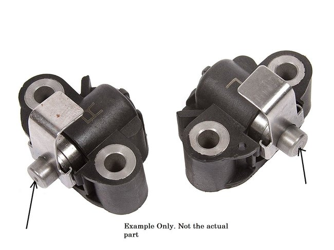

Doing timing chain replacement including guides and tension-er's. The new left side (driver side) tension-er does not have the small drilled port in center of plunger that is actuated by the HP oil system. Old one removed does have this opening. The new right side tension-er does have this opening. Assumed this was intended for oil flow or return. Checked 5 national auto supply chains and 2 Ford OEM dealers and none of the left side replacement tension-er have this opening in center of the plunger. Question, did Ford do a modification for this part and will the lack of this opening in the center of tension-er plunger effect performance?
Aug 22, 2020 at 11:11 AM (Merged)
Ford did do a modification to the tension-er which will not affect the performance, you are good to go.

I just did a timing chain, guide rails, and tensioners on my f150 5.4 lariot 2004. The front engine noise was a very distinct rattle at initial start up it is still there until the oil pressure builds then the rattle sound goes away. The tensioners do not seem to be holding oil pressure after the engine is shut off, they seem to be bleeding off, it takes about 20 min. of sitting.Iis there a check valve or a bleedback valve that is faulty that could be causing the tensioner to bleed off its pressure. The old tensioners were spongy when I removed them, I don't think the new ones are performing any different.

There are revised cam phasers for noise, as well as recommendations to pull the front cam cap and inspect oil feed line
also make sure you are using 5w20 oil and thicker oil can cause noise

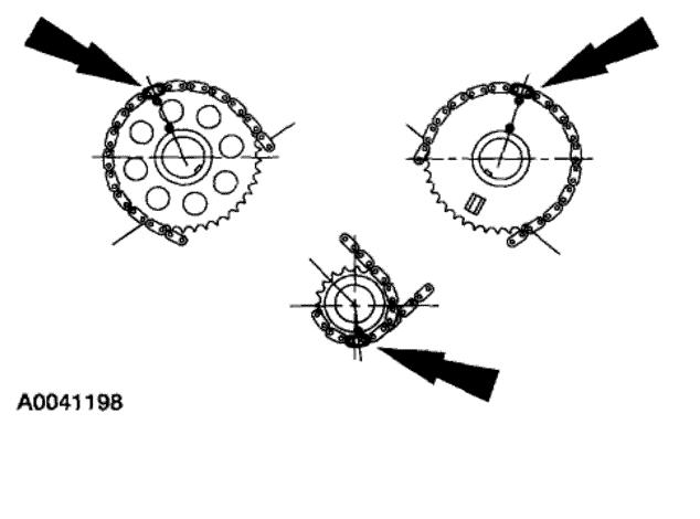

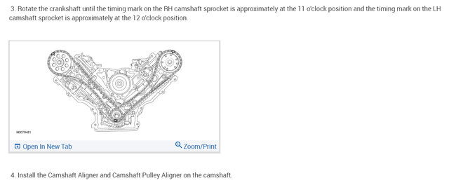

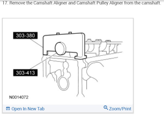

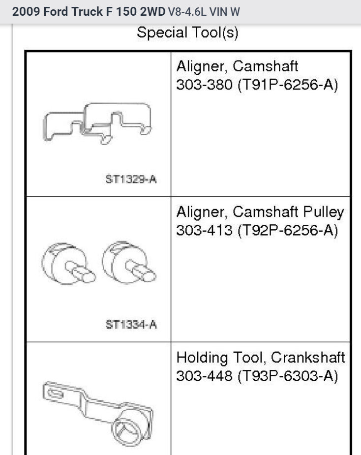

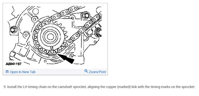

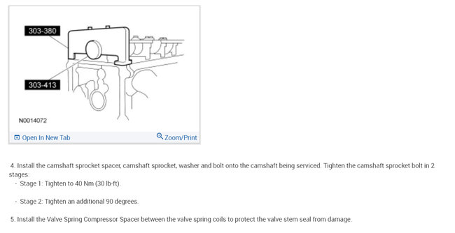

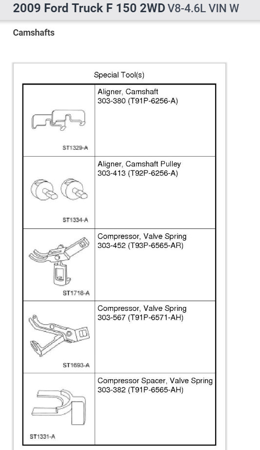

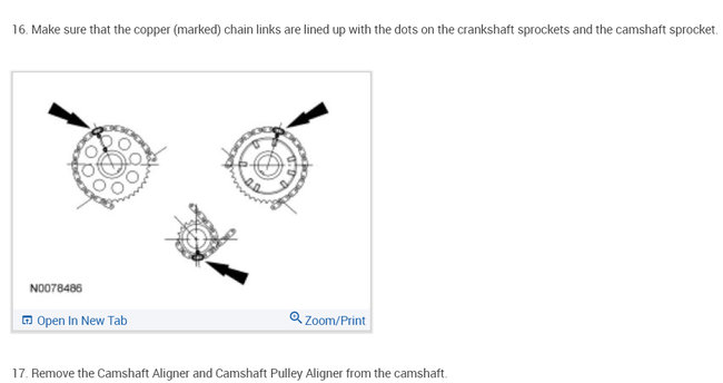

I have a 2003 f-150 lariat supercrew with the 4.6l triton. Long story short a lot of water in oil due to warped head. Had head resurfaced and shop took off the cam. The installed the cam back on the head when done. I 0ut the motor back together. Crank but no start symptom. I figured it's 180 out on timing so I tore it back apart and upon removing the timing cover and chain the passenger side cam/phaser turned. I tried to turn it and I get about 20 degrees either way and no more. I'm suspecting a valve is hitting on a piston. Did the same thing with timing chains on and turning crank. Goes so far then sudden halt. Can I take the cam off and reposition it without having to tear the whole damn thing back apart? And if so can someone please give me a step by step on doing so. I cannot afford a shop or mobile mechanic so I'm having to do this the at home in my spare time after. Need to get this thing right and running as it's only vehicle and I have a family that depends o this p.o.s. running.
Aug 22, 2020 at 11:13 AM (Merged)
the fact that you cranked it out of time concerns me as the valves may be bent. when you get timing back, do a compression test before starting.
I attached a picture of the timing marks for you to review

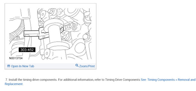

DAVE H
  • 13,384 POSTS

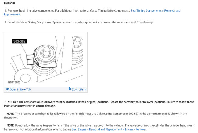

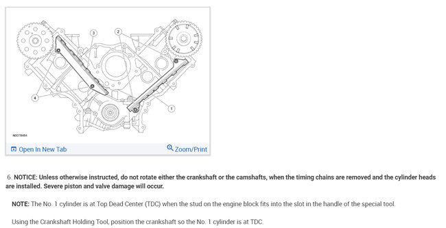

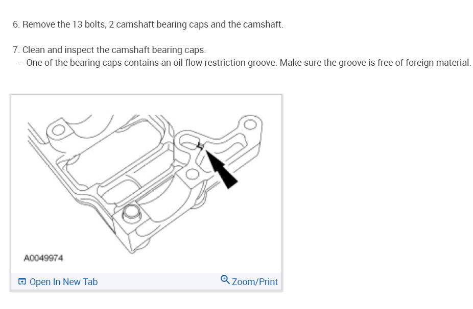

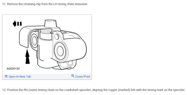

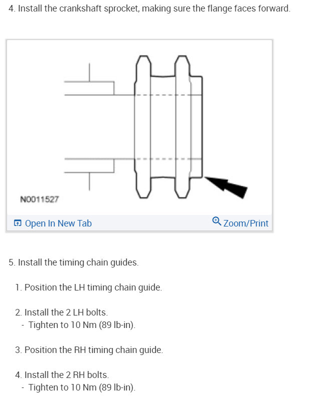

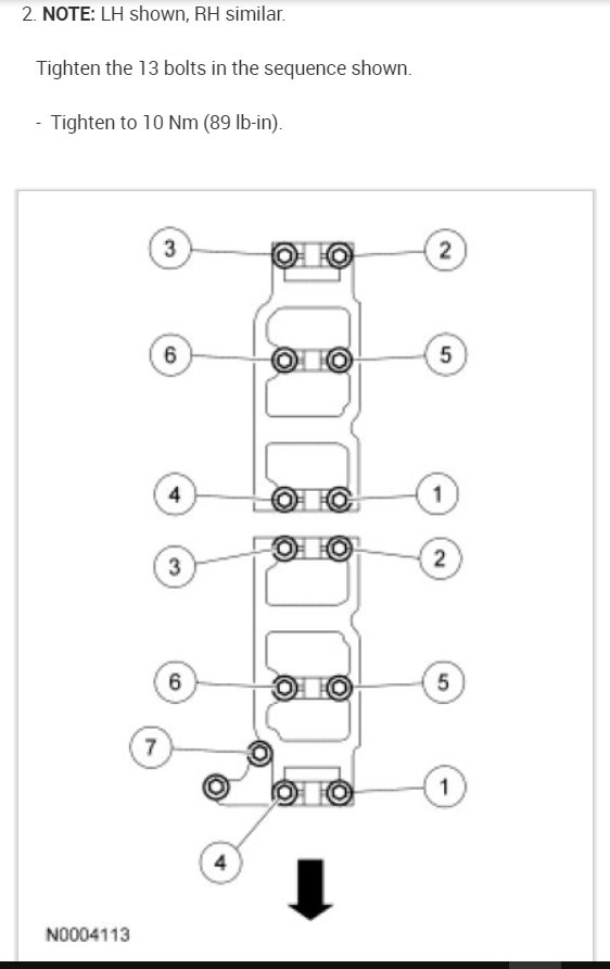

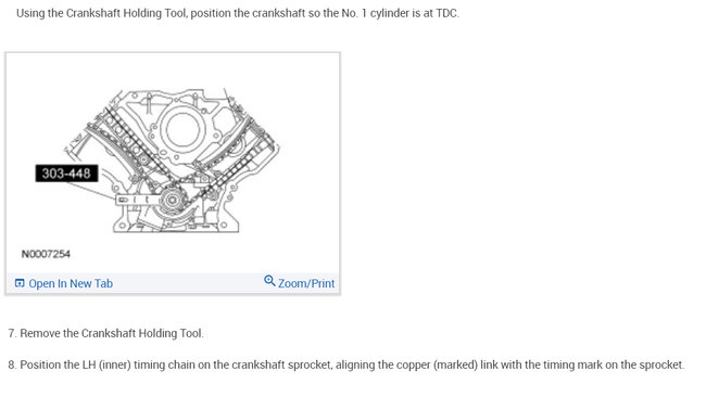

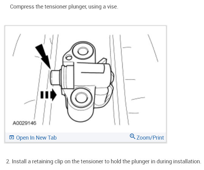

this is a complex operation and not for the novice ?? Timing Drive Components-Windsor Engine Special Tool(s) Fig. 274: Identifying Special Tools Courtesy of FORD MOTOR CO. Materials Fig. 275: Material Specifications Courtesy of FORD MOTOR CO. Removal CAUTION:Since the engine is not free-wheeling, the timing procedures must be followed exactly or piston and valve damage can occur. Remove the engine front cover. Refer to ENGINE FRONT COVER . Remove the crankshaft sensor ring from the crankshaft. Fig. 276: Removing Crankshaft Sensor Ring From Crankshaft Courtesy of FORD MOTOR CO. CAUTION:Unless otherwise instructed, at no time when the timing chains are removed and the cylinder heads are installed is the crankshaft or camshaft to be rotated. Severe piston and valve damage will occur. Fig. 277: Positioning Crankshaft Courtesy of FORD MOTOR CO. Position the crankshaft with the keyway at the 12 o'clock position. Install and fully tighten the special tools on both camshafts. Fig. 278: Installing Fully Tighten Special Tools On Both Camshafts Courtesy of FORD MOTOR CO. Remove the timing chain tensioning system from both timing chains. Remove the bolts. Remove the timing chain tensioners. Remove the timing chain tensioner arms. Fig. 279: Removing Timing Chain Tensioning System From Both Timing Chains Courtesy of FORD MOTOR CO. Fig. 280: Removing RH And LH Timing Chains And Crankshaft Sprocket Courtesy of FORD MOTOR CO. CAUTION:Unless otherwise instructed, at no time when the timing chains are removed and the cylinders heads are installed is the crankshaft or camshaft to be rotated. Severe piston and valve damage will occur. Remove the RH and LH timing chains and the crankshaft sprocket. Remove the RH timing chain from the camshaft sprocket. Remove the RH timing chain and from the crankshaft sprocket. Remove the LH timing chain from the camshaft sprocket. Remove the LH timing chain and crankshaft sprocket. Remove both timing chain guides. Remove the bolts. Remove both timing chain guides. Fig. 281: Removing Timing Chain Guides Courtesy of FORD MOTOR CO. Installation CAUTION:Timing chain procedures must be followed exactly or damage to valves and pistons will result. Fig. 282: Compressing Tensioner Plunger, Using A Vise Courtesy of FORD MOTOR CO. Compress the tensioner plunger, using a vise. Install a retaining clip on the tensioner to hold the plunger in during installation. Fig. 283: Installing Retaining Clip On Tensioner To Hold Plunger In During Installation Courtesy of FORD MOTOR CO. Remove the tensioner from the vise. If the copper links are not visible, mark two links on one end and one link on the other end, and use as timing marks. Fig. 284: Identifying Timing Marks On Timing Chain Courtesy of FORD MOTOR CO. Fig. 285: Installing Timing Chain Guides Courtesy of FORD MOTOR CO. Install the timing chain guides. CAUTION:Do not turn the engine over with the camshaft positioning tool or damage to the camshaft sprocket or the bolt can occur. Fig. 286: Installing Camshaft Positioning Tool Courtesy of FORD MOTOR CO. Fig. 287: Positioning Camshaft Courtesy of FORD MOTOR CO. Install the Camshaft Positioning Tool. NOTE:Slightly loosen the camshaft holding tools to allow slight camshaft movement. Pre-position the camshafts. Rotate the LH camshaft with the Camshaft Positioning Tool until the timing mark is approximately at 12 o'clock. Rotate the RH camshaft with the Camshaft Positioning Tool until the timing mark is approximately at 11 o'clock. Tighten the Camshaft Holding Tools to maintain camshaft pre-positioning. CAUTION:Unless otherwise instructed, at no time when the timing chains are removed and the cylinder heads are installed is the crankshaft or camshaft to be rotated. Severe piston and valve damage will occur. CAUTION:Rotate the crankshaft counterclockwise only. Do not rotate past position shown or severe piston and valve damage can occur. NOTE:The number one cylinder is at top dead center (TDC) when the stud on the engine block fits into the slot in the handle of the special tool. Fig. 288: Rotating Crankshaft Counterclockwise Courtesy of FORD MOTOR CO. Position the crankshaft so the number one cylinder is at TDC with the special tool. Remove the Crankshaft Holding Tool. Install the crankshaft sprocket, make sure the flange faces forward. Fig. 289: Identifying Direction Of Flange For Installing Crankshaft Sprocket Courtesy of FORD MOTOR CO. Position the lower end of the LH (inner) timing chain on the crankshaft sprocket, aligning the timing mark on the outer flange of the crankshaft sprocket with the single copper (marked) link on the chain. Fig. 290: Aligning Timing Mark On Outer Flange Of Crankshaft Sprocket With Single Copper (Marked) Link On Chain Courtesy of FORD MOTOR CO. NOTE:Make sure the upper half of the timing chain is below the tensioner arm dowel. NOTE:If necessary, use the Camshaft Positioning Tool to adjust the camshaft sprocket slightly to obtain timing mark alignment. Fig. 291: Positioning Timing Chain On Camshaft Sprocket With Camshaft Sprocket Timing Mark Positioned Between Copper (Marked) Chain Links Courtesy of FORD MOTOR CO. Position the timing chain on the camshaft sprocket with the camshaft sprocket timing mark positioned between the two copper (marked) chain links. NOTE:The LH timing chain tensioner arm has a bump near the dowel hole, for identification. Fig. 292: Identifying Tightening Torque Of LH Timing Chain Tensioner Bolts Courtesy of FORD MOTOR CO. Position the LH timing chain tensioner arm on the dowel pin and install the LH timing chain tensioner. Remove the retaining clip from the LH timing chain tensioner. Fig. 293: Removing Retaining Clip From LH Timing Chain Tensioner Courtesy of FORD MOTOR CO. NOTE:The lower half of the timing chain must be positioned above the tensioner arm dowel. Fig. 294: Aligning Timing Mark On Sprocket With Single Copper (Marked) Link On Timing Chain Courtesy of FORD MOTOR CO. Position the lower end of the RH (outer) timing chain on the crankshaft sprocket, aligning the timing mark on the sprocket with the single copper (marked) link on the timing chain. NOTE:If necessary, use the Camshaft Positioning Tool to adjust the camshaft sprocket slightly to obtain timing mark alignment. Fig. 295: Identifying Position Of Camshaft Sprocket Timing Mark Courtesy of FORD MOTOR CO. Position the RH timing chain on the camshaft sprocket. Make sure the camshaft sprocket timing mark is positioned between the two copper (marked) chain links. Position the RH timing chain tensioner arm on the dowel pin and install the RH timing chain tensioner. Fig. 296: Identifying Tightening Torque Of RH Timing Chain Tensioner Bolts Courtesy of FORD MOTOR CO. Remove the retaining clip from the RH timing chain tensioner. Fig. 297: Removing Retaining Clip From RH Timing Chain Tensioner Courtesy of FORD MOTOR CO. As a post-check, verify correct alignment of all timing marks. Fig. 298: Verifying Correct Alignment Of Timing Marks Courtesy of FORD MOTOR CO. Remove the special tool. Fig. 299: Removing Special Tool Courtesy of FORD MOTOR CO. Position the crankshaft sensor ring on the crankshaft. Fig. 300: Positioning Crankshaft Sensor Ring On Crankshaft Courtesy of FORD MOTOR CO. Install the engine front cover. Refer to ENGINE FRONT COVER .
https://www.2carpros.com/forum/automotive_pictures/266999_f150_1.jpg
