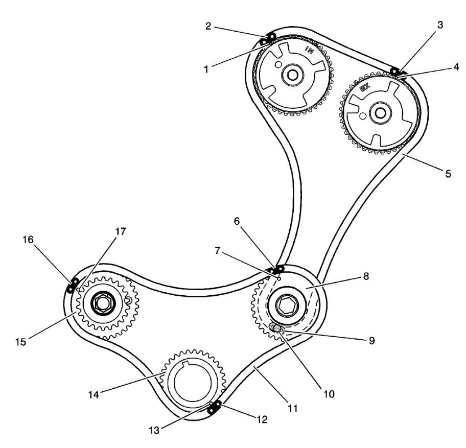

STEVE W.
  • 15,116 POSTS
These are the alignment locations for the stages. Once you have everything in place and the tensioners installed you should be able to rotate the engine clockwise as the tensioners are on the slack side.
Sep 5, 2020 at 4:28 PM

I'm on stage one now and everything is exact as the pictures.

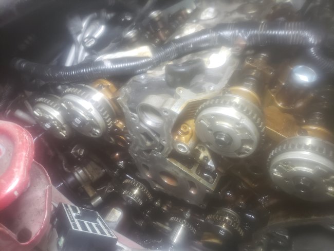

JESSESLVN1994
  • 18 POSTS
Here is what it is doing getting slack on the exhaust side guide when tensioner compresses:

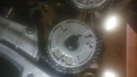

JESSESLVN1994
  • 18 POSTS
You can see how far the black guide sucks in in the very left corner when it compress.
Sep 5, 2020 at 5:33 PM
STEVE W.
  • 15,116 POSTS
That definitely isn't correct. It almost looks like the chain and sprocket are not the same pitch. Where did you get the parts from?

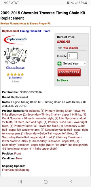

JESSESLVN1994
  • 18 POSTS
Parts geek says it's right part number, but seems to be the only thing it can be is the chains doesn't sit on the gears far enough so it jumps off.
Sep 5, 2020 at 7:37 PM
JESSESLVN1994
  • 18 POSTS
Here's the info:
Sep 5, 2020 at 7:43 PM
STEVE W.
  • 15,116 POSTS
It may be the correct part number but not the best quality parts. With the way the parts have been going it's hard to trust any of them anymore. I've seen some of the aftermarket kits replaced in under 10,000 because the parts were very poor quality. I try to only use the newer parts directly from GM on the 3.6 because they have updated them a few times. The current GM kit number is 12700436.

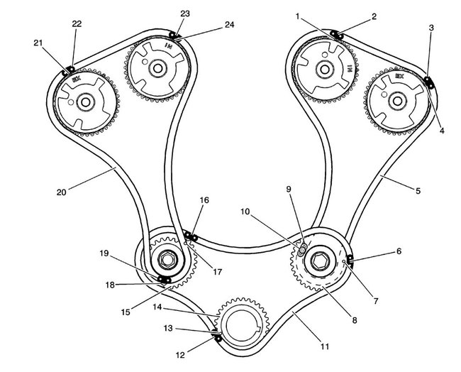

What was the reason for the repair? Timing codes, chain damage? I cannot think of anything that would really cause this issue if the parts are correct unless the tensioner is not holding as it should. When the pin was released it should have ratcheted out and locked. Then once the engine starts oil pressure acts on it and will tighten it as needed. Is it only the tensioner that is moving or are the guides flexing? Did the kit include new tensioners or are you using the old ones? If they are the old ones how did you retract them? If new you may want to take it apart and see if it is assembled correctly. It shouldn't retract easily once it extends.
Using the second image I posted above of the chains in position do they match up with this stage 2 list?
