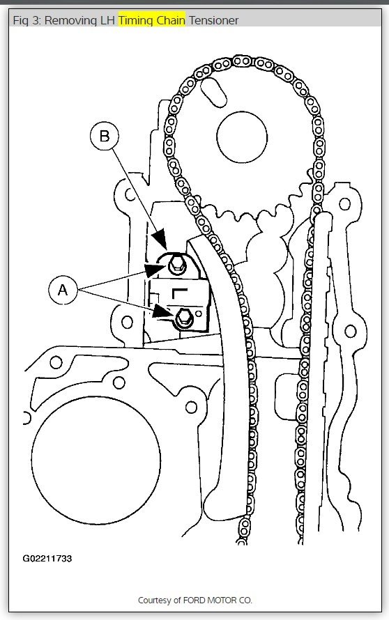

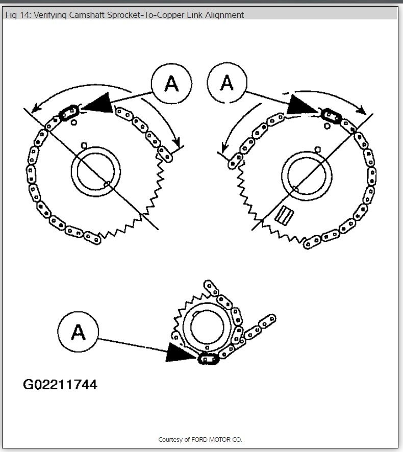

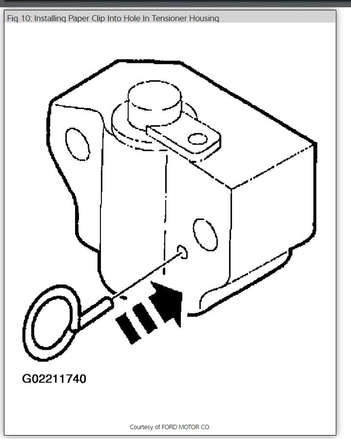

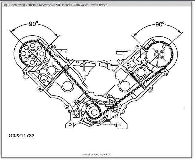

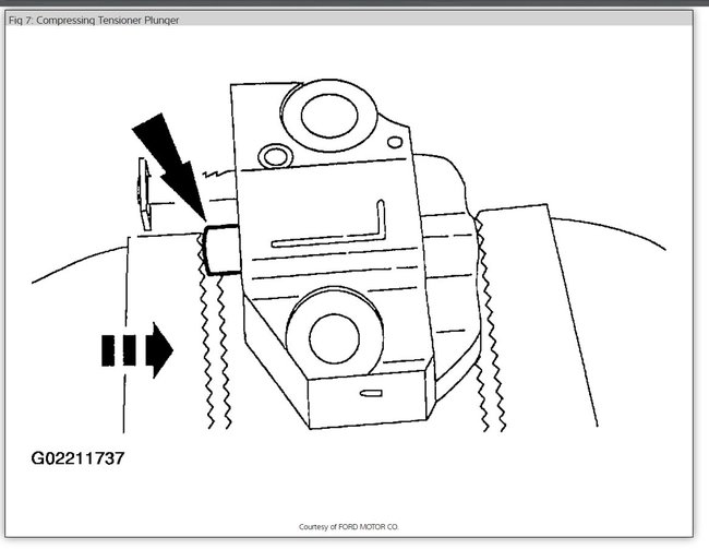

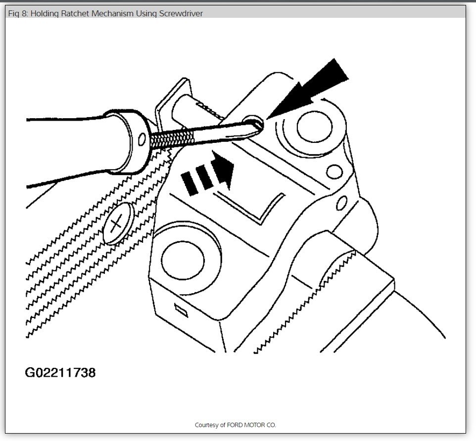

I need to know correct timing chain marks position for this engine and what tools necessary to complete tasks?
Jun 30, 2017 at 7:45 PM

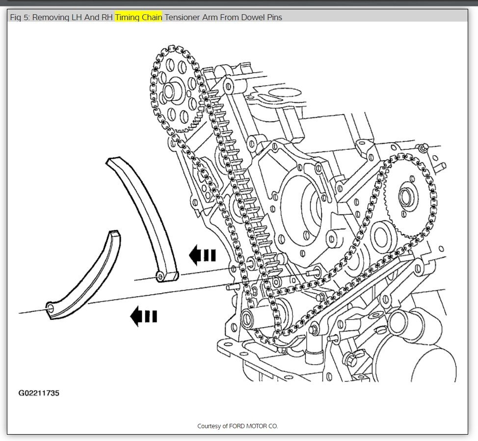

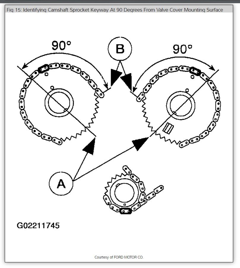

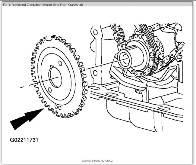

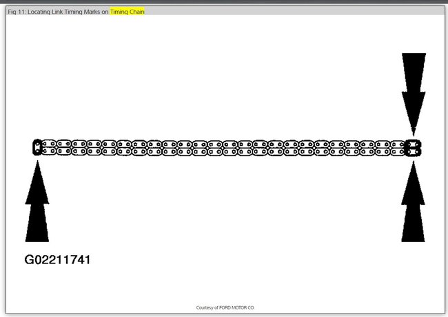

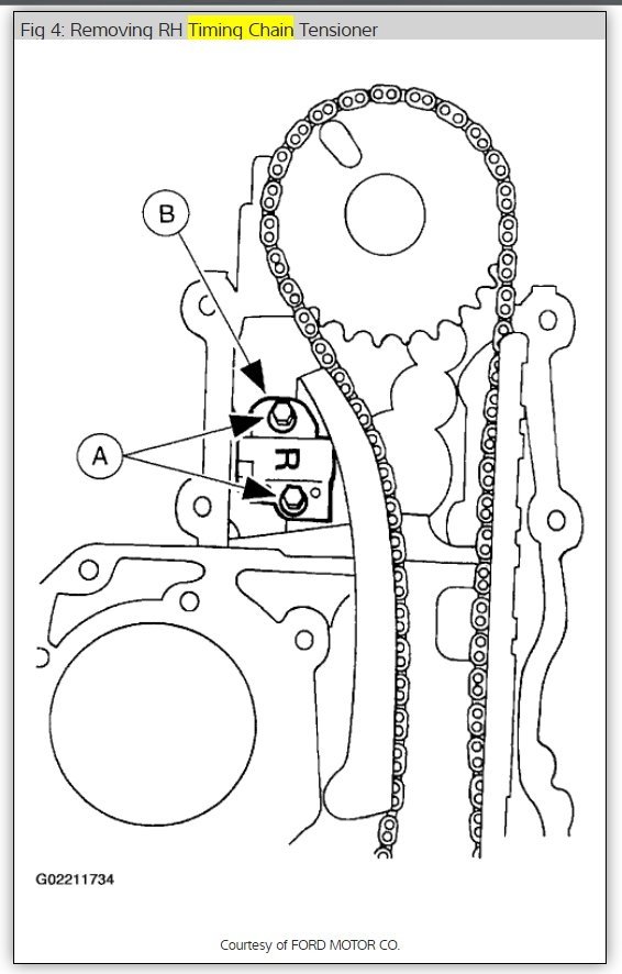

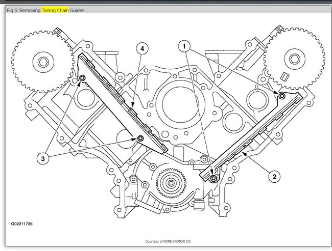

It looks like you will need a vise and a set of regular mechanics tools, here are some diagrams (below) that will help you get the job done.
