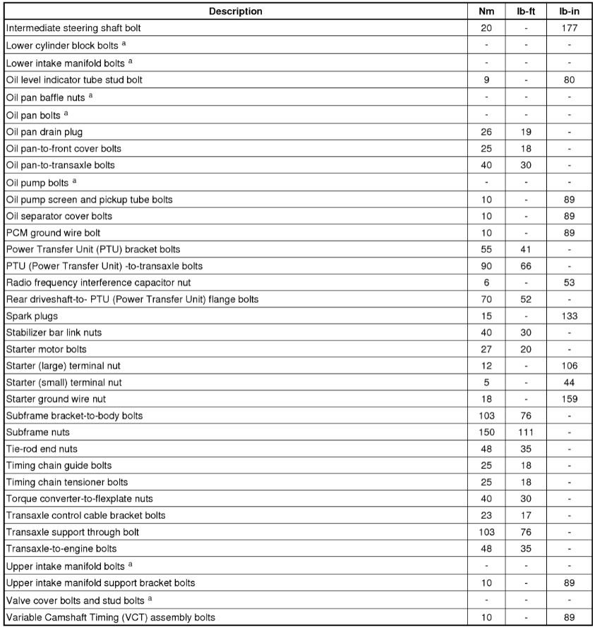

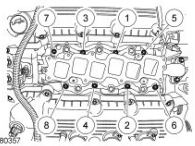

Lower intake is 89 inch pounds in two stages 40 - 89 pattern in first image.

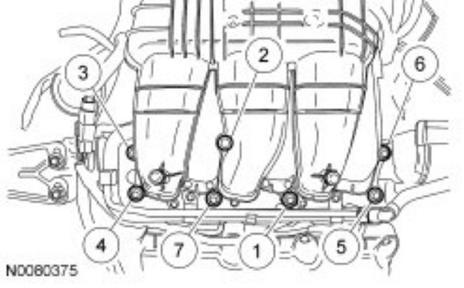

Upper is 2 stages as well, 89 inch pounds then 45 degrees pattern in second image.

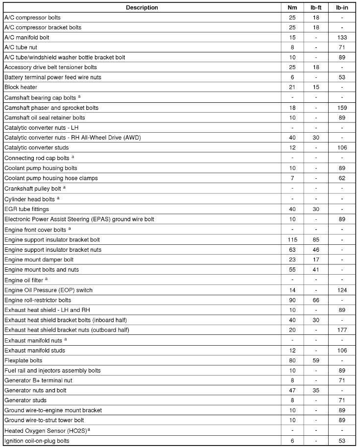

Rail and injector bolts are 89 inch pounds.
EGR tube fittings are 30 FT lbs.
