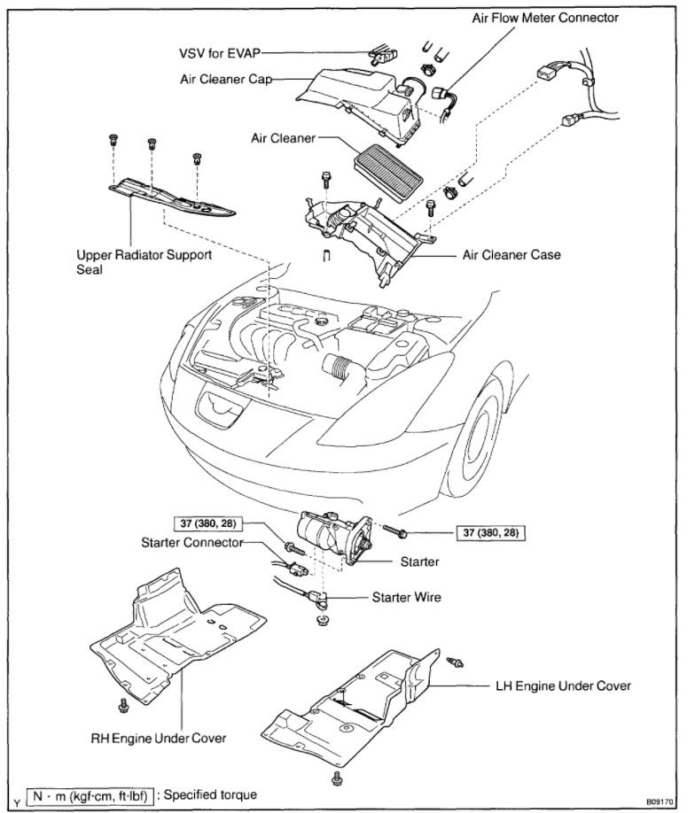

Where is the starter located and how to replace it.
Jan 16, 2009 at 4:52 PM
The starter is on the side of the engine toward the front of the car. You will need to jack the car up to change it.
and this will give you an idea on what you are in for when doing the job
Here is a diagram (below) on what its on your car.

I'm trying to change my starter and I can't find it.
Where is the starter located? or at least in what general area.
I have a 1.6L engine if that helps.

Hi pozobyt, Welcome to 2carpros and TY for the donation and selecting us as your auto repair site Feel free to ask questions at anytime and Merry Christmas and a Happy New Year 2010
At the battery positive post they'll be a black or black and red cable follow that cable towards the engine it will lead you deadon to the starter
BTW what's wrong with the starter?

Well, it's been making a loud grinding noise when I go to start my car, and sometimes the starter wont engage at all, it'll just click. when it doesn't engage, I usually just wait a few minutes and start it again, and it starts. but it still makes a loud grinding sound.

Grinding noises points to a bad starter or excessive clearance between the drive pinion and flexplate/flywheel-Investigate the flexplate for wear and tear.
