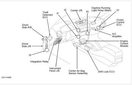

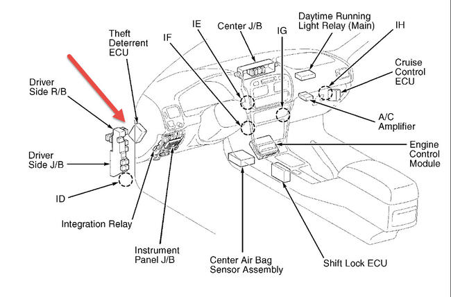

I'm trying to program a new remote for my car and i can't find the ecu. I need to late the ecu for the alarm system
Aug 9, 2020 at 12:05 PM (Merged)
HMAC300
  • 48,601 POSTS
pic shows correct ecu and a pro needs to scan this to see what is wrong with system as he will have to program it anyhow you will not be able to unless you have a pro scanner.

The first question i asked on here was where is the ecu and the person that answered said it was in the far left side of the dash. ..the second question was how do i get to the ecu and the person answered, take out the glove box. So now my third question is, what? How does taking the glove box out help me get inside the dash on the drivers side? More confused now than originally
DOCFIXIT
  • 18,828 POSTS
See Figure sorry for the miss info

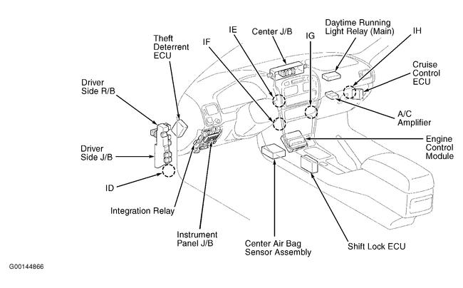

Hi, if you stay on the original post, the person your talking to will know your asking another question. If you make a new post, they won't know except by accident.
My info shows close to underneath center of dash. Note the picture, ecm. The picture came from 2carpros, poster--BMRFIXIT, several years ago. My info for removal is very basic, I'd have to look at it.

How Do i get to the ecu
KHLOW2008
  • 41,814 POSTS
Remove the golve compartment and you should be able to get to it.
KELLIRAMIREZ
  • 4 POSTS
How is that? Another person told me its on the drivers side
KHLOW2008
  • 41,814 POSTS
Sorry, it is below center of dash. See figure.
