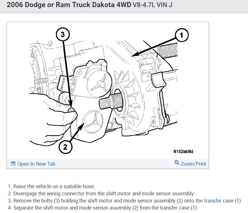

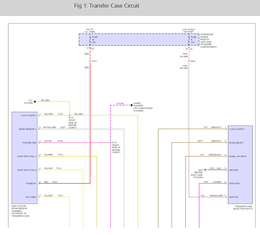

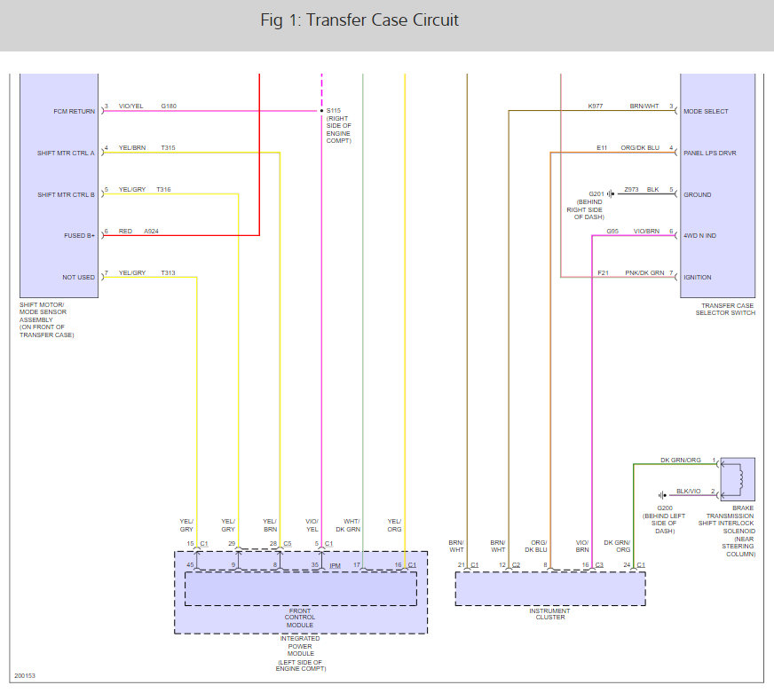

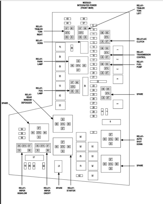

This sounds like the transfer case encoder has gone bad, but lets check the fuses #8 and #20 first. Here is a wiring diagrams for the transfer case so you can see how the system works:
