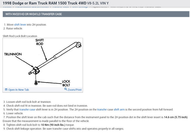

I shift the truck Into 4wd It only drives in 4 low or neutral
1998 DODGE RAM
200,000 MILES • 5.9L • V8 • 4WD • AUTOMATIC
DANIEL TERRY

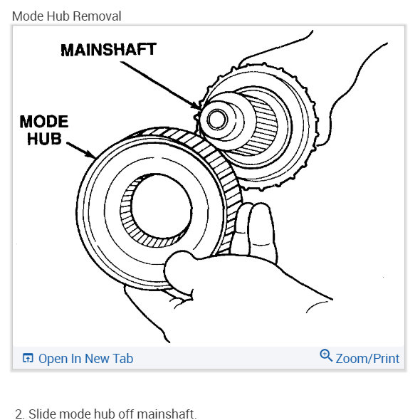

When I shift the truck Into 4wd It only drives in 4 low or neutral. It moves all the way. Not a single snag. Just normal feel to it.
Nov 8, 2018 at 11:20 AM

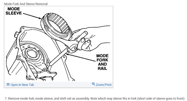

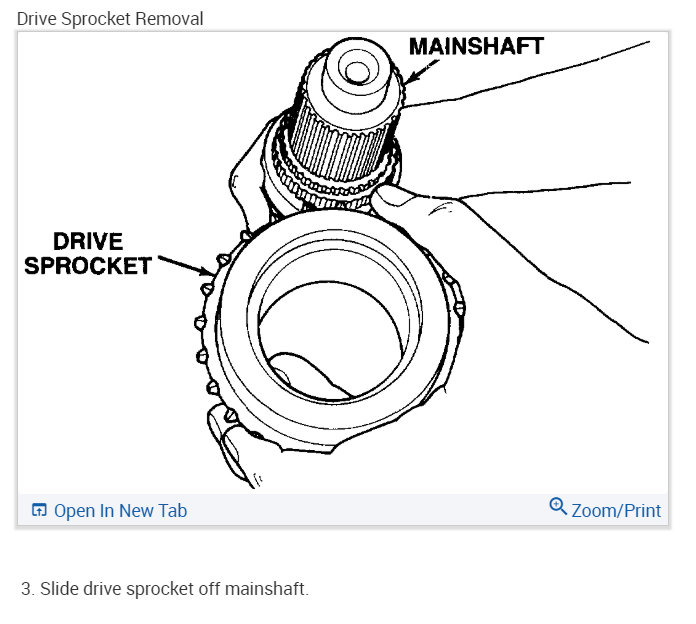

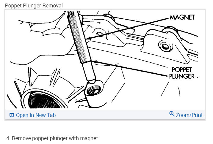

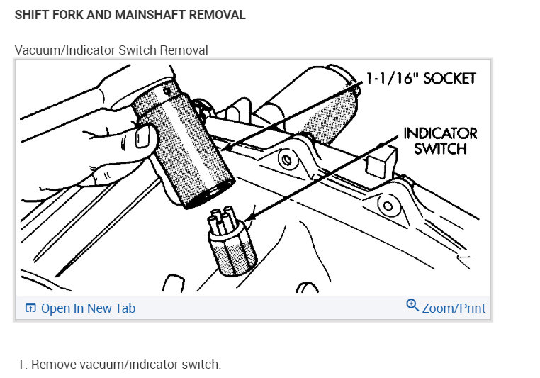

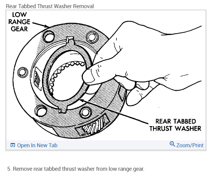

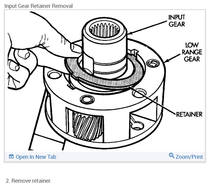

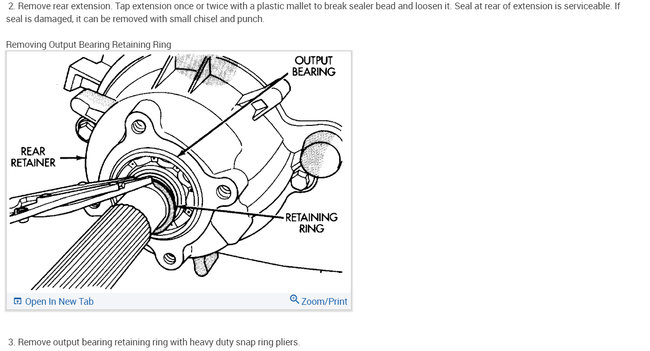

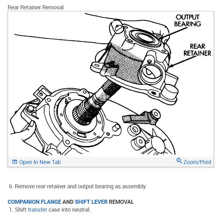

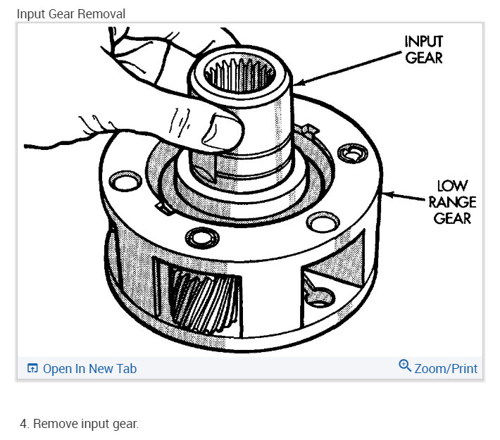

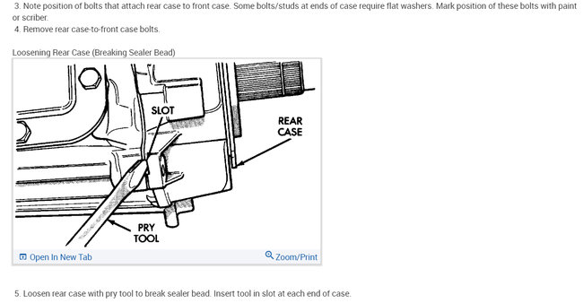

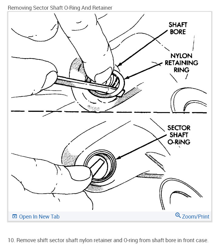

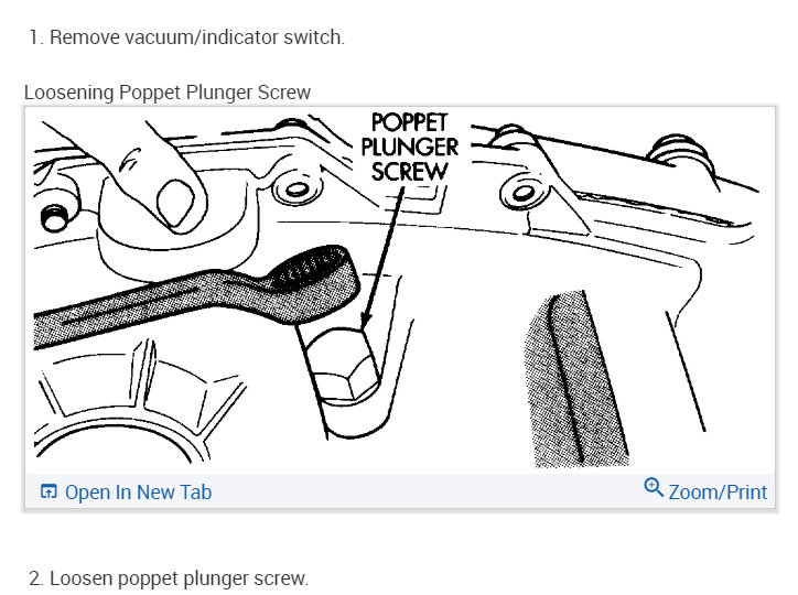

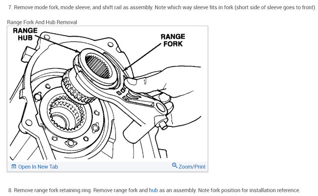

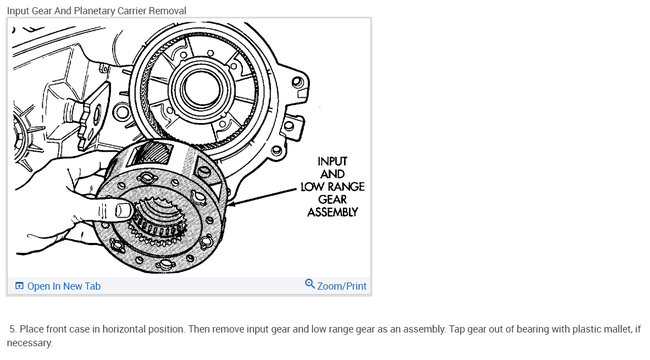

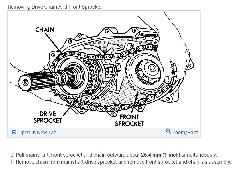

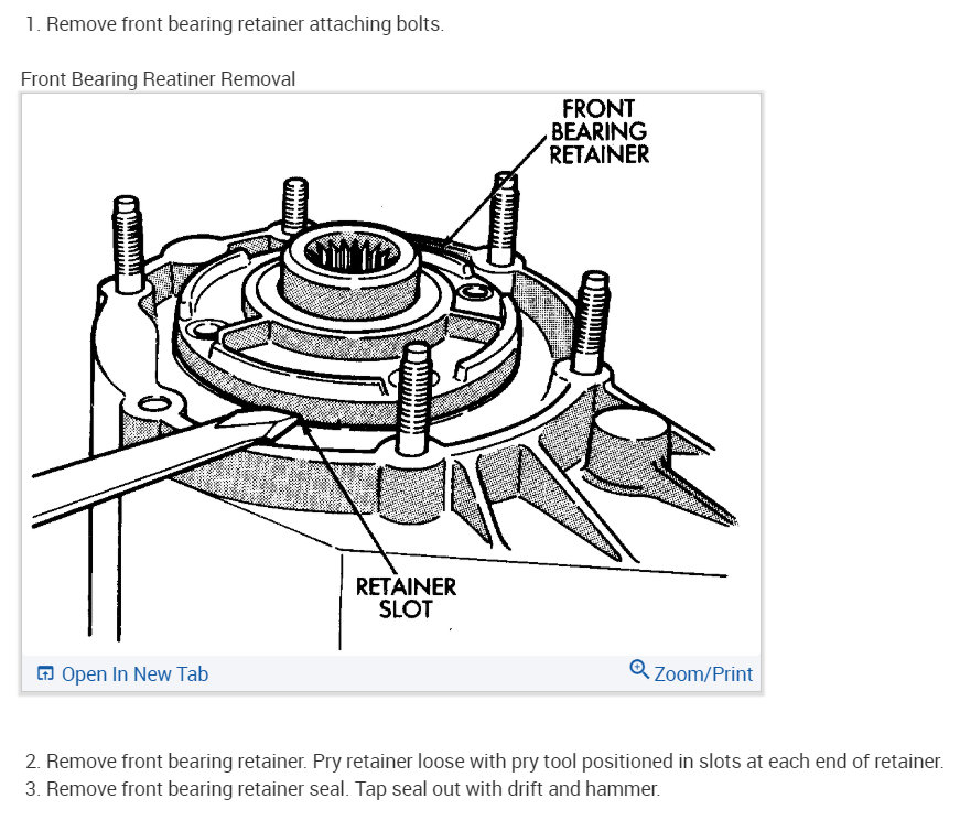

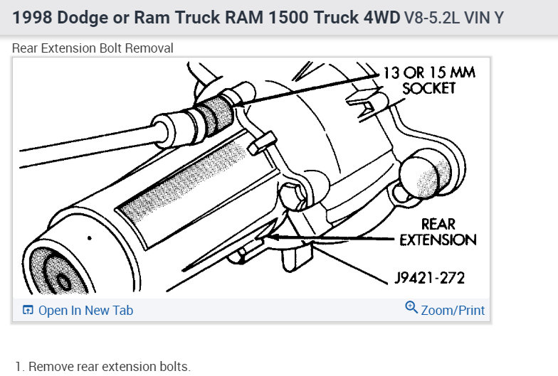

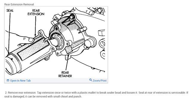

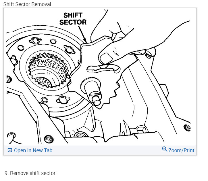

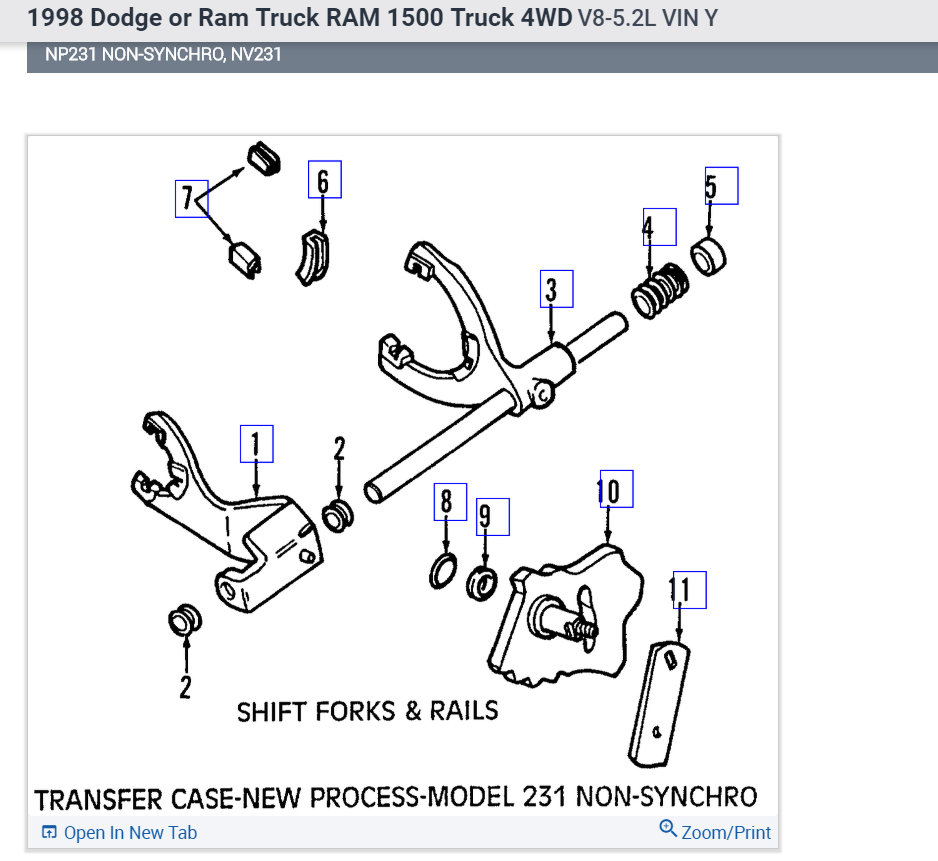

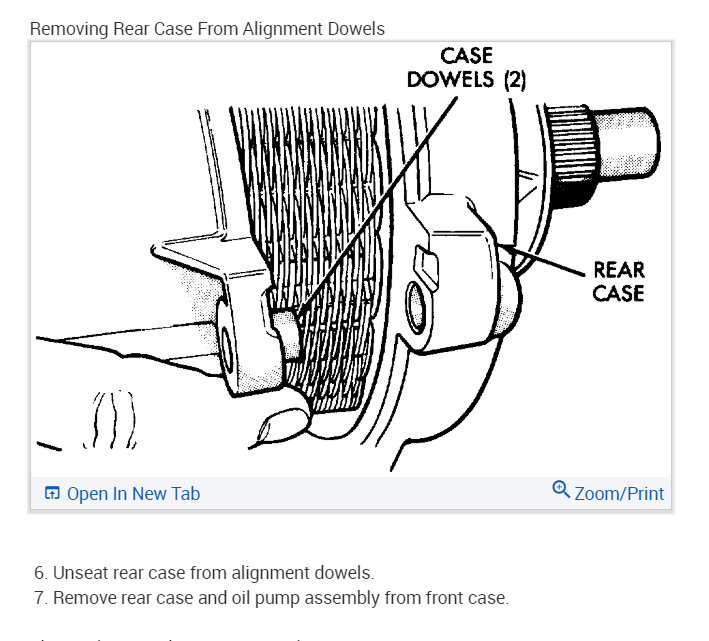

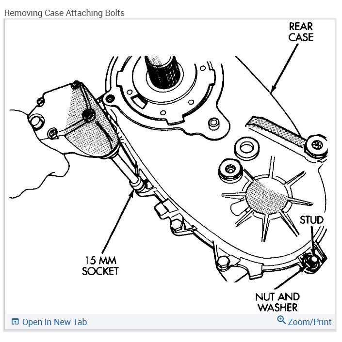

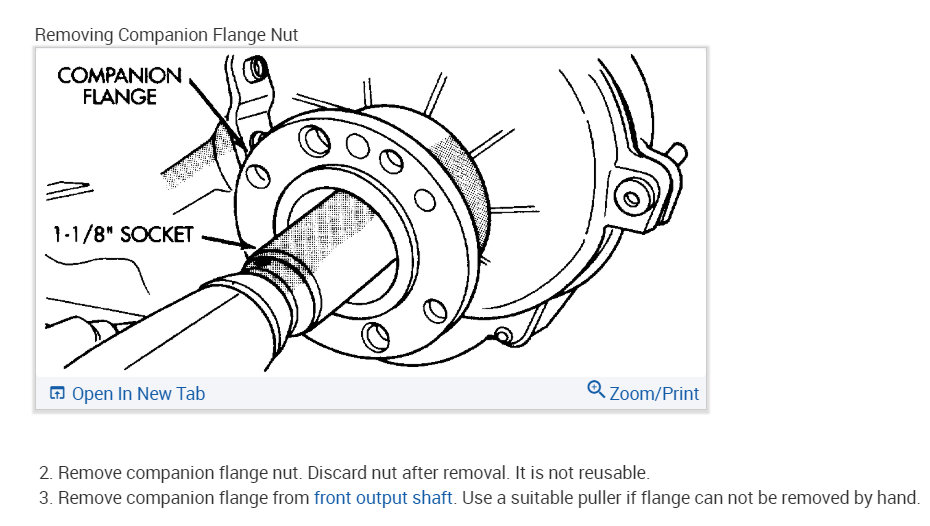

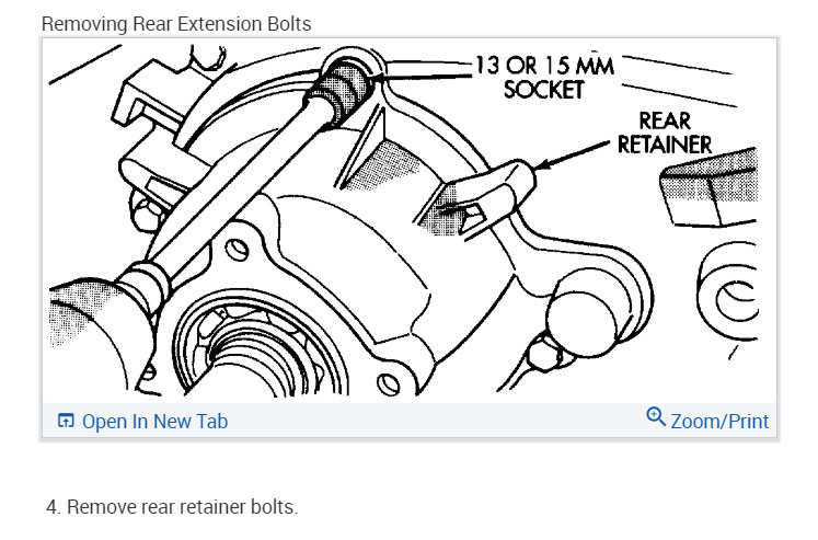

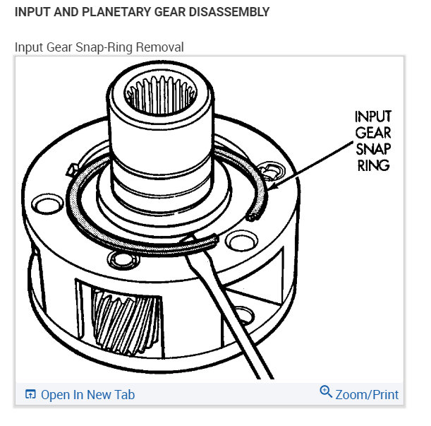

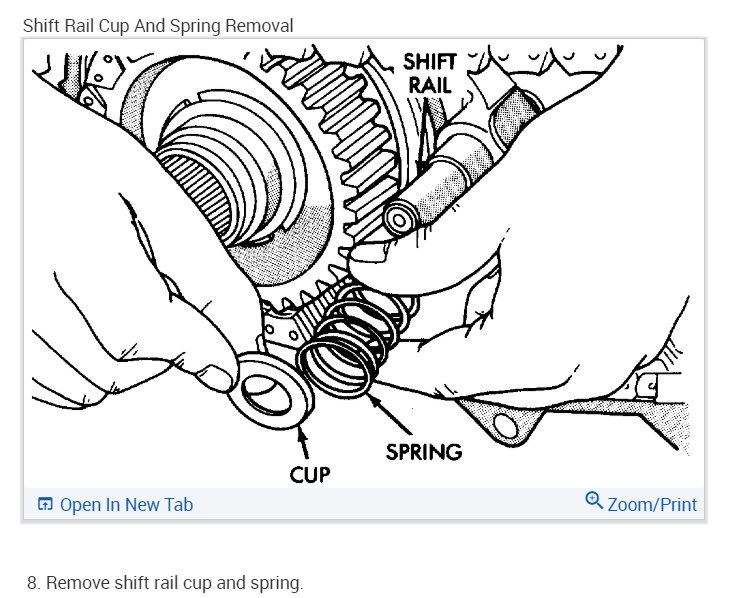

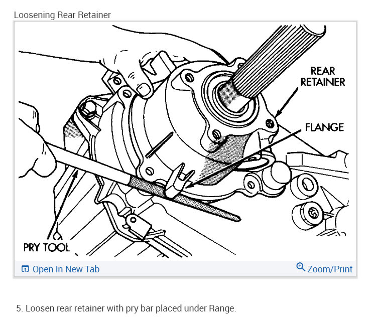

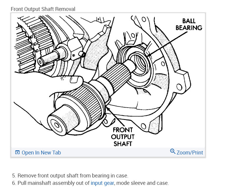

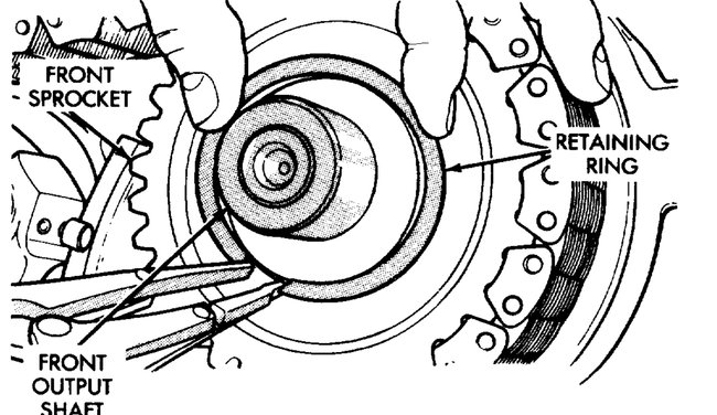

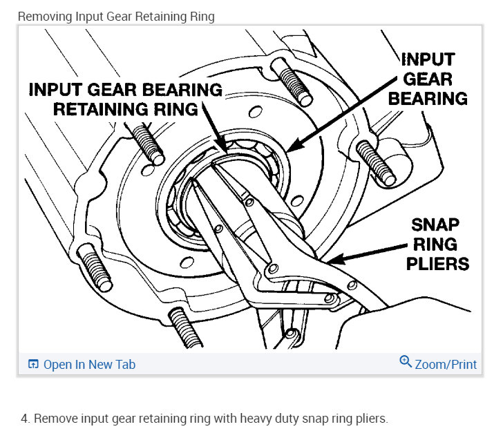

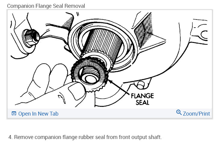

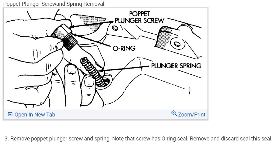

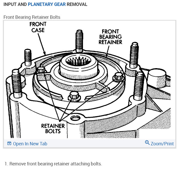

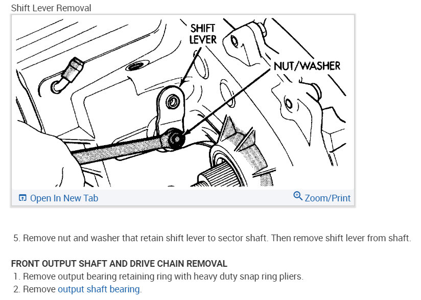

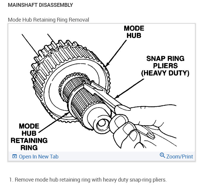

It sounds like the range fork is worn not engaging the transfer case fully. It could be a link adjustment as well. Here are diagrams and instruction to disassemble the transfer case to confirm the worn parts to fix the problem. Check out the diagrams (below). Let us know what happens and please upload pictures or videos of the problem.
