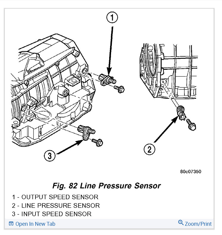

Driving down the road acts like it shifts in to neutral. Changed the shift solenoid, have 2 codes p1762 and p1757.
Jan 31, 2020 at 7:48 PM
P1762 Dodge | Governor Pressure Sensor Offset Voltage Too High or Low, it looks like the pressure sensor is not working correctly. here is the location so you can check it out/ replace it/ check the connections. Check out the diagrams (below). Please let us know what you find. We are interested to see what it is.

I replaced the shift solenoid. I'll check out the pressure sensor.
