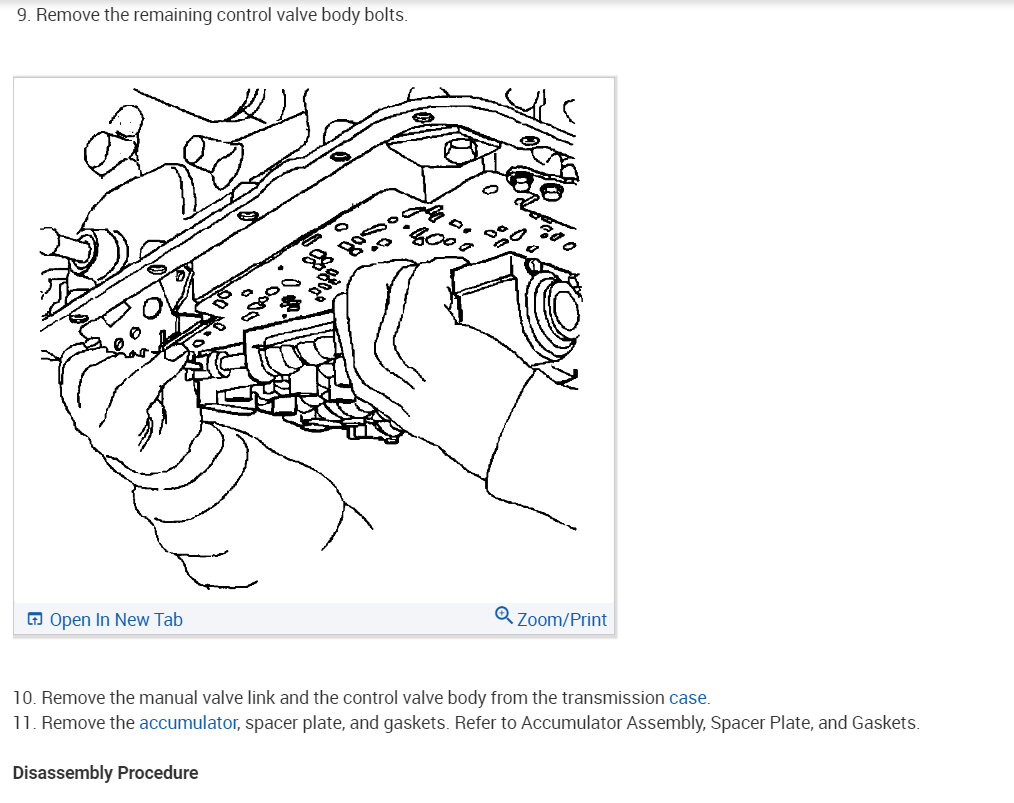

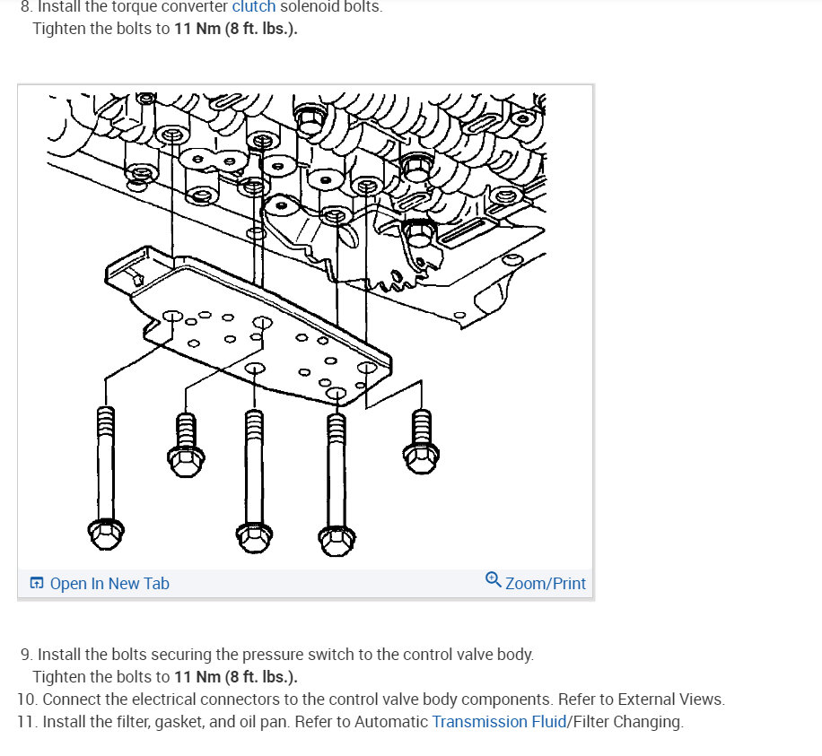

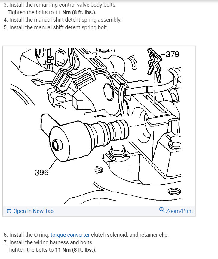

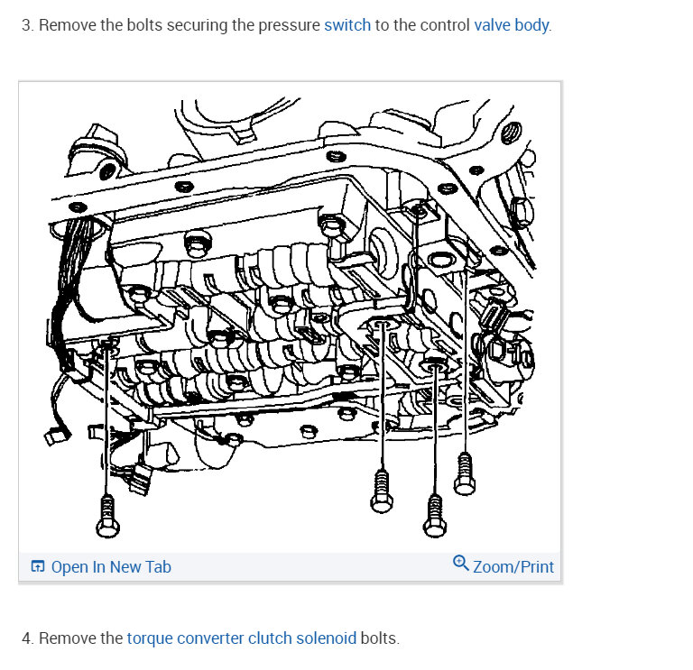

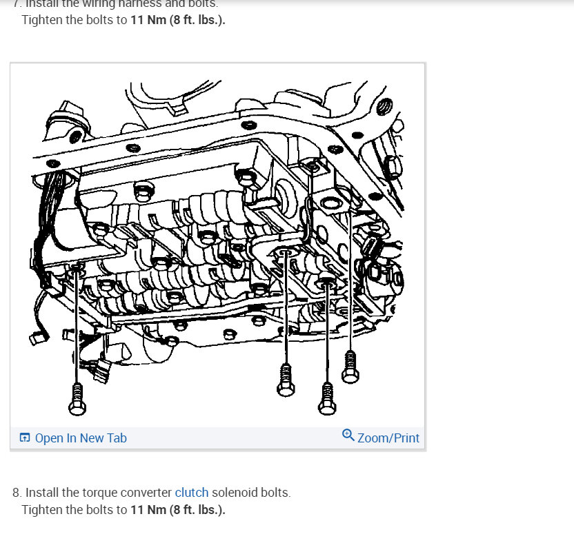

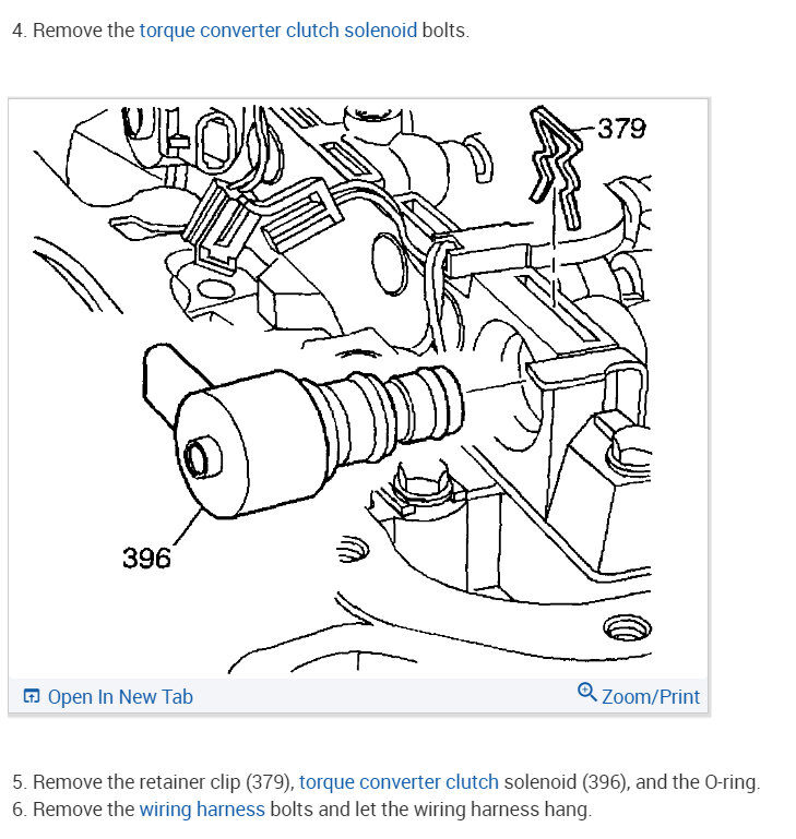

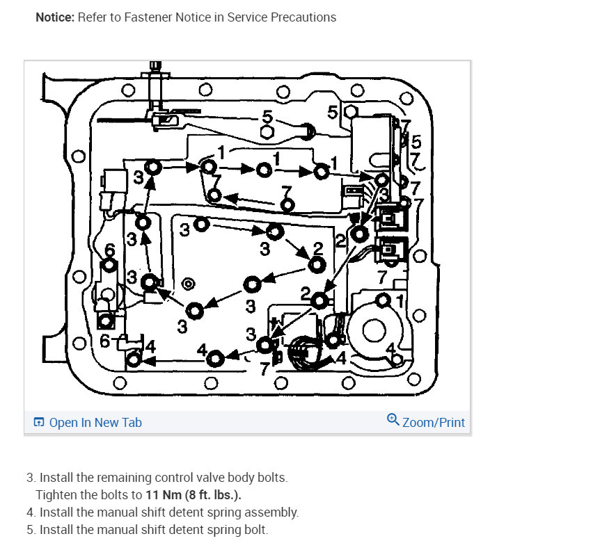

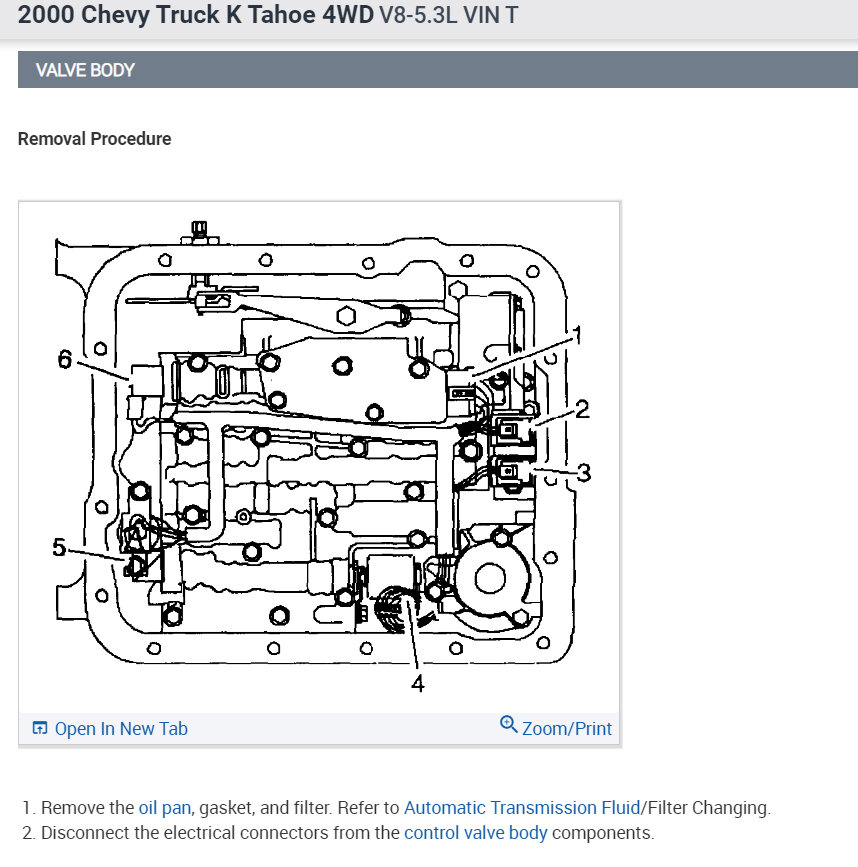

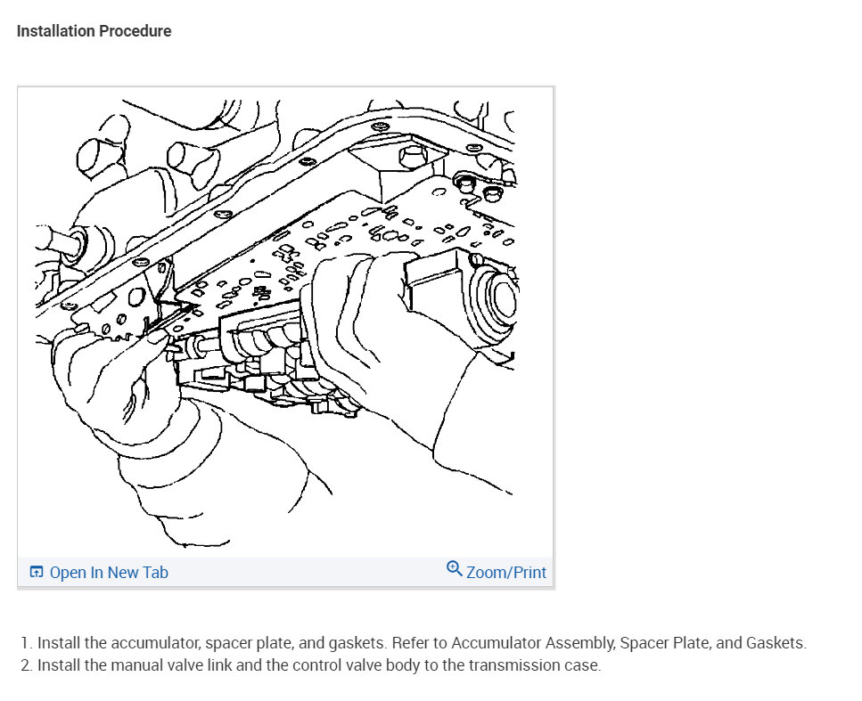

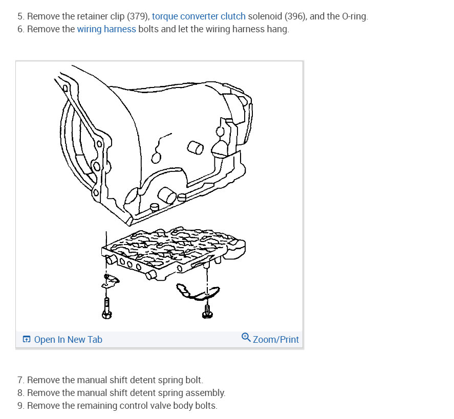

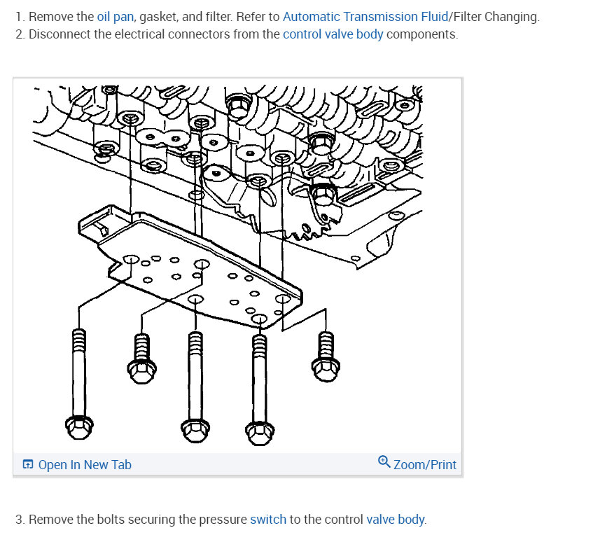

I would start by checking the electrical connector at the transmission. If that looks okay, I would install a rebuilt valve body. Check out the images (below). Please let us know what happens. Also, how is the fluid condition, is it burnt or low?

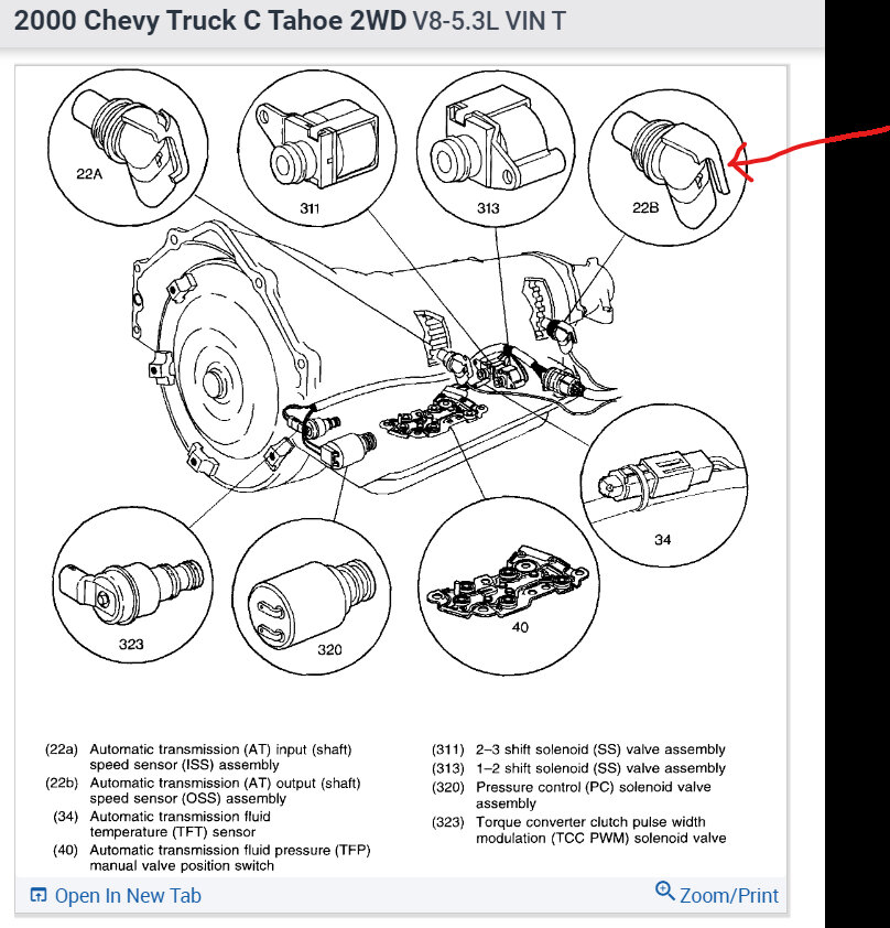

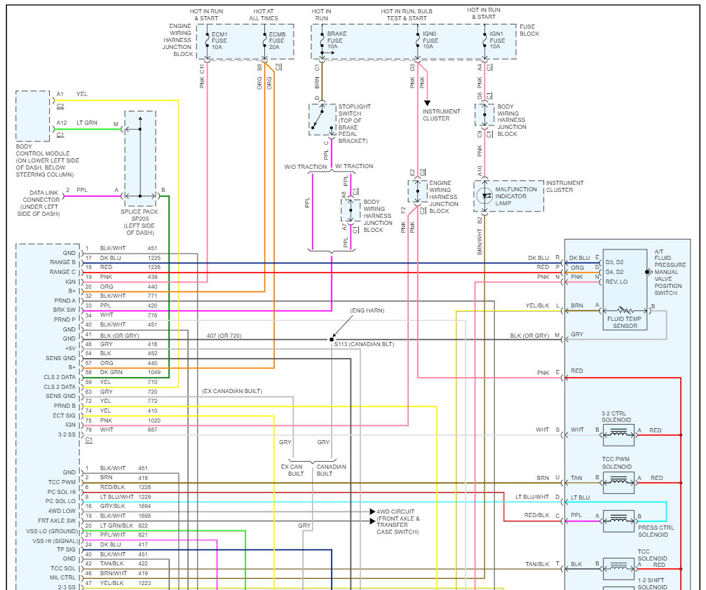

The fluid is good. I dropped the pain and checked the shift solenoids, and they were good. I cleaned everything while I was there. Changed the filter and put new fluid in. Do you think putting a new harness in would fix my problem? i have done a little research and it seems that that could possibly fix it.
Apr 28, 2023 at 6:30 AM

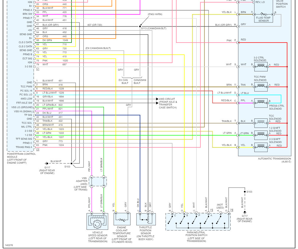

Yes, if the wiring is bad, it will cause this problem. Here is a guide to help you test the wiring with the transmission wiring diagrams below:

The valves in the valve body moved easily. So, I don't think it's that. That why I asked about harness. Thank you for the info. I will let you know how it goes.

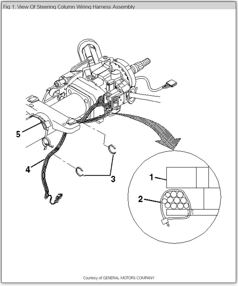

i replaced the harness in the transmission. the truck can move better. i don't have to almost floor it to move. but the codes are still there after clearing them with the scanner. also still can't feel or hear the truck shift. What would the next step be?
May 12, 2023 at 10:56 AM
I would install a rebuilt valve body, or you could have a bad PCM. How is the fluid condition?

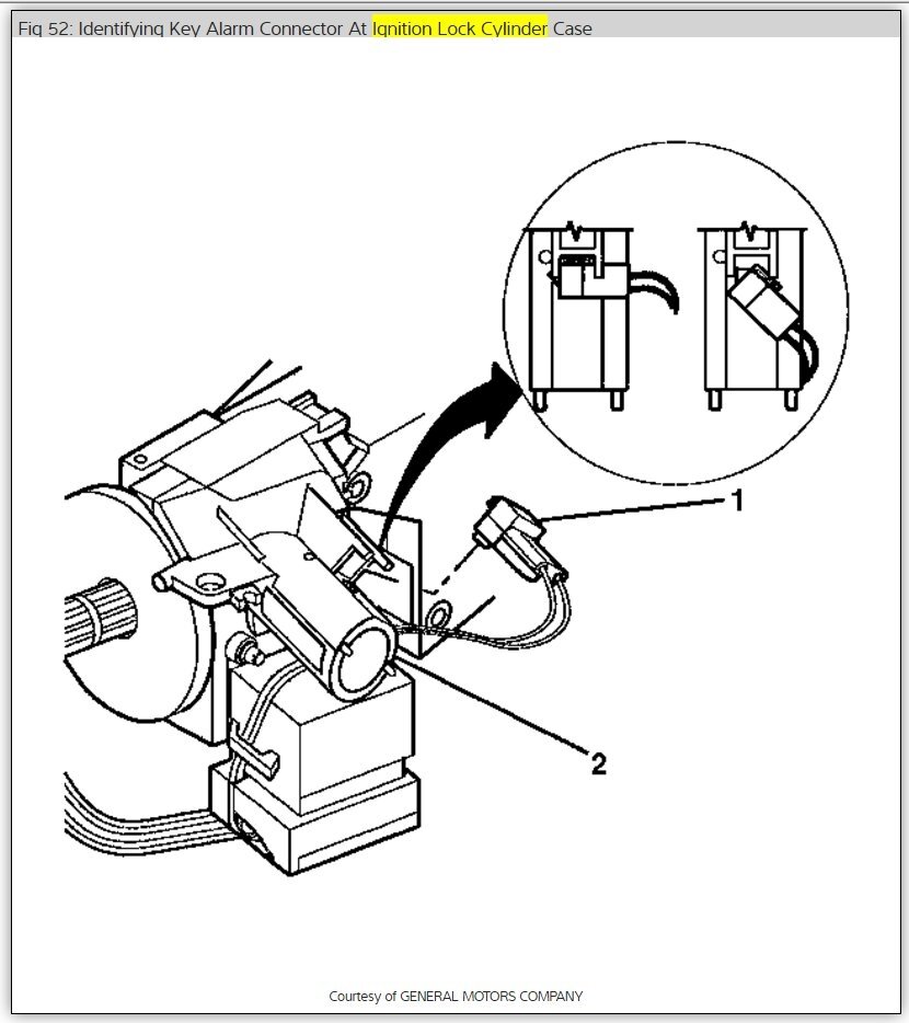

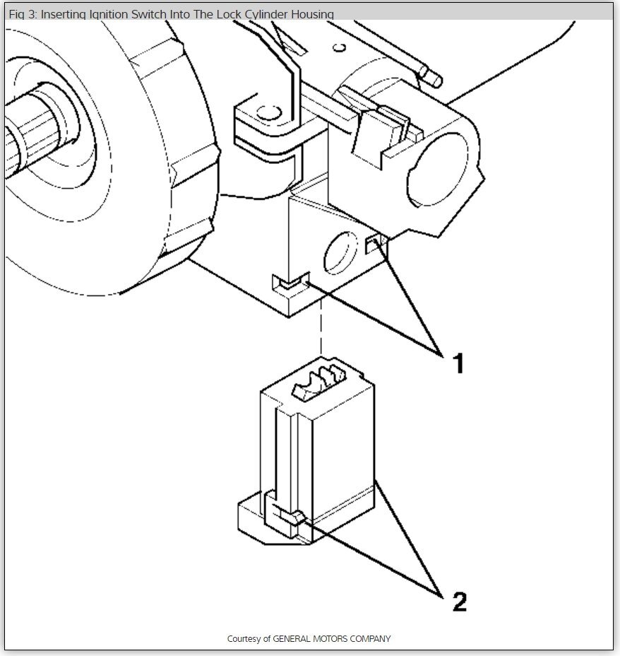

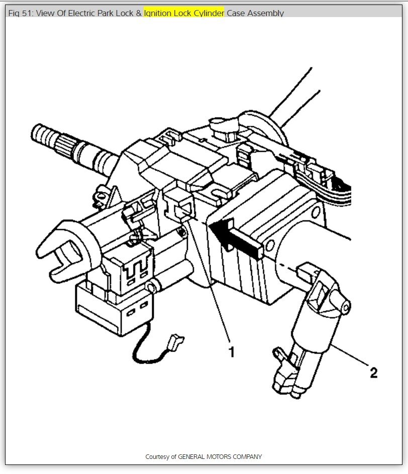

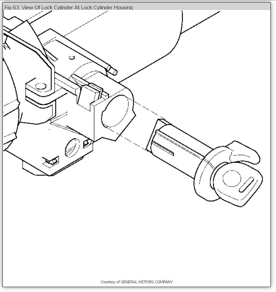

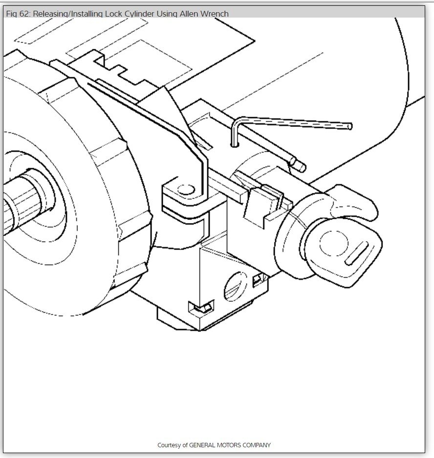

Can a bad ignition switch cause these shifting problems? My tachometer and speedometer on my cluster stopped working. And then all these problems started.
May 18, 2023 at 5:36 AM

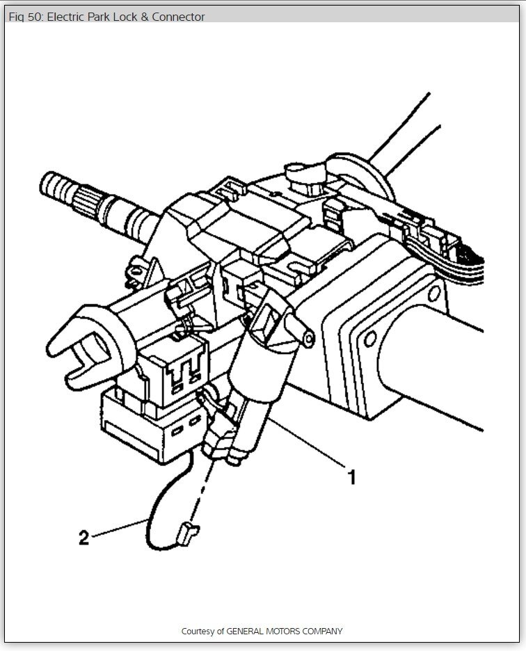

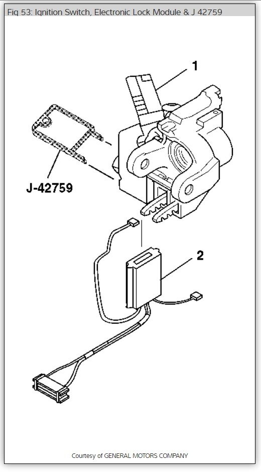

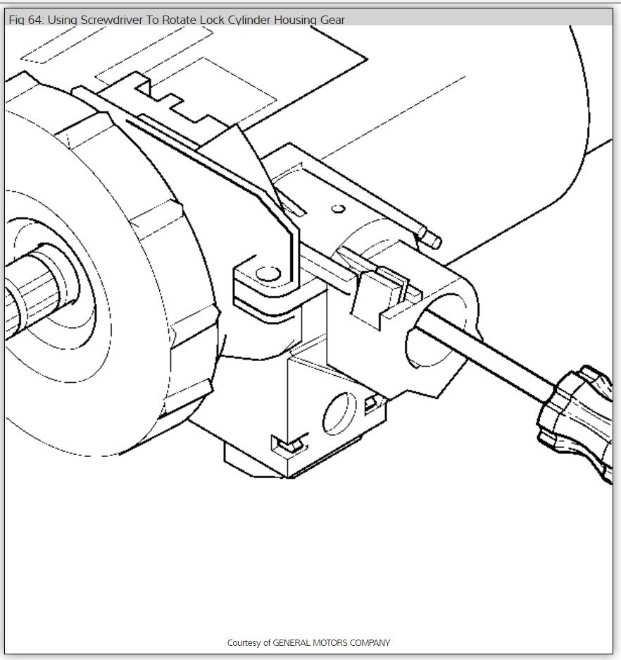

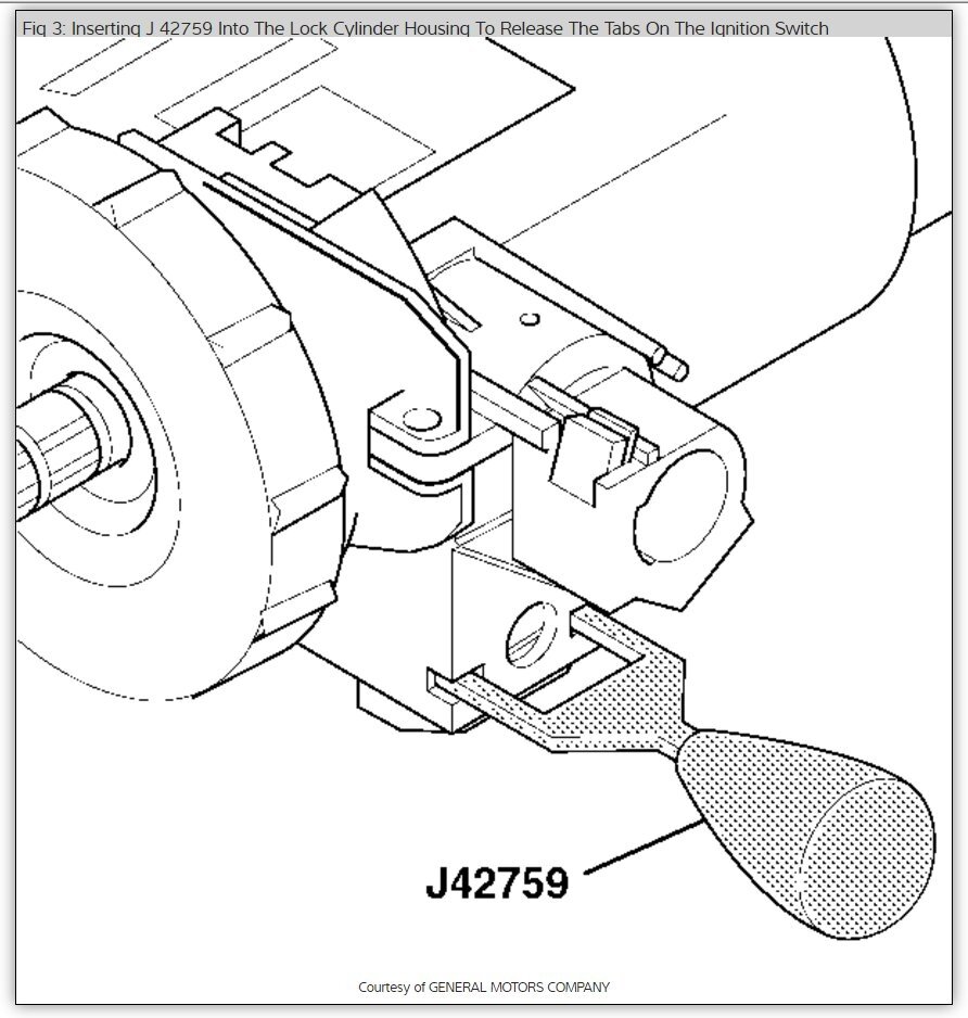

Yes, it could, here is how to change the switch out in the images below. Check out the images (below). Please let us know what happens.

Any way you could send me all wiring diagrams for my transmission?
Jun 1, 2023 at 8:41 AM
They are in the post above, click to enlarge in the images.
