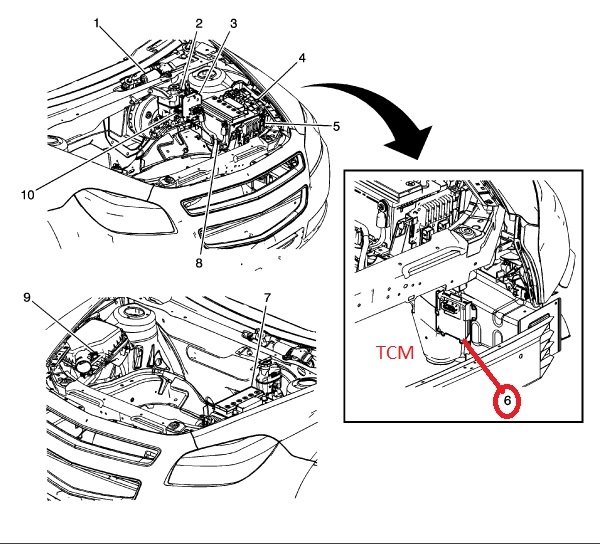

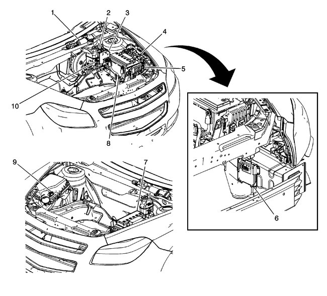

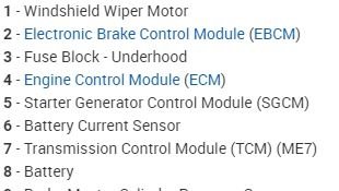

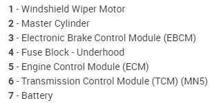

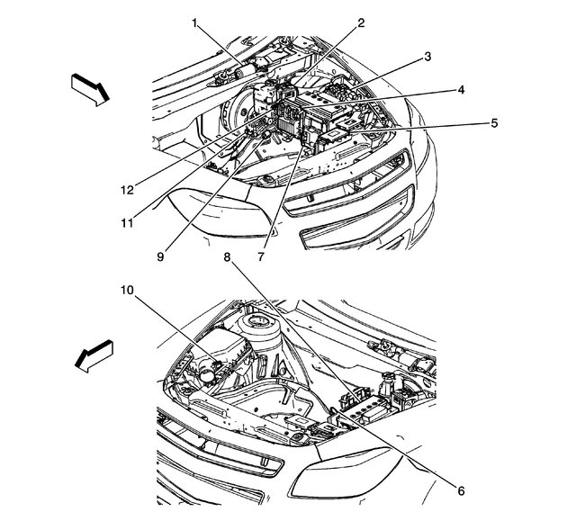

It will be in one of two locations. See the attached pictures. The legend for each picture follows the picture. In picture 1, locate component 7. In picture 2, locate component 6.
Let me know if this helps. Let me know if you have other questions.
Sep 7, 2020 at 1:13 PM (Merged)
OLEY33
Not there in any spot.

Hi again,

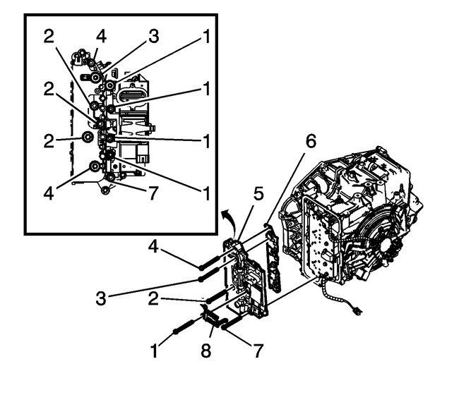

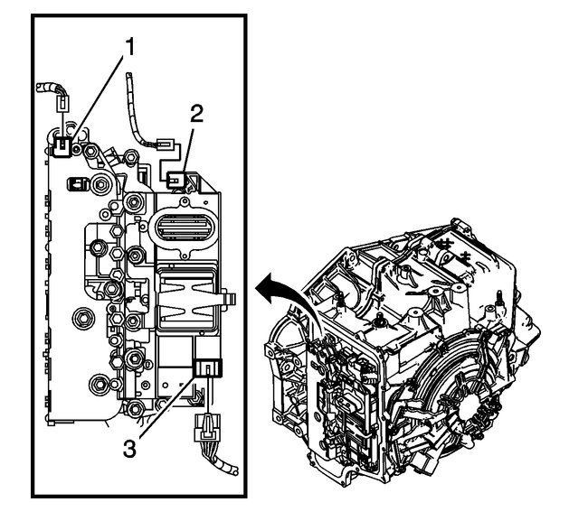

The pictures I supplied indicate the only two places they were placed. If the vehicle is a hybrid, that changes things. It will be mounted on the side of the transmission. Here are directions and pictures for removing it:
Control Solenoid Valve and Transmission Control Module Assembly Replacement
Removal Procedure
1. Remove the control valve body cover. Refer to Control Valve Body Cover Replacement (See: Valve Body, A/T > Removal and Replacement > Control Valve Body Cover Replacement).
2. Disconnect the input speed sensor electrical connector (1).
3. Disconnect the output speed sensor electrical connector (2).
4. Disconnect the shift position switch electrical connector (3).
5. Remove the 4 control valve body bolts (1) M6 x 80.
6. Position the control solenoid valve spring (8) to the side. Spring will be released with the removal of the control valve body assembly.
7. Remove the 2 control valve body bolts (4) M6 x 65.
8. Remove the control valve body bolt (3) M6 x 42.
9. Remove the 3 control valve body bolts (2) M6 x 95.
10. Remove the control valve body bolt (7) M6 x 55.
11. Remove the control solenoid valve body and transmission control module (TCM) assembly (5).

CJ MEDEVAC
  • 11,004 POSTS
Here you go! Check out the diagrams (Below). Please let us know if you need anything else to get the problem fixed. The Medic

HMAC300
  • 48,601 POSTS
left rear of engine compartment near strut tower. this may not be the problem if yo are having a trans problem.
